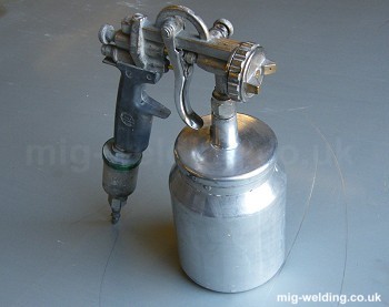

A reasonable quality spray gun makes it much easier to achieve a flat finish without drips.
I started spraying with a spray gun that came in a pack of air tools for £20. It didn't seem to atomise very well so paint tended to go on thickly with orange peel. That was my first spray gun and it was years before I realised that others could be so much better.
I'd avoid second hand guns completely - there is too much that can go wrong with them. A good paint shop should be able to supply a reasonable gun for around £60, and will be able to match the nozzle size to the type of paint you want to spray. I'm naughty and use a 1.4mm nozzle for everything.
Others on the forum have upgraded from my level of gun to something like a Devilbiss JGA, and report that it becomes even easier to achieve a excellent straight from the gun. Buy the best spray gun you can afford.

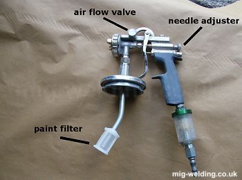

Always use a paint filter on the pick up tube. You'll have bits of hard paint from the edge of the tin fall into the pot, and these would end up as splats on the panel if they were not filtered out. The paint filter can be left in place and is washed in the gun washing process. It lasts for a long time.
The angle of the pickup tube can be altered by loosening the nut at the top. Here it's set forwards to pick up the last of the paint when painting the top surface of a panel. For painting underneath a vehicle I'd turn it the other way around so save having to refill the pot while it's still half full. It can only sensibly be adjusted on a clean gun rather than in mid paint.

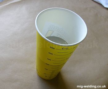

Accurately mixing paint is critical to success. A dip stick is surprisingly inaccurate, but disposable mixing cups work well.
Most DIY sprayers will simply mix the paint to the manufacturer's recommended ratio. The paint shop will be able to advise the appropriate ratios for the paint. Disposable mixing cups can help maintain a reasonable level of accuracy.

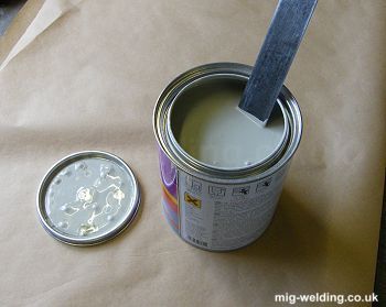

A screwdriver is not an effective tool for paint stirring. Professional paint shops will shake the paint or use a whisk. My preference is to use a 12 inch steel rule.
Paint tends to sit around for a long time on the paint suppliers shelves so has plenty of time to settle. The steel rule can be used to drag the sludge from the bottom and mix it with the paint at the top to give the paint the composition the manufacturers intended.
Mixing the paint in a separate container (such as a mixing cup) then pouring it into the spray gun cup (and then mixing again) will tend to result in a reasonable mix. Mixing directly in the spray gun cup could cause problems with thick poorly mixed paint remaining at the bottom.

The needle adjuster (trigger stop) can normally be left at full trigger travel for normal panel work, but if the paint application is too heavy (perhaps when spraying small parts) the paint flow can be reduced with the needle adjuster. This will need to be balanced by further adjustment of the air flow valve.

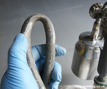

A painting trick from the forum is to reduce air pressure for fiddly areas such as the window frame in the video by kinking the air line to the gun with your spare hand. Kinking reduces the air pressure making it possible to save paint by directing the fan along the panel rather than at right angles.
