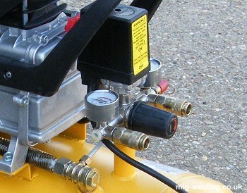

DIY compressors normally have regulators mounted directly on the air tank and do not make any real attempt to remove water or oil from the air supply.
Air is heated when it is compressed and carries more water than cold air at the same pressure. As the air passes through the outlet of the tank or is decompressed in a regulator it cools. This causes excess water to separate, so the output from a DIY compressor will be a combination of air and water droplets.

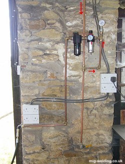

Don't worry, there's a simpler system further down the page. But first a schematic of my system to help you see what's going on in later photos. It's more complex than you might need as it's purpose is to move air from one building to another.
My system is very much designed to fit the building. The main points are:
copper piping to cool the air and separate out water
drop legs with drains to release the water from the system
A filter regulator to remove remaining water.

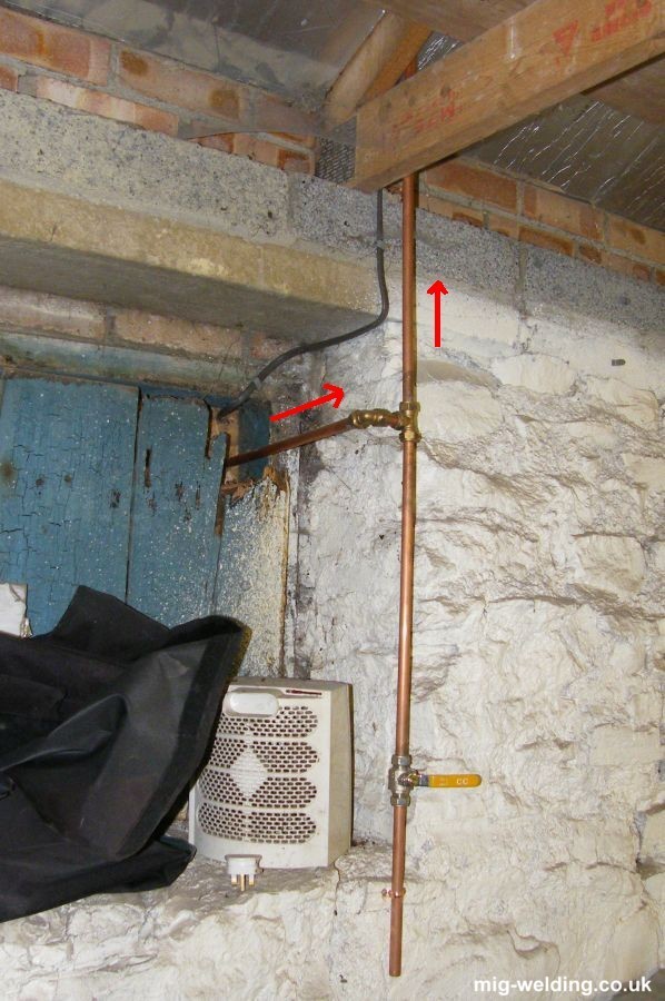

Drop legs
Air stored in an air compressor tank is hot. It can be cooled to some extent by passing it along a copper pipe and this separates some of the water from the air. Horizontal piping should be angled downwards in the direction of flow so that water droplets are pushed along with the air rather than backing up in the pipe. A slope of 1 in 100 is the minimum generally recommended, but the steeper the better.
Every few meters or whenever the height of the pipe has to be increased a riser and drop leg can be added (as in the photo). Water will tend to run into the drop leg and can be released from the system using a ball valve at the bottom of the drop leg.
A long pipe system for the sake of it would probably be less effective than a cheap in-line water trap, though a small system to bring compressed air to a regulator mounted on a nearby wall would benefit greatly from one of these drop legs.

Watch you don't mount electrical sockets near the water drains. Can you spot the bad practice in this photo? The drains now have rubber hoses attached.

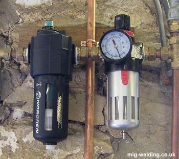

Filters and regulators
The device with the gauge is a filter regulator and it's fitted in the air supply before the oil and particle filter. The bowl in the regulator will remove further water from the air supply, and will reduce the pressure of the air. Also the regulator does a little initial filtering to reduce the rate of blockage of the coalescent oil filter.
The oil filter is necessary as a compressor will add small amounts of oil into the air through it's cylinder lubrication. These wouldn't be good mixed in with paint.
A system that's in use all of the time will block it's filters quickly. So filters tend to be protected by another filter or two of increasing particulate size. Norgren (filter manufactures) publish an informative pdf regarding filter choice for various applications.

The standard regulators on DIY compressors can be restrictive, so performance of the compressor could be improved by using a 1/2 inch regulator.
