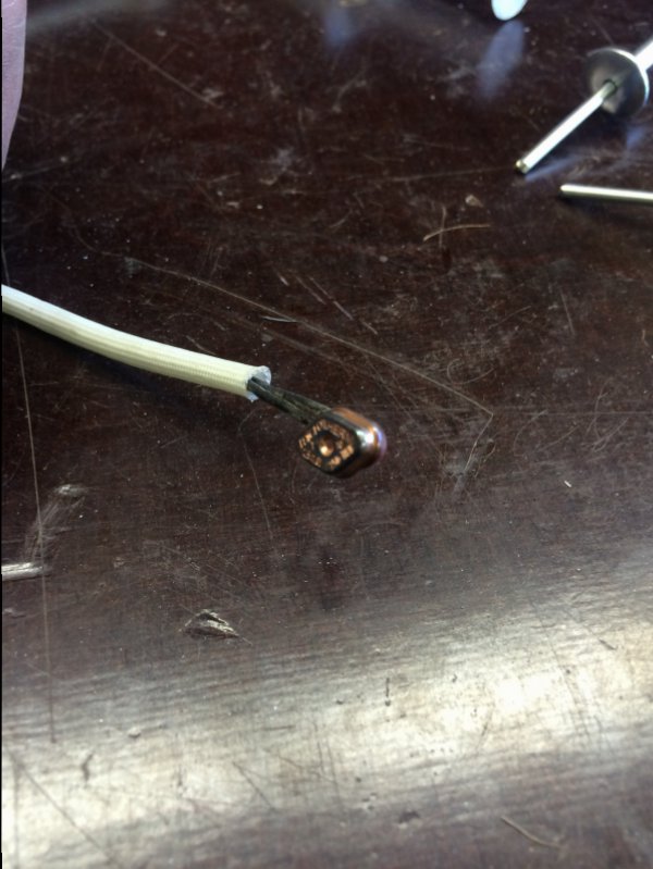

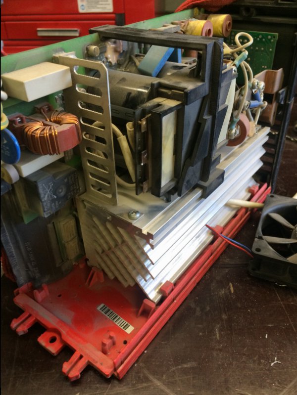

Had a little Eutectic Pwoermax 140 (Fronius Transpocket 1400 in drag) with overheating issues. Customer normally runs 3.25mm 6013s for hours on end without issue, then his machine started overheating and shutting down after a handful of rods.
Turns out the little temperature switch that tells the fan to cut in/out had failed leaving the set without a fan.

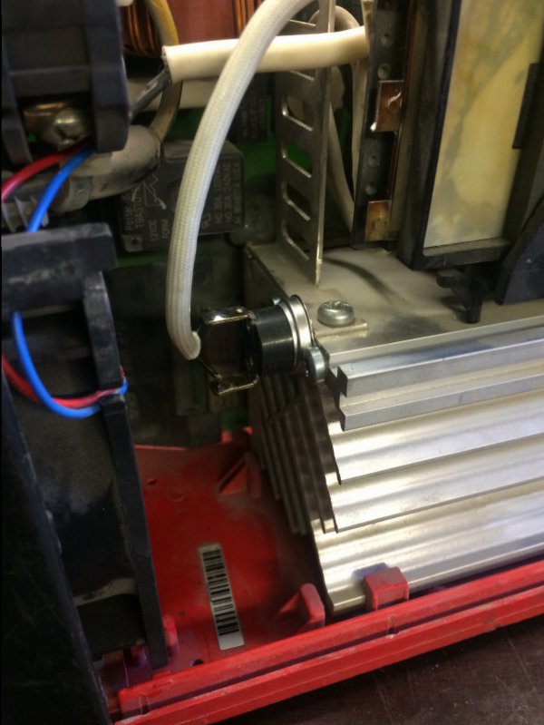

Removed the old swich, solder on a new one, drill out some mounting holes to screw mount the temp switch to the heatsink, weld test, PAT test, onto the next one. Great little machine, I think it's roughly over half as old as I am its doing alright!
Old dead temp switch
New one, with a bit of heatsink compound on the back.
In, job jobbed.
