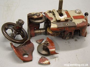

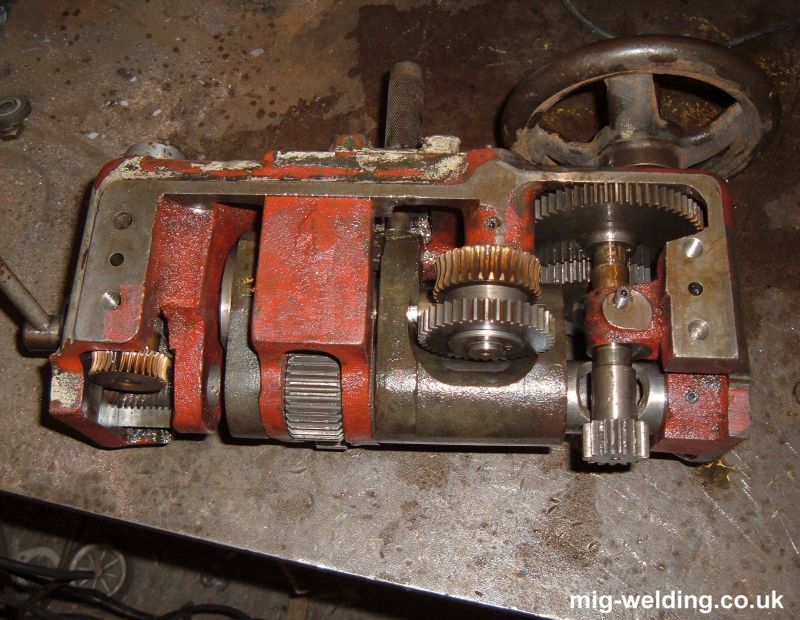

My lathe didn't cost a lot of money. It had been dropped from a forklift and a couple of the castings were broken. It's a Kerry Model C dating from the 1950s.
This is the gearbox used to motor the bed backwards and forwards for thread cutting. It's a tough project for a first cast iron weld as the alignment has to be spot on for all the gears to mesh correctly.
Broken cast iron casting

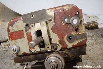

The obvious first step was to do a trial assembly to see how it should fit together. Turns out I had most of the parts I'd need.

Casting pieced back together

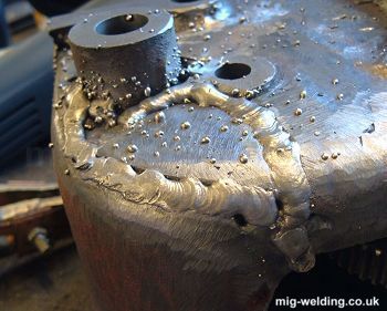

Here's a seam weld using mild steel wire without any preheating. The weld was easy to make and looks neat, but the casting made a lot of tinkling noises as it cooled suggesting internal fractures. In fact the two parts of the casting fell apart when the weld had cooled.
The stresses are caused by the weld shrinking as it cools. Mild steel is ductile and would draw under weld stresses. Cast iron is stiff and brittle so either the casting or the weld will tend to crack.
I tried MIG brazing wire instead of mild steel wire. The braze is softer than mild steel, and there were hardly any tinkling noises on cooling. The brazing was much less strong than the mild steel welding although it did appear to bond to the cast iron (the grey marks in front of the mild steel weld are the remains of a brazed joint).

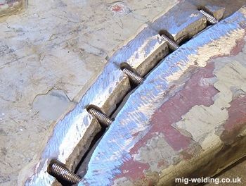

Studding is a good way to get around some of the issues of cast iron welding. I drilled and tapped one side of the casting and screwed in a number of studs. Then I made some slots in the other side of the casting using an angle grinder. The studs would then be welded into the the slots, so the gap is held together by flexible mild steel studs rather than a weld with a crack in it.

Studs fixed in casting ready for welding

If the weld between the stud and the casting bridged the casting then the weld would crack. The weld cooled very quickly and the cracking was obvious as the weld cooled with a cherry red weld on one side of the crack and a steel colour on the other side.
In hindsight I should have used stainless steel filler wire here - see the note at the bottom of the page.
Crack in cast iron weld
The answer was to weld to just one side of the stud. The flexibility in the stud allowed the weld to contract on cooling without cracking.

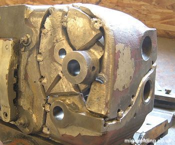

Braze is much softer than mild steel welding and hence is less likely to crack on cooling. Even so it has to be done in small lengths and then allowed to cool enough to touch before welding any more. I got carried away on one section and welded too much at once. A crack appeared to one side of the braze weld.
It took me a while to figure out how to braze a thick casting. The trick is to push the torch forwards in a straight line and turn up the power setting to get some heat into the casting. The casting needs to be hot enough so that the flux flows ahead of the braze (the flux is visible as a silver shimmering on the surface). Expect a lot of splatter.
There is more about brazing on the MIG brazing page.
MIG Braze (done badly)

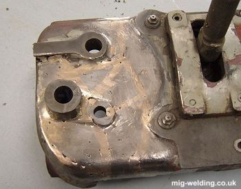

With the braze ground down the finished job looks quite neat. I could have gone to more effort filling in all the little holes, but the repair shouldn't be too noticeable once I've put a bit of paint on it.
It's not going to be the strongest repair in the world, but it doesn't need to be. The reason cast iron was used for the first place was it's a convenient way of making a complicated shape. It's never going to see a great deal of stress in use. I wouldn't attempt to weld anything structural or safety critical in this manner.
Brazing ground down
I'd made a few trial fits along the way, but it was still a great relief that all the gears fitted together and meshed correctly.
The lack of ductility of cast iron proved helpful as there is no perceptible distortion in the weld (although I'll admit one of the shafts was a slightly tighter fit than previously).
Gear box reassembled

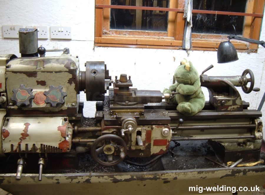

Here's the completed lathe in action. The casting is in the lower center of the photo below the frog's feet and the repair is largely hidden by the wheel.
The repaired lathe is fully functional and has seen a surprising amount of use since it was finally re-assembled (a whole year after the repair detailed above).
Kerry Lathe
