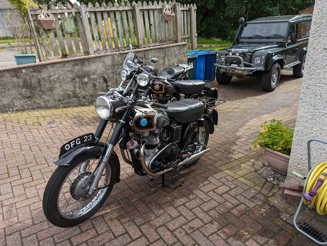

Feels plenty compression, suppose I can try though.Compression test?
new tank with liner, checked it all good, new taps and fuel hose.Leakdown is a good test as well to check valve sealing.
To be honest if it's poor compression or valve related it wouldn't run well at idle either but worth a look to rule it out.
If it's had POR or other tank sealant make sure the fuel tap is still clean (ie take it out and check it).

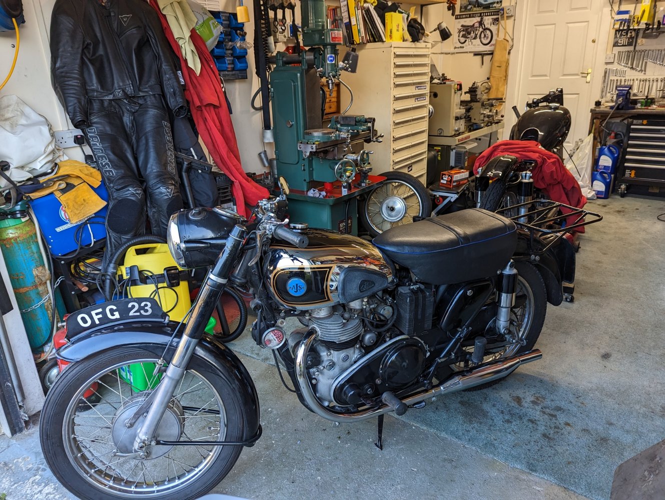

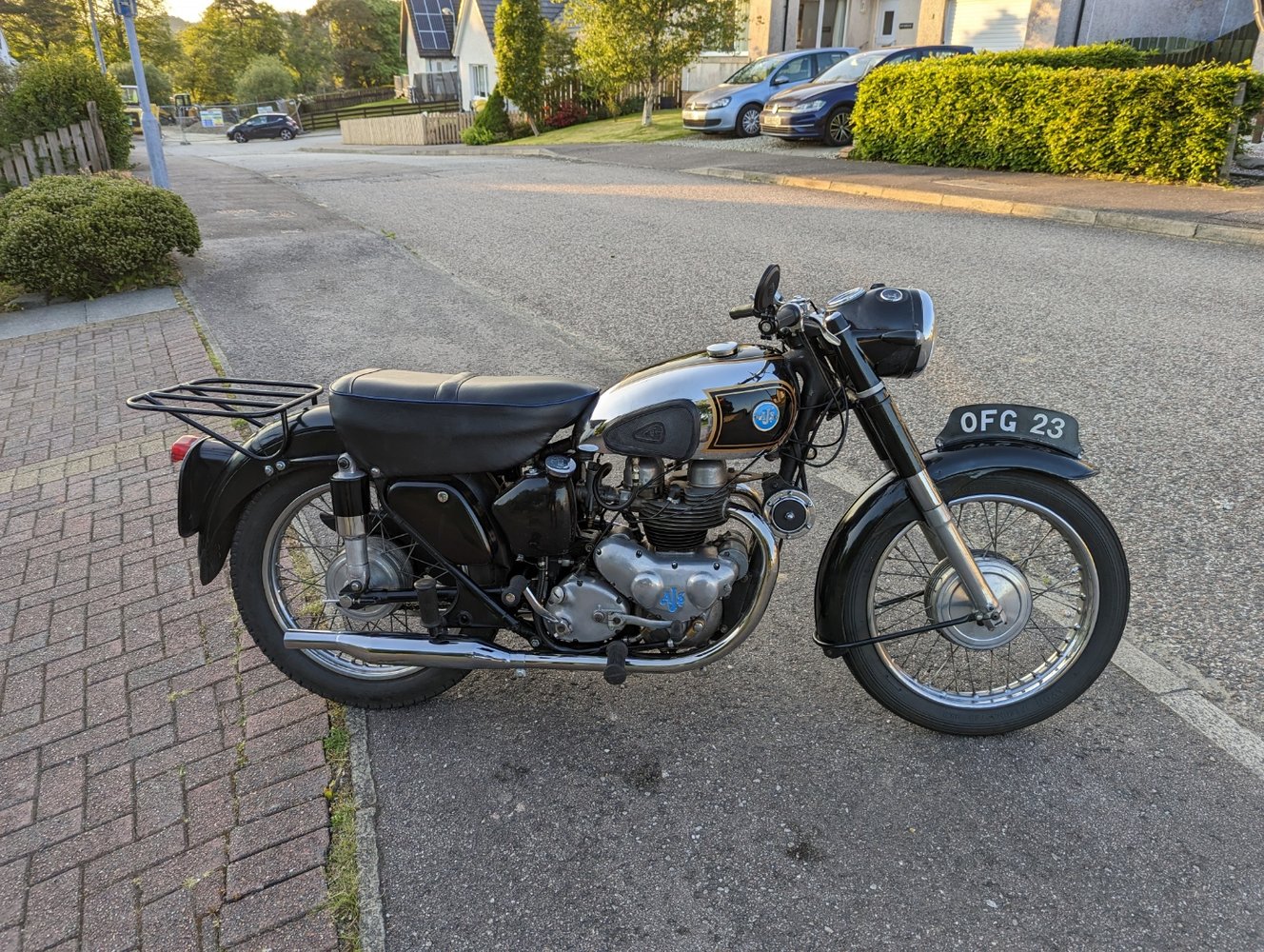

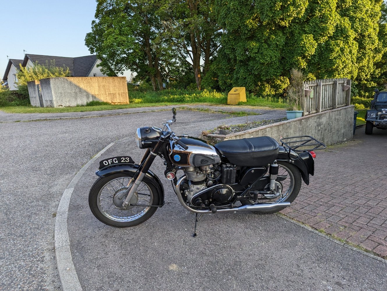

Emphasis on the words " some space"A couple of weeks ago while returning from a 20 mile trip the Ajay lost power and limped home.
Have dragged it out the shed today to figure out what's wrong, have changed plugs, plug leads a ( as one had a high resistance), stripped the carb and checked the manifold for air leaks. It still runs, though difficult to start and gutless, may be cutting onto one cylinder under load. Think timing and condenser check next...... the joys of old vehicles.

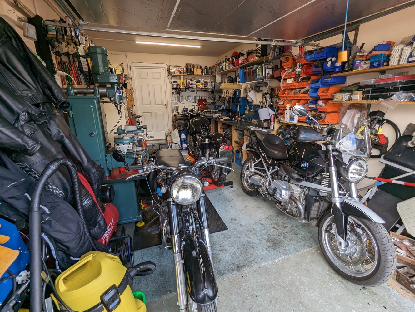

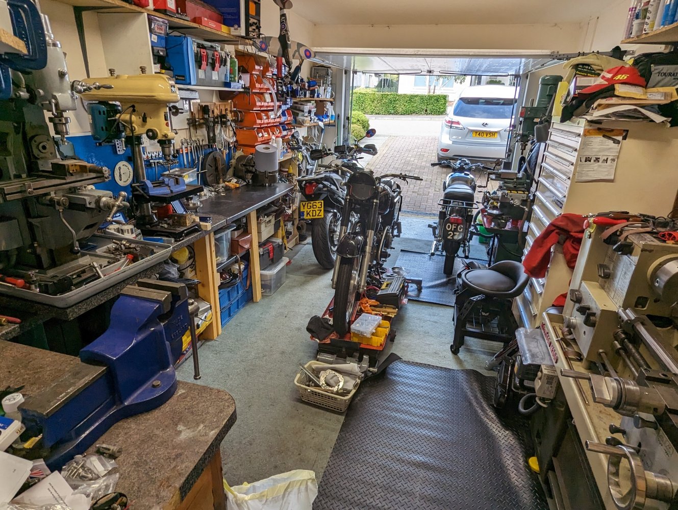

Gave the worlshop a tidy too, now even have some workbench space after sorting away Centec spares.
Aye K2F, quite likely.It's magneto, is it not? Probably that breaking down.
single carb, plugs look nice. No difference un symptoms if I pull either plug.Emphasis on the words " some space"
Plug colour ?
Is it always the same side that has a problem?
I assume a single carb. so if it's only one side that rules out a carb problem.
Is it easier to start cold or hot? I had a mag ignition B33 that would only start cold .it would run forever but if I stopped it it would not start until cold. Mag !!single carb, plugs look nice. No difference un symptoms if I pull either plug.
