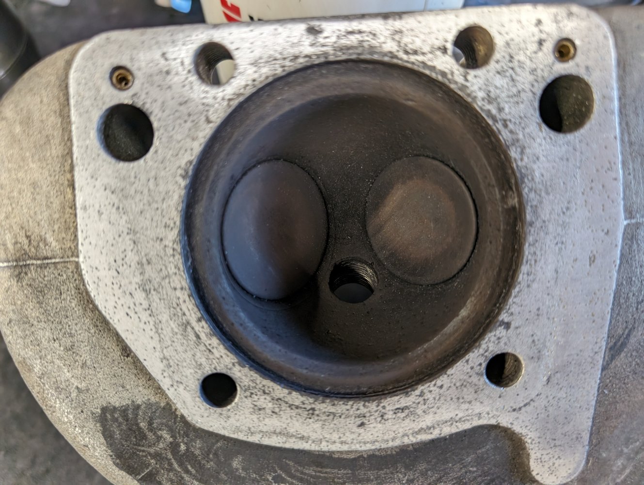

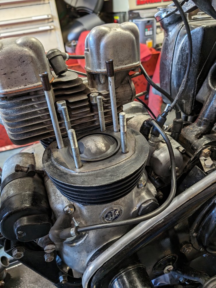

Replacing those Thackeray washers with bronze spacers would cheer things up a bit in the valve gear friction department.....Decided to retime the engine a little retarded last night, started it this morning and got the tell tale frapping noise of a blown head gasket!

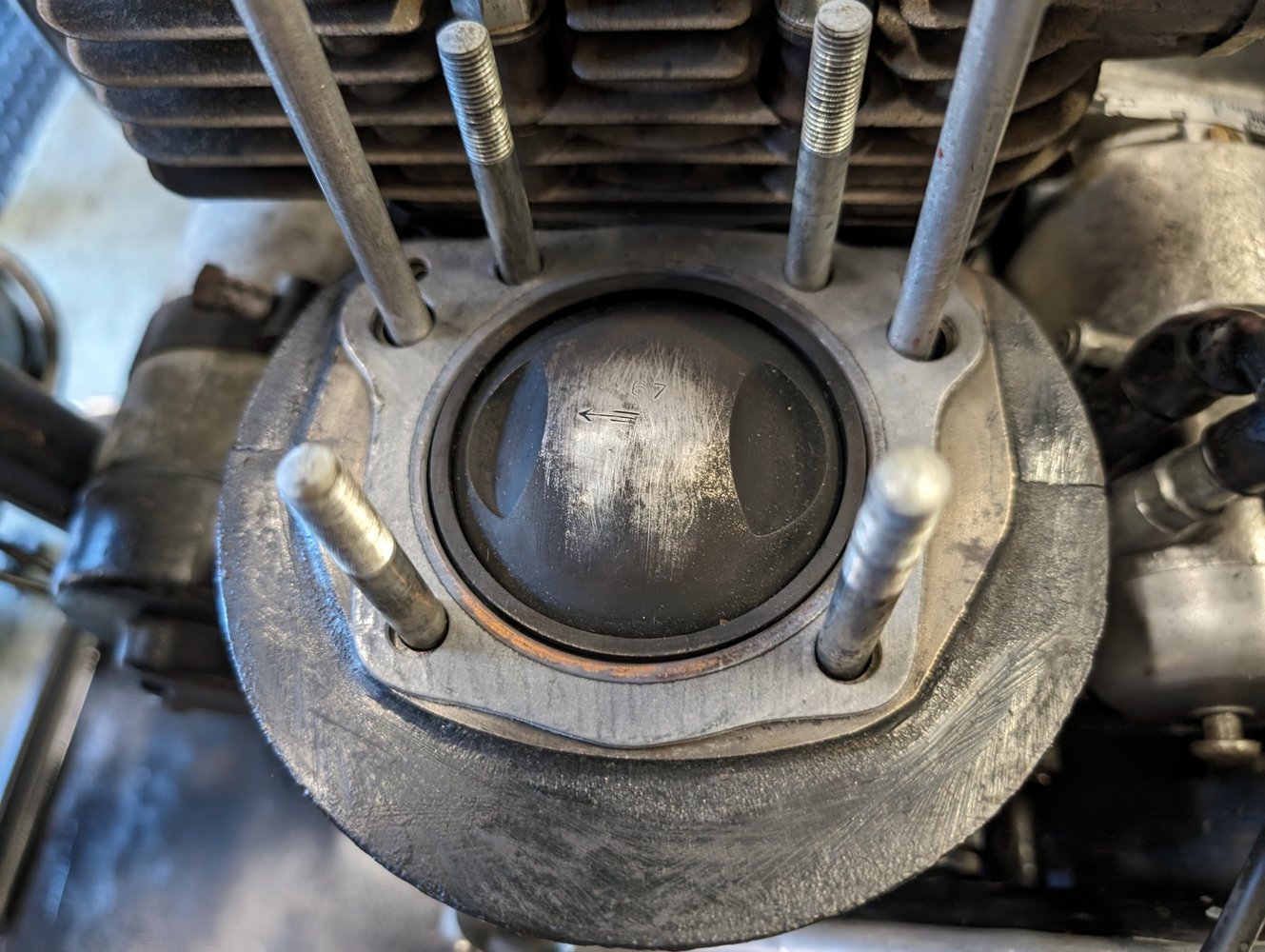

These engines have separate heads and barrels, so not too hard to strip:

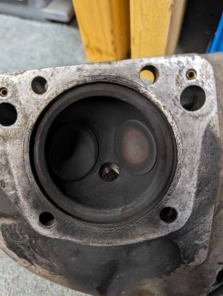

Head gasket was blowing:
I cleaned up the head on a sheet of plate glass with Fine emery paper taped to it, could not measure a warp, I suspect the head was under torqued:
Lucky I had an unopened old gasket set:

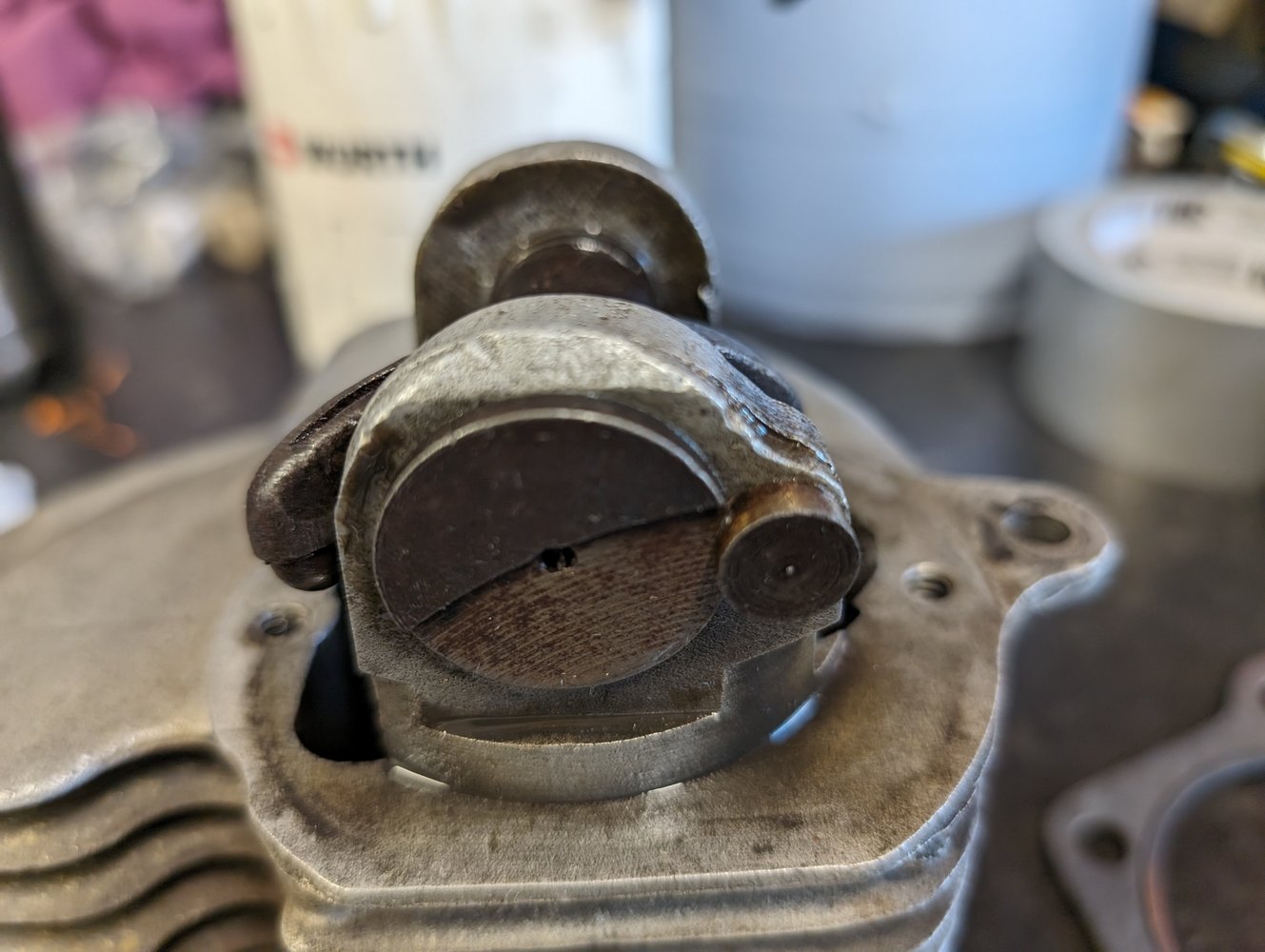

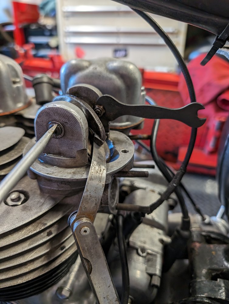

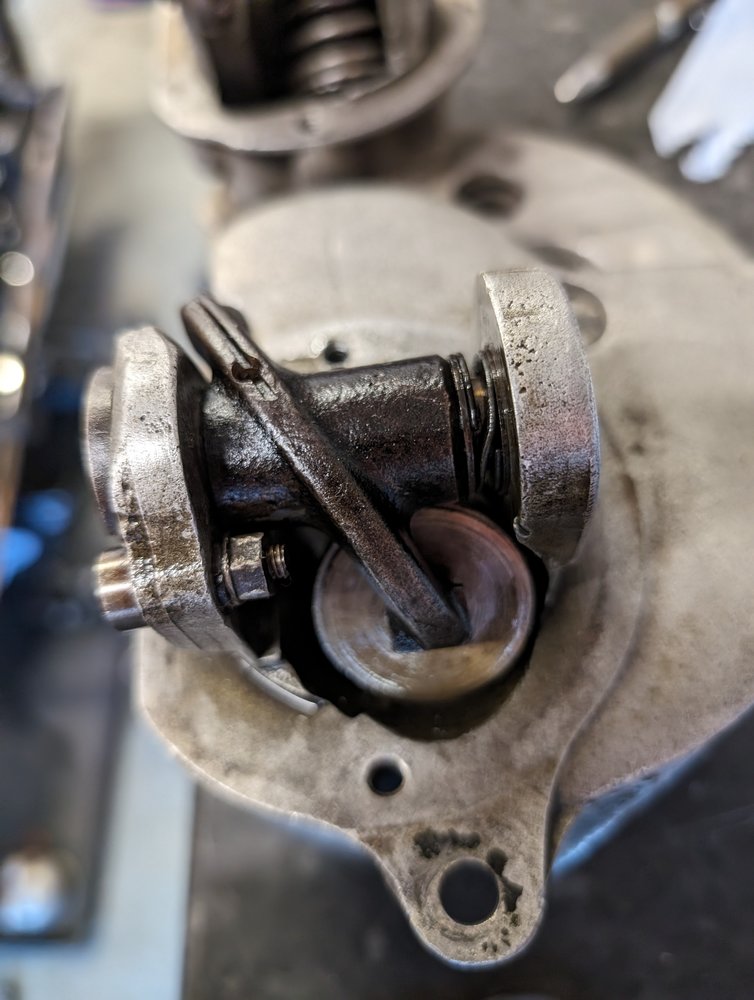

Valve clearances is quite an ingenious design, slacken a small nut that retains a cam:
the cam:
so you just adjust the clearance with a screwdriver, really quick and easy:

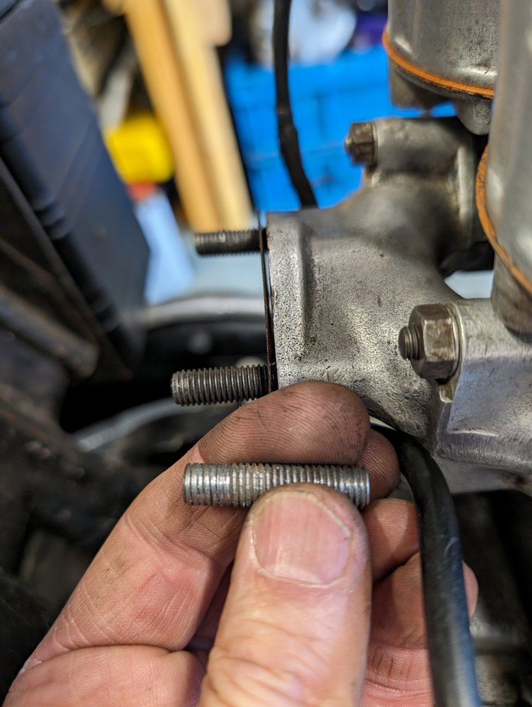

Not all went to plan, someone had fitted a cycle nut to a BSF thread and the threads came apart as I tightened it on the Carb flange, so cut a bolt to make a new one:

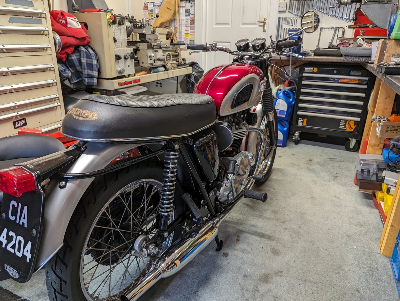

Rebuilt in an afternoon, started first kick and sounds the best it has:

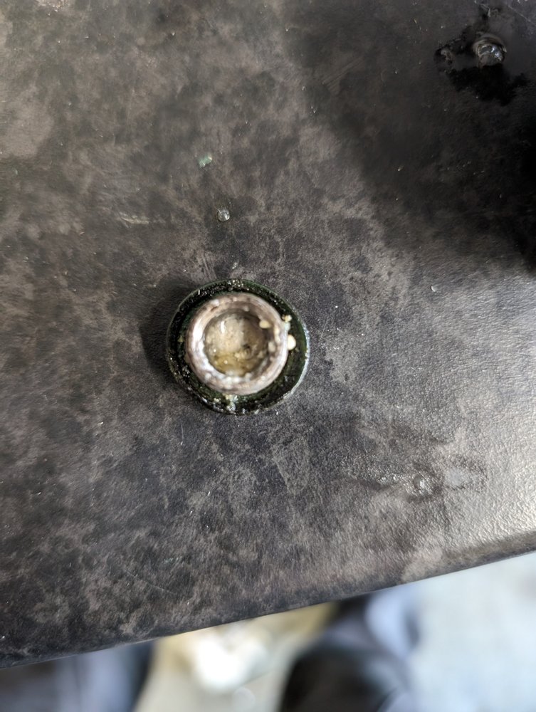

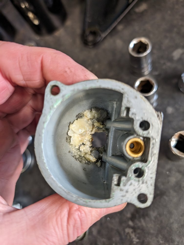

That's rather horrible - looking....Old fuel residue blocking carb jets was the problem, from a leaking tap, so new tap fitted and carbs cleaned:
Started after a few kicks
Unfortunately oil leaking past the points drive oil seal, so new one ordered.
