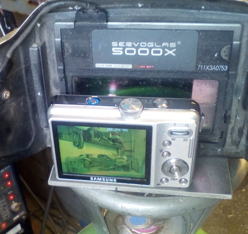

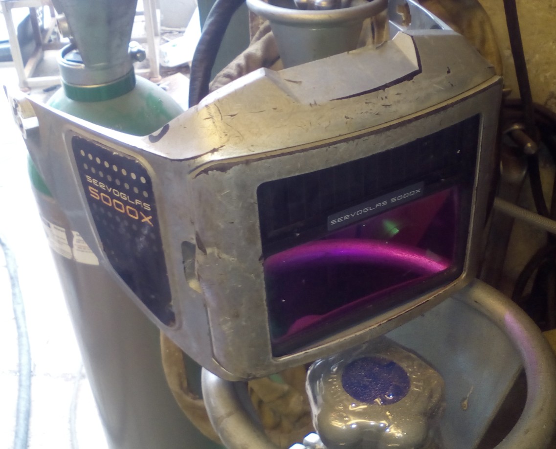

Thanks Henry, bit hard to tell from the video due to no filter being used , I just used an old auto dark helmet and made a bracket to hold my camera, not perfect but does help a bit.
The sound in the video however tells me more, and it does sound to be crackling in a similar way to my 1.2mm wire tests, maybe not as bad though, so maybe it is just the way things are.

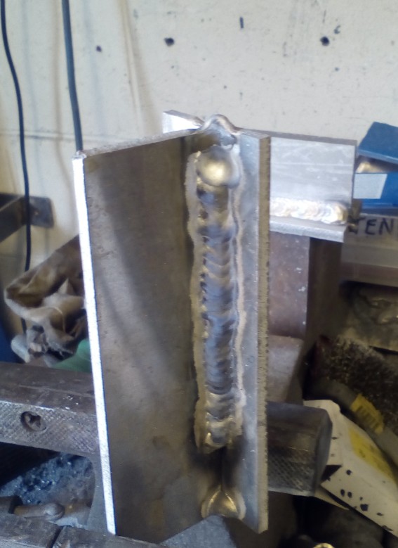

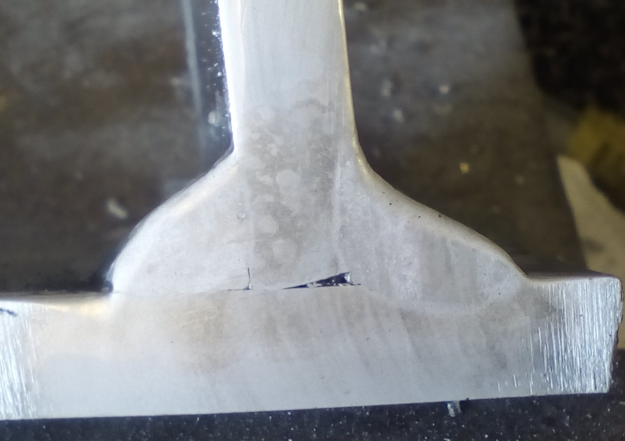

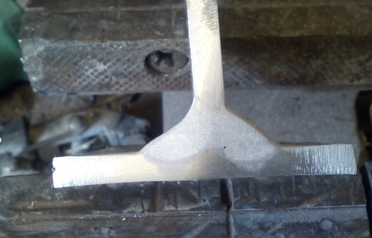

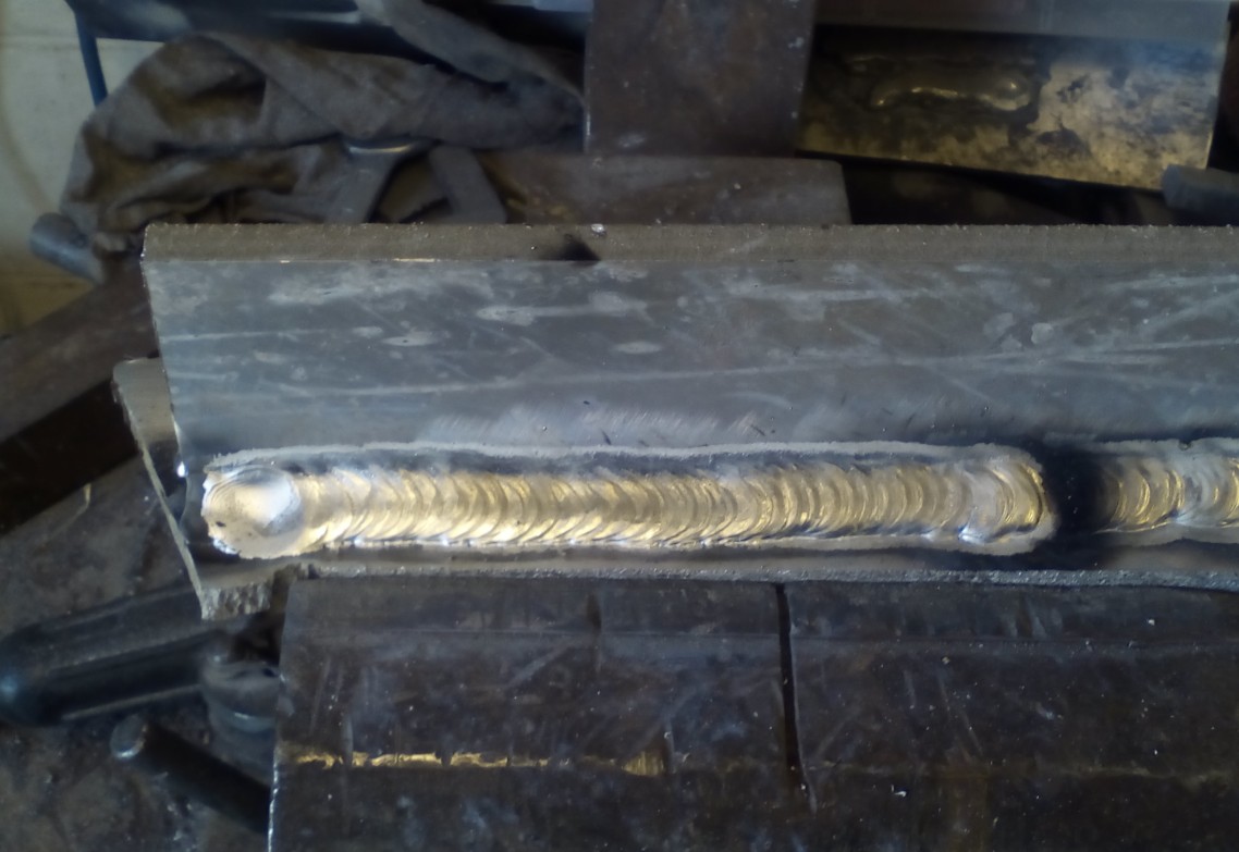

Quite a bit of porosity in the welds but likely that is because of the antifouling and other contaminants of the old Alu.
Getting a roll of EWM wire sent to me so I will see how it performs although unlikely to get a chance before next weekend as I have a stainless roller system, amongst other things, to put on a boat next week. Might make it down to the workshop this afternoon or tomorrow so if I get a chance I will load some of the old 1.2mm wire and give it another go.
