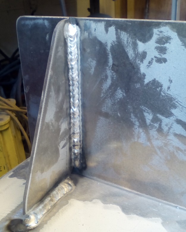

Ok been busy here so this evening was the first time I got a chance to load the EWM wire.
Big difference I would say, it is much more like the results I was getting from the 1mm wire.
This now begs the question of whether the change is down to the change in grade from 5356 to 5183 or change in brand of wire from Super6 to EWM. I suspect the latter but I still have a niggle that the 1mm wire was Super6 so...

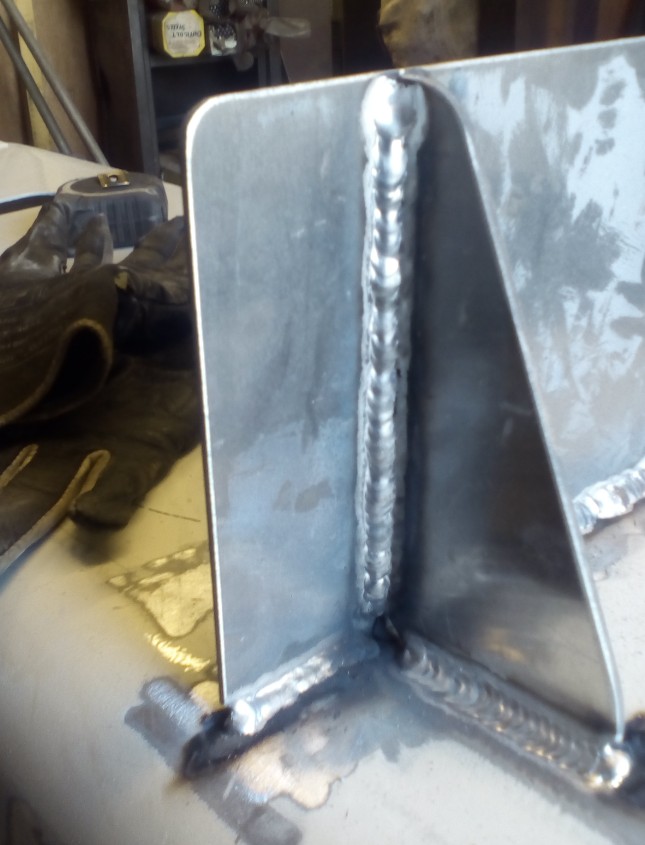

Was using the EWM wire today welding some bits and pieces on an Alu Catamaran and it is beautiful stuff to weld with. Inside the bow I was filling up corrosion pitting and expected trouble but it went without a hitch. Outside I was re-welding a bracket that had been welded on previously and was a bit dodgy, ground out the old weld and re-welded and also added a couple of gussets and it was blowing a gale, expected trouble and again perfect. Did a crack in the stern on the divers platform and again things went well and lastly welded up some shelves in a console that I probably would have previously tig welded but not now
Tomorrow I will be welding some aerial mounts on that I made up today and also might get a chance to do the shelf in the other console.
Now whether it is because of the different grade of wire or that the EWM wire is better quality I still don't know.
