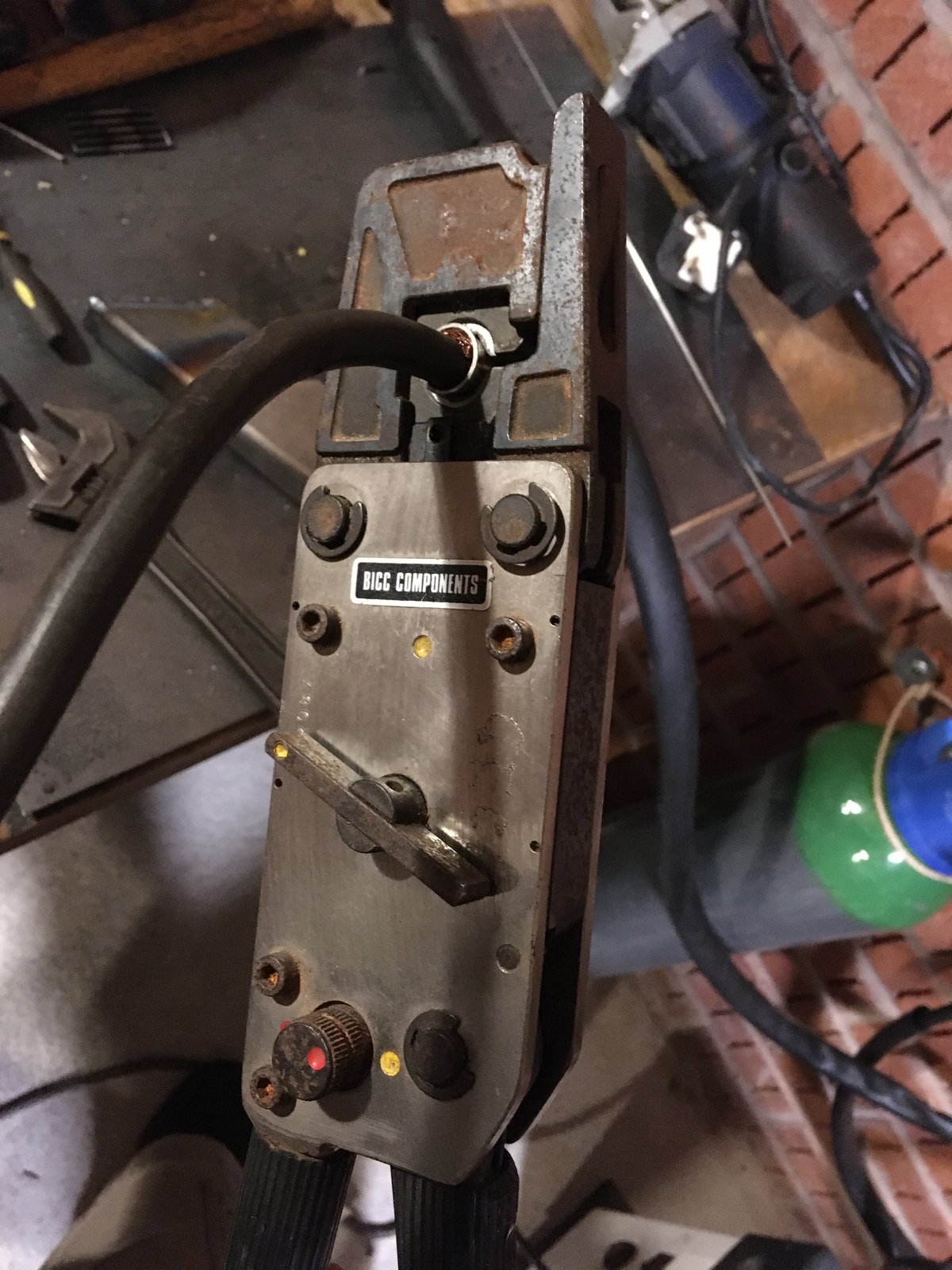

48 hours continuous welding breaks cables pretty quick.I've got a set of these, they will easily do up to 120mm CSA. Hydraulic crimper is massive overkill for welding cable size.
Surely you don't bust enough leads to warrant buying a set?

If it's the cables breaking down due to the current that sounds like it would benefit going up a size or two.48 hours continuous welding breaks cables pretty quick.

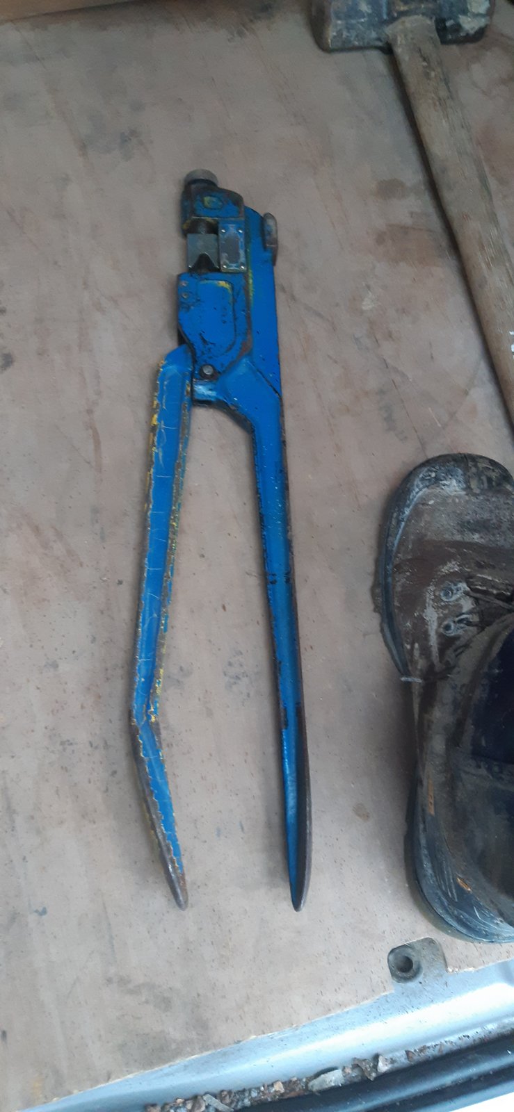

ive got the same ones . been using them 2 day on 25 and 35mm mainstails lugs and ferrules joining swa . ive had them for 50 yearsThis is what you need Brad.
They'll do 10 > 120mm with a bit of fine adjustment if you get a thin lug.
I had a pair of these for 19 years at my old firm but had to give them back
This pair didn't have a plant number though....

Unless the crimps are poor to start
Aye, I always buy from RS now, seem to be decent quality and not that much more expensive than othersThere's a lot of garbage ones about, too big for the cable size they're intended for and made from thinner material too.
I've got one of these I use for battery leads on tractors and trucks. I paid quite a bit more than that though. But it looks the sameI have the cheapo hydraulic type and one of these hammer type, you just cant beat these manual crimpers at times.
It rattles around in the tool box just for that day....

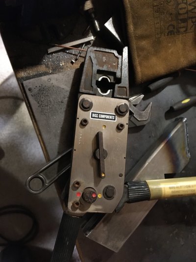

What about simply soldering the lugs then?It’s not so much the cables breaking down it’s between the lug and the cable. That oxidises.
Not a bad idea. I did solder some connectors a little while ago (because I didn’t have a crimper) and they seem to be holding up.What about simply soldering the lugs then?
And before the debate gets started on crimp vs solder. I worked designing and building systems in some pretty damn harsh environments and we saw equal failures between crimped and soldered connections. Ours would usually be both (solder to improve the electrical connection chiefly). The only thing that matters is proper strain relief.
If you're suffering with oxidisation and a poor connection then flooding it with solder will remove the ability to oxidise and also improve your connection.
Strain relief like you say is the main issue and I’m looking at sorting that out.
perhaps some heavy duty thick shrink tube.
