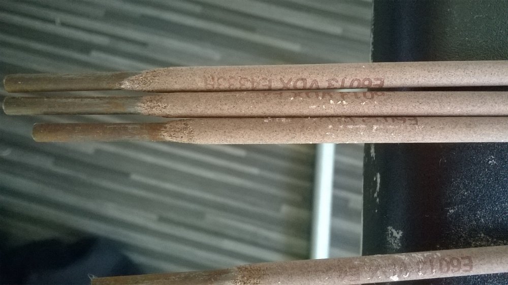

So ok I guess inverters will struggle with running them I've seen rapid weld sell Lincoln 5g 6010s but what makes theserods so hard to run A 2.5 surly won't need any more the 90 amps and it says on the speak sheet dcplus is it to do with the voltage drop keeping the tight arc maybe I should just buy them get all four machines out run a rod with v up open root plate video it and then we will see the results I guess
They'll run if you can keep a short arc, but 6010/11 are run with a whip and pause motion to control the heat input into the puddle when doing open root. When you whip, if there isn't enough voltage reserves in the machine, the arc goes out.
If you're only interested in doing vertical up open root, don't waste your time with 6010/11, plenty of other rods that will work fine for that application. They come into their own when you want to do downhill roots.

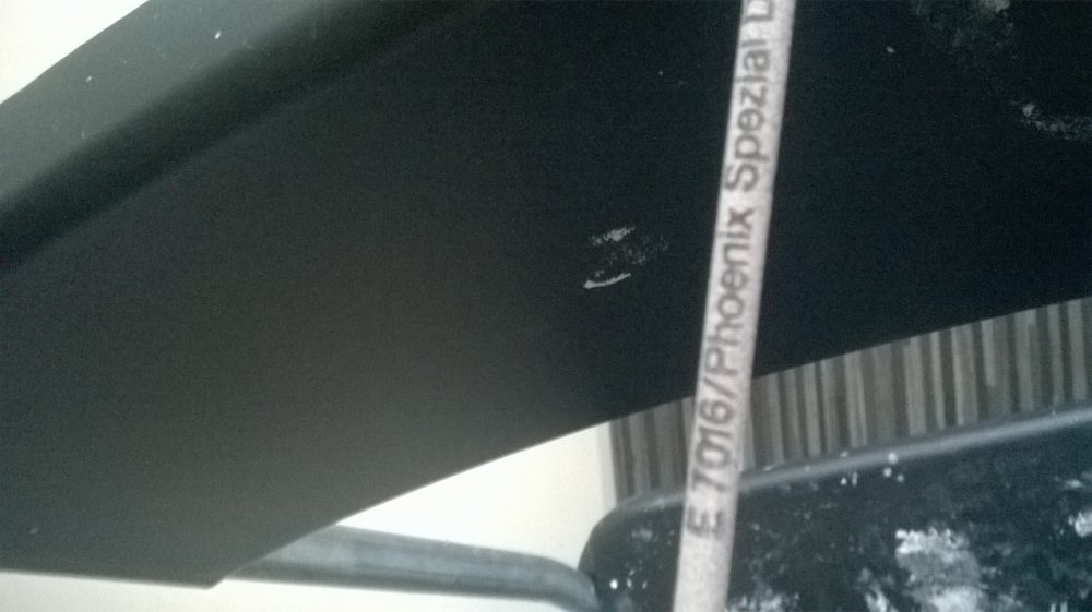

No no I want to do pipe roots with 7018 caps but I don't want to cut a load of pipe up bevel it tack it up and none of the rods run cuz of my machines as I can cut plate and bevel it a lot quicker
Yeah I've got fincord m supercito 7018 should of bought some commits and I've got murex 6013s my spezials only come out when dad is gunna pay me for work
Ok then let me have a think I'm off work today due to had something in my eye got an infection right well so I've been looking about what rod bar a 6010 or 11 would any one use then as a root run would a vodex be any good
If you want to make your life as difficult as possible, try rooting with a 7024... The reason 6010/11 was invented was to make open roots easy and fast. If you want to run easy and fast open roots then use the right rod for the job, and find the right machine to run them.
As I said, give me your address, I'll send you 10x 2.5mm nufive for free so you can check before spending £80 of your hard earned on the offchance you can run them.
Just try the nu5, that's a kind offer from Hugh. They should run on your machines - in fact, they will probably even run on high voltage AC quite nicely (I've not tried the nu5 brand on AC personally but I have used cheap ones just fine). TechnicalAl knows his stuff and doesn't consider them to be as good as proper 6010 rods, but I can certainly say that although this may be true they're still a fantastic rod and I am sure that you will find them ok.
Ohh don't take me wrong I know technicalAl and. Hughf are very knowledgeable ppl im not disputing the fact in this world I know how to to stick stuff together im far aaway from knowing all these guys knowledge and skill and like I said ill never know everything in this world as its ever changing and your right its an incredible offer
