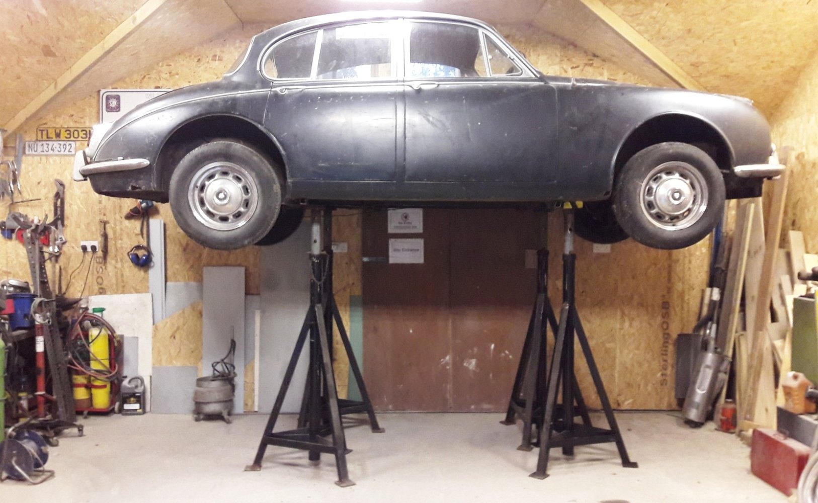

My only question is how do you get the car wheel on to the platform initially, trolley jack I presume?
I take it, it's the Vette sitting on them?

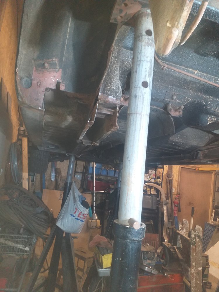

It is, but the comment was about the pipes bending, there's 4 of them on the upper platform vs 1 on an axle standBut a tripod is the most stable shape.
Where's the engine/trans???I used one of the the air jacks and jacking beams with the help of ramps and axle stands to get it to the 500mm first lift height. yep a Vette siting on top.

i converted a par of builders trestles that height and made extensions for the big jack i have to get the vehicle up there in stages

Now't wrong with that, my only concern with that set up would be if the rear axle unit mountings are solid enough to take the weight of the rear axle unit. I've seen them fall out when lifted.... Hell, ever seen how support yachts/narrow boats, and they build container ships on wooden blocks.....

They will spread the load far more than standard axle stands ever would.
Once it's set up tap each leg with a hammer to make sure it's taking load and work away.
I'd be much more worried about the slabs but if they are well laid on compacted hard core, they will easily take that weight, however not when the load is applied so close to the edge as the front ones seem to be.
For improvements, as others have said, something to spread the load under the ends of the tube feet will reduce point loads into the slabs, I'd use soft wood, at least an inch thick, and if you are really paranoid I'd put a 4 inch square of plywood under each leg on top of the soft wood to eliminate any chance of the soft wood splitting from the leg punching loads. It's all they normally use under scaffolding so would work fine here too.
Something with a bit of give will be better than steel in this case (in my opinion)
I'd have no concerns about the whole thing toppling over (unless you live in an earthquake zone and even then it would probably survive) the car is connected to the stands (by friction) and the car is a stiff member so there is connection between the tables, also the suspension will move to take up any movement.
As a test, try and push that lot over, and see how you get on.
If you want to load test, just load to slightly more than the design load. The 5x test load is for lifting equipment and that's a destructive test for quality control. If any lifting equipment is load tested above its swl it should be scrapped.
For a physical test, put a heavier car on the tables as that will test the whole load path (slabs and ground included) preferable without moving the tables so you are testing the same patch of ground, or put extra weight in the car. An extra 10% should do it, so 40kgs (two bags of cement) a corner.
