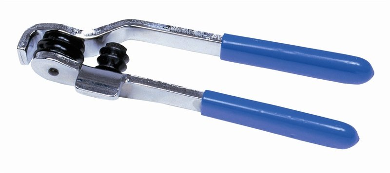

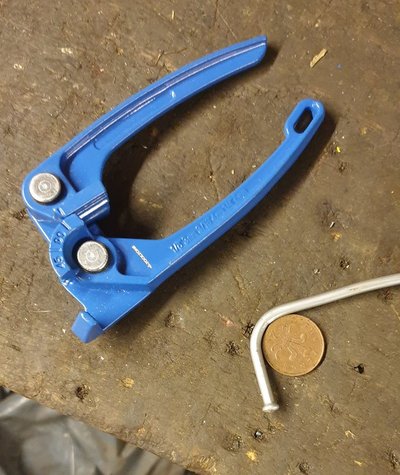

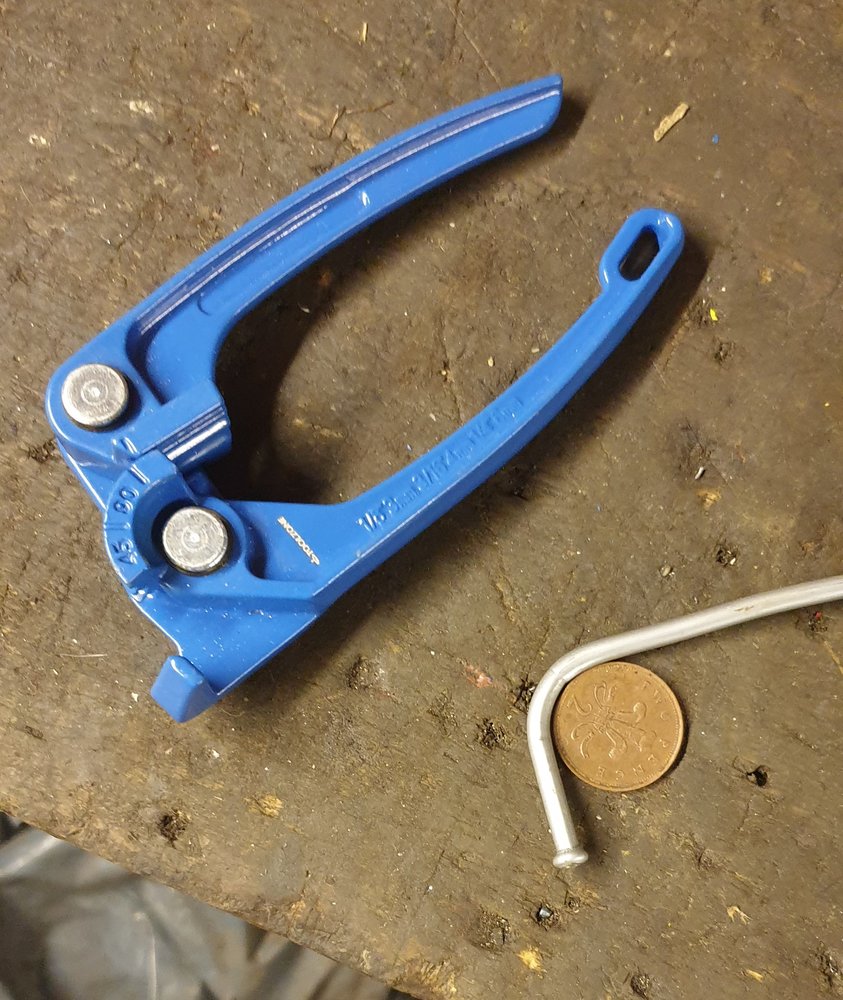

yes Ive been liking the benders with rollers, dont ask why, i think i have a bit of fathers ocd buy a tool and make it last for ever lol.Spendy!! I have alot of brake pipe benders - more recently got this one which has all rollers but havent used it yet. Can also straighten coiled brake pipe aparantly

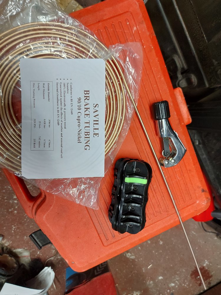

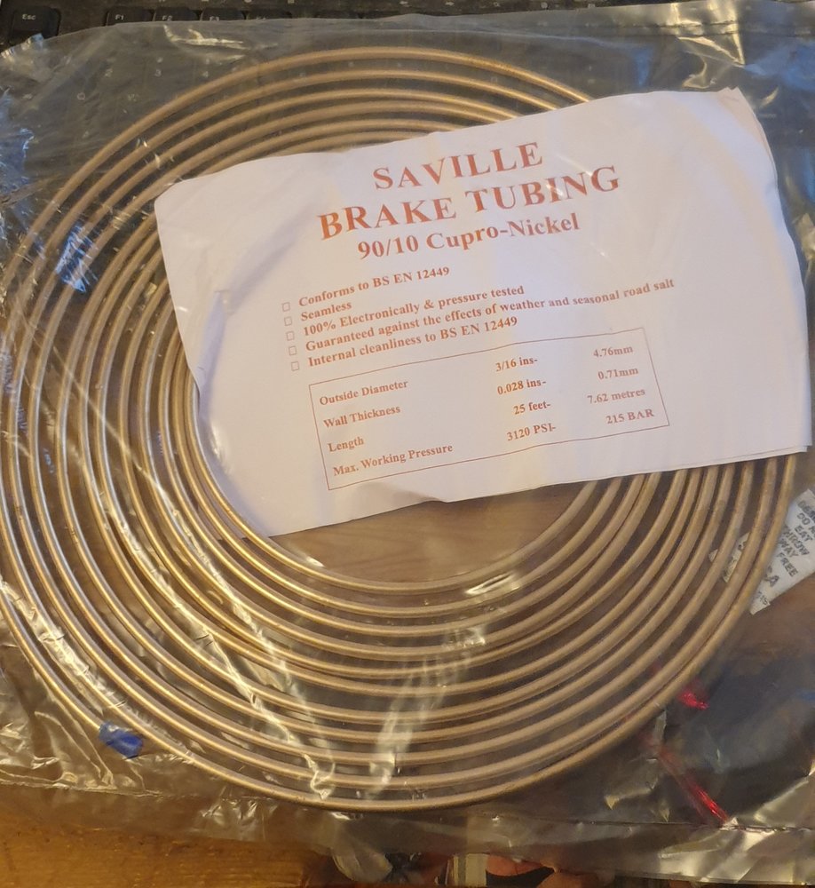

I would not use anything other than Kunifer for new lines. Ive seen copper lines go all green and corroded here too. Steel - zinc or not is a no no for me. It is cheap & keeps its shape well for prefabricaiton hence why car manufacturers still use it. But ferrous lines in our climate have a limited life especially for a classic car you intend to keep.
So what type of Kunifer do you use,
