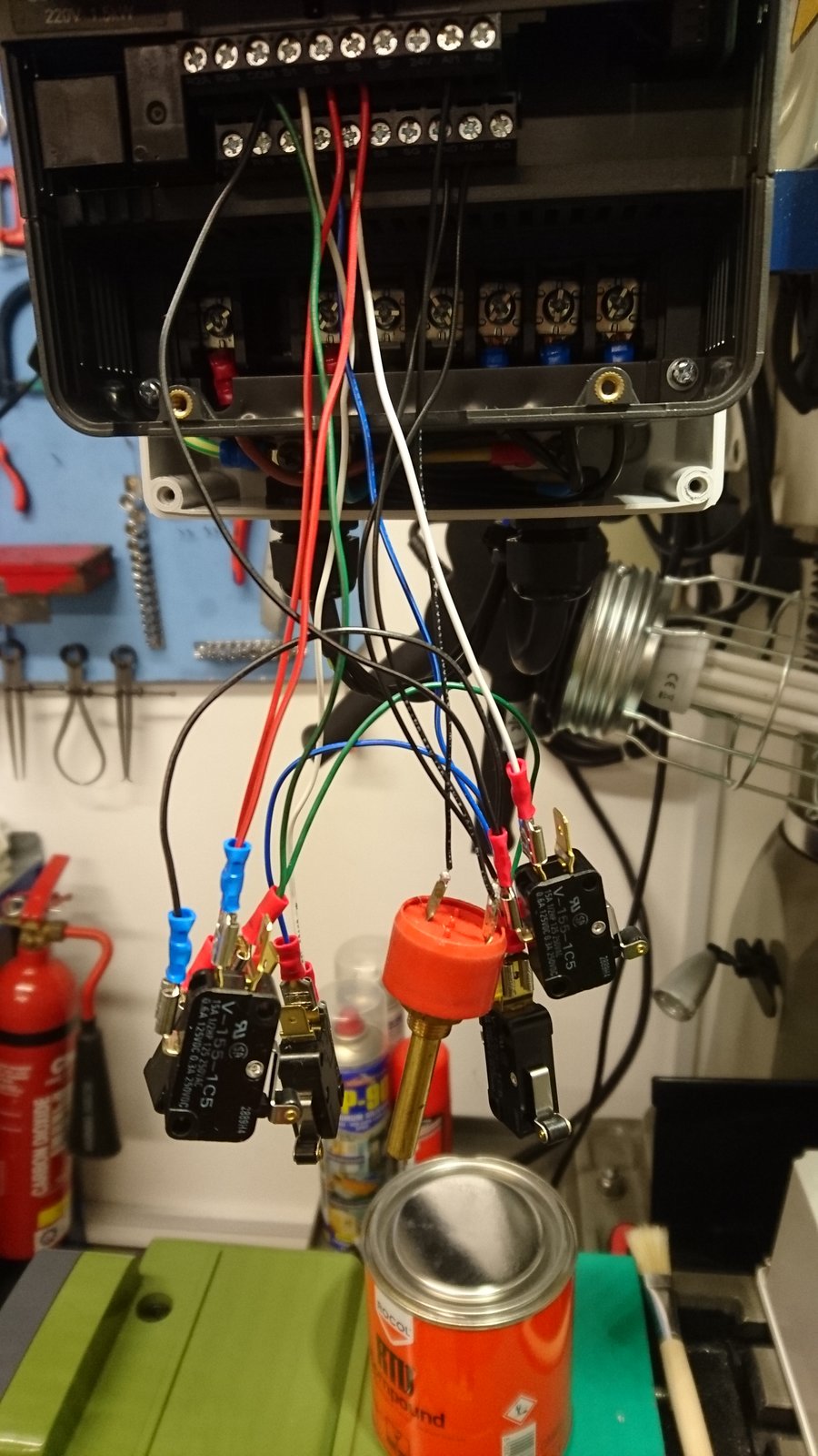

I have decided to fit a vfd to my Harrison M250. The vfd unit I have is a Teco/Westinghouse E510. It is a fairly capable device with lots of programming options. This will be driving a 1.5 kW 240 volt 3ph motor.

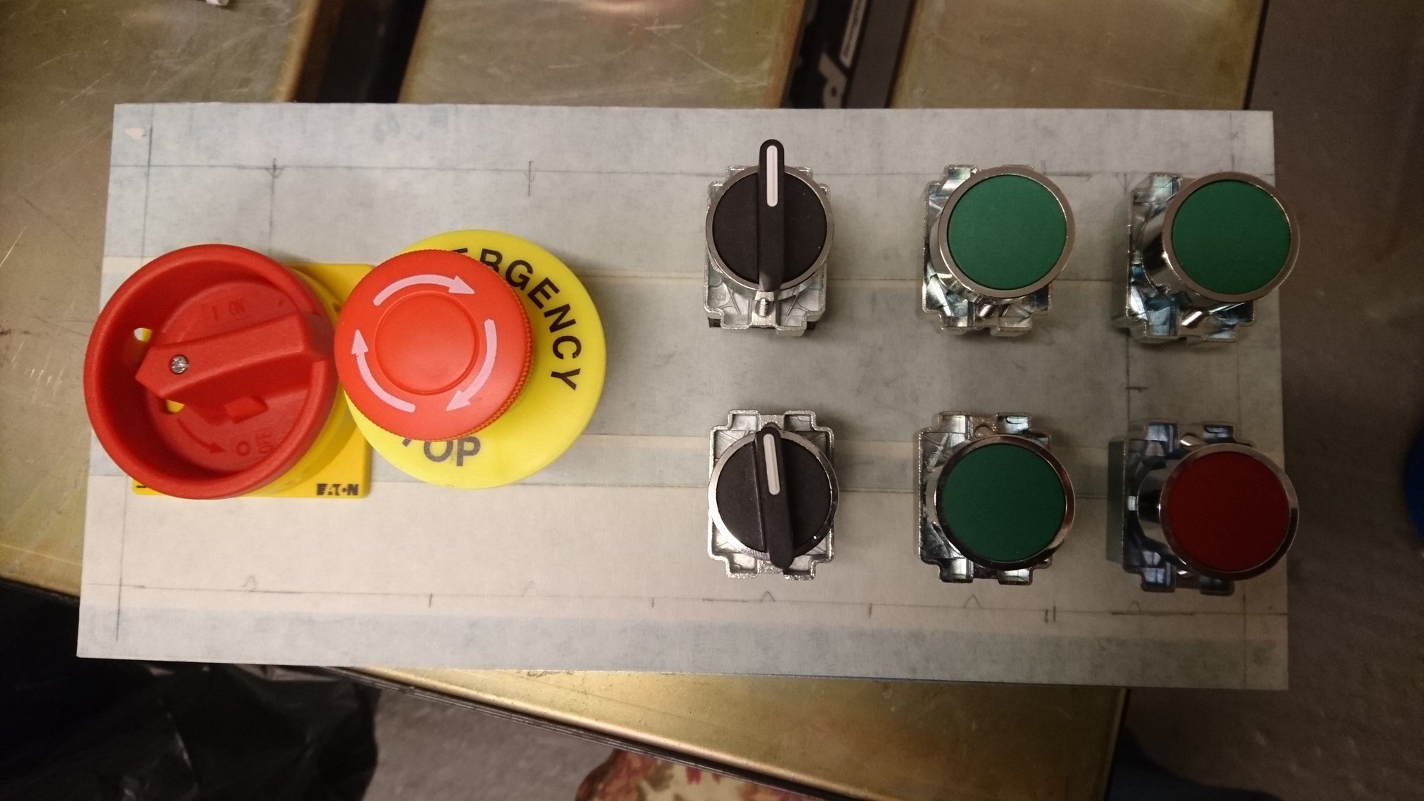

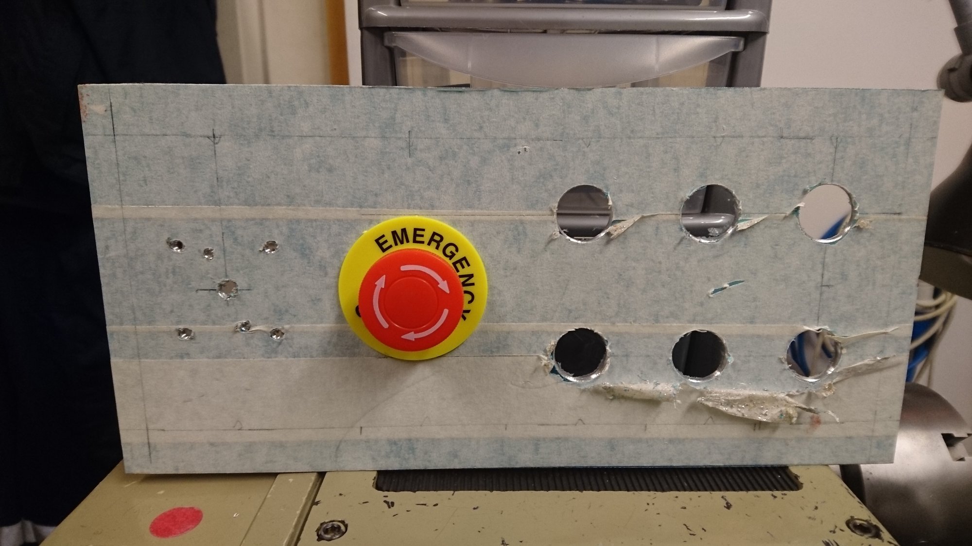

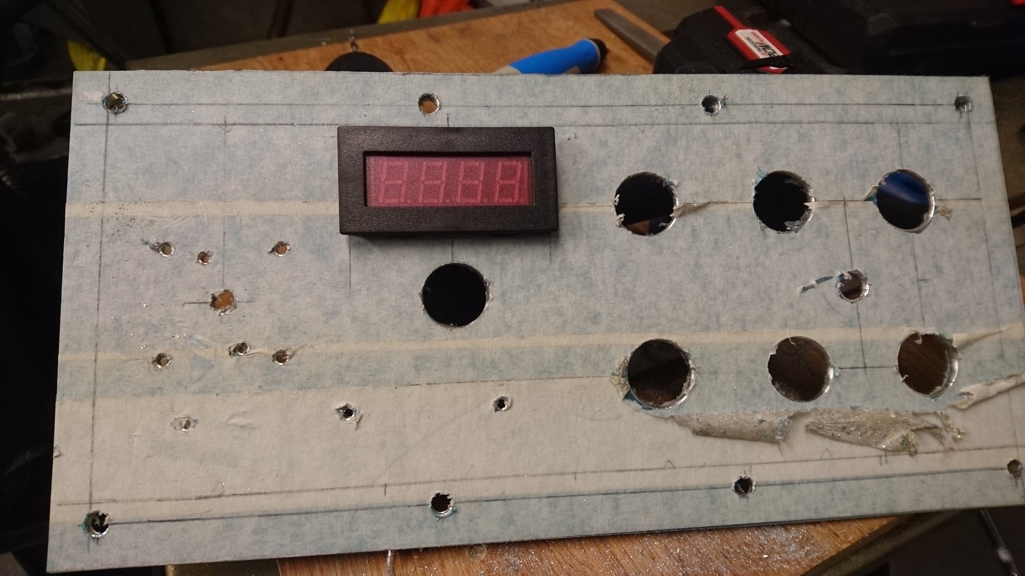

My Harrison M250 is a genuine factory single phase model. My plan is to keep the original control panel and use the switches on it to operate the inverter. The existing switch gear will remain in situ, in case I decide to return the lathe to single phase operation in the future. Only the switch contacts will be in circuit with the vfd.
There will be a separate small pendant with the speed control potentiometer on it, along with the jog fwd/rev controls. This is required as there are no switches on the existing control panel that can be pressed into service for these functions.
The vfd and motor are currently fitted to a mill/drill which is the donor machine. I've used this as a test bed to setup the parameters of the vfd the way I want before removing the motor and drive.

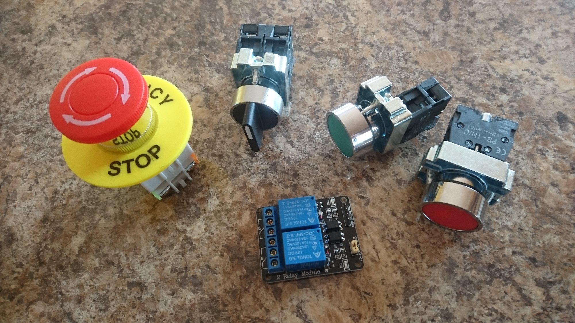

I'm using what's called three wire control to switch the motor on and off. This requires a normally open and normally closed push button. This option enables me to use the existing panel switches for on/off.
The fwd/rev input will be connected to the existing rotary switch on the control panel. I have programmed one of the vfd external inputs to give a rapid deceleration to stop. This will be hooked to the series connected safety switches on the lathe chuck guard and change wheel cover, as well as the kick e stop.
This just leaves the jog controls and speed potentiometer. As previously mentioned these will be on a separate pendant. The potentiometer is wired to the vfd's internal 10 volt supply with the wiper feeding one of the two analogue inputs.
Here is the vfd connected up for testing. I'm using microswitches just to get things working prior to transfer to the lathe.
