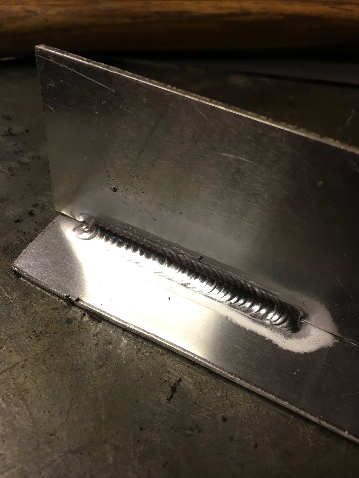

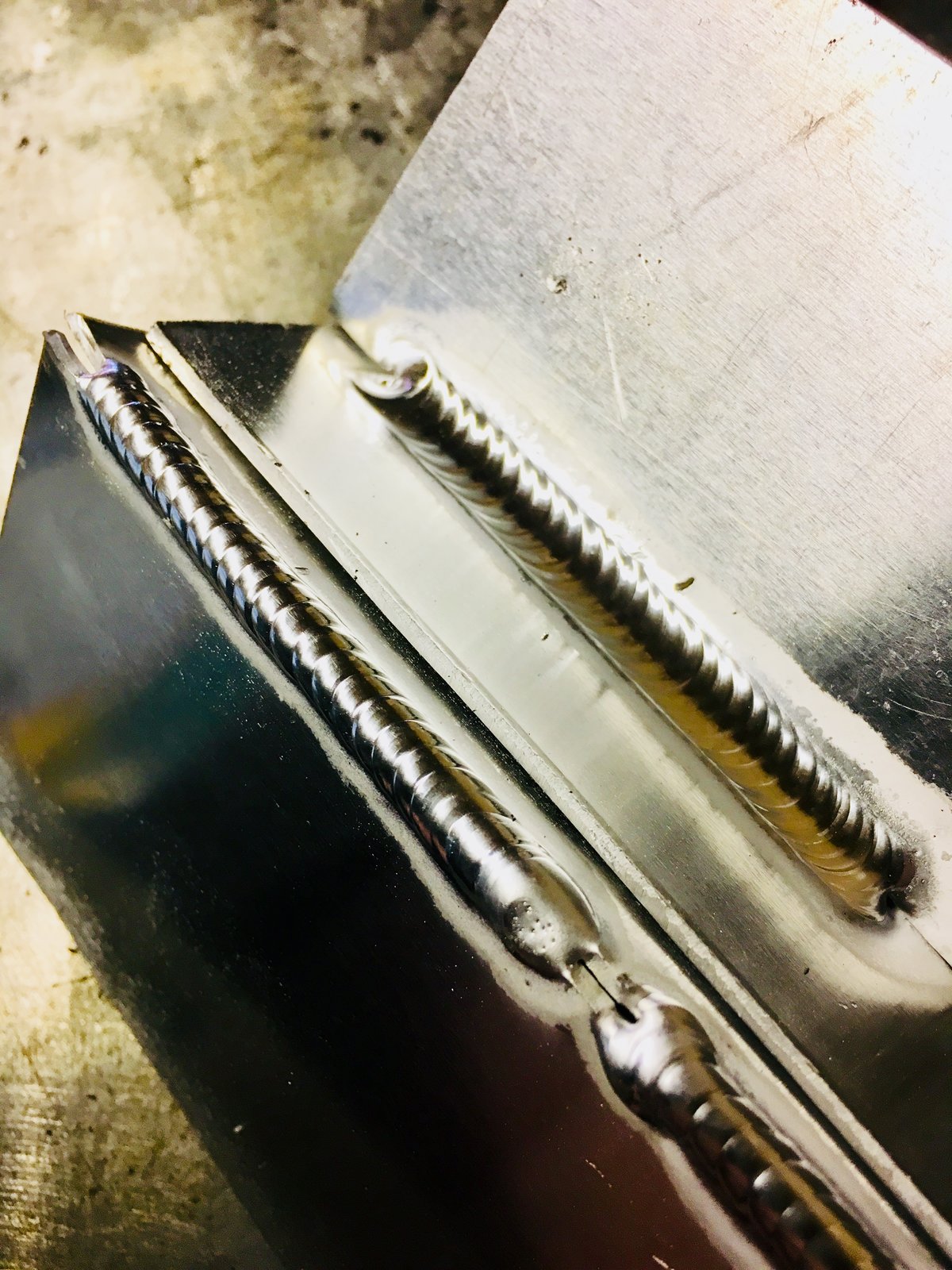

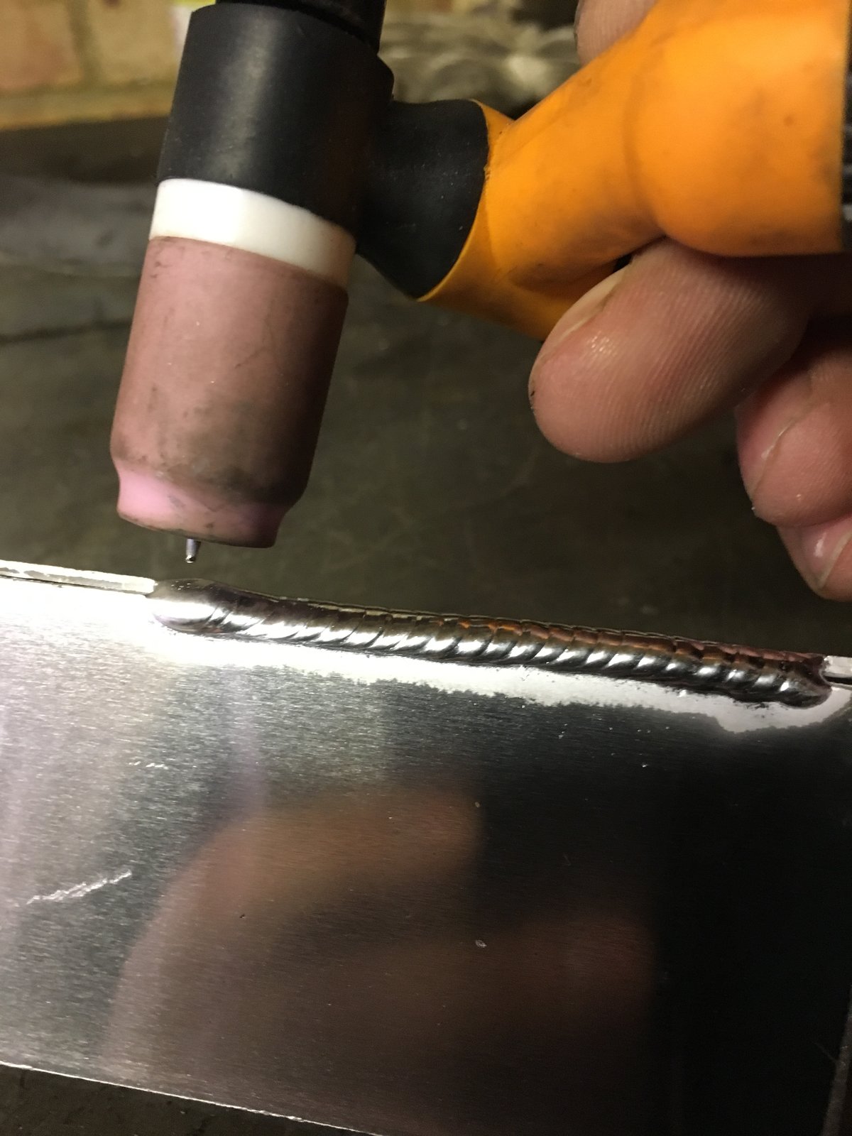

do you slide the rod in from the side or more from above? you should be able to get the filler to the pool without the torch getting in the way...

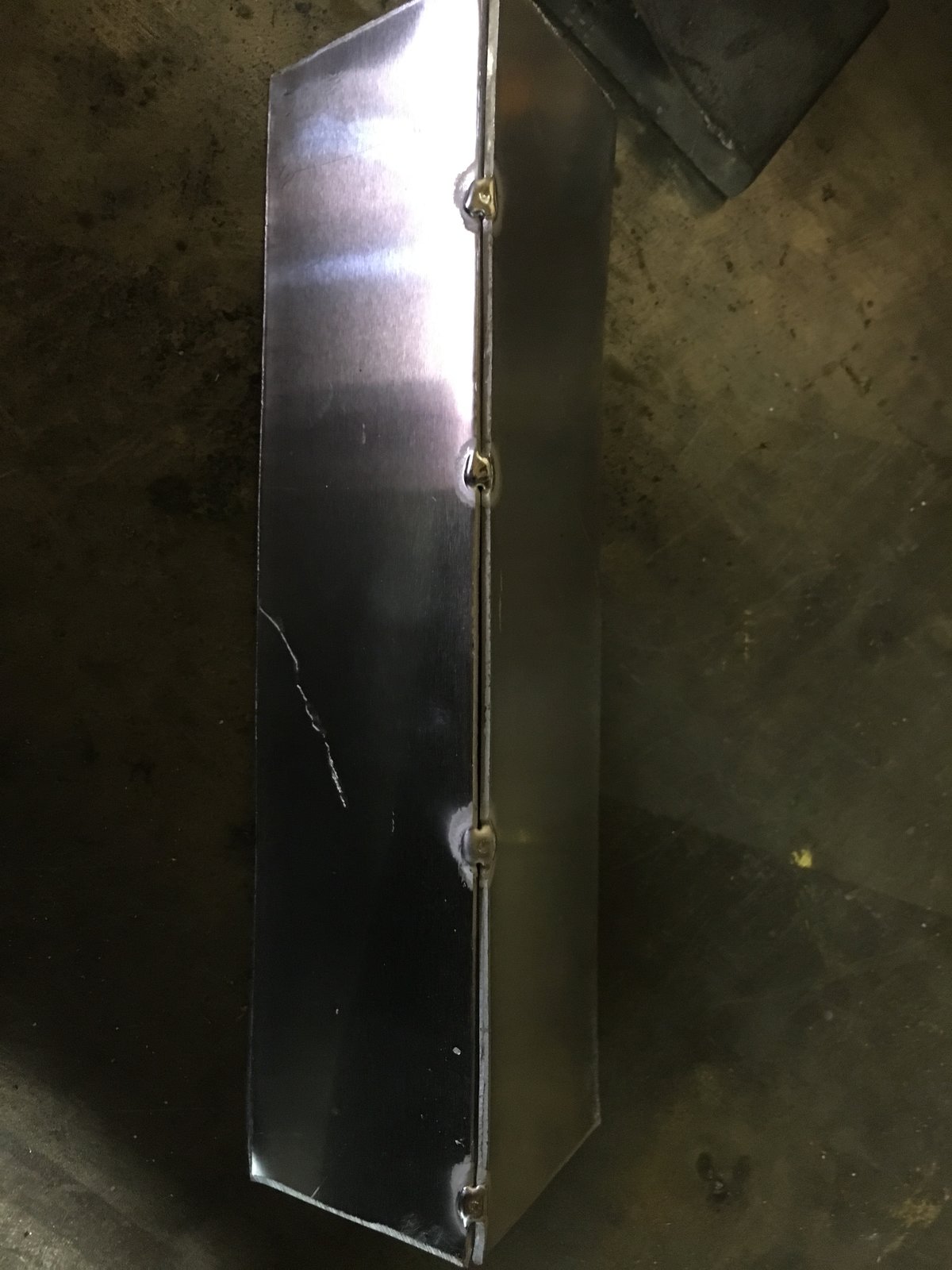

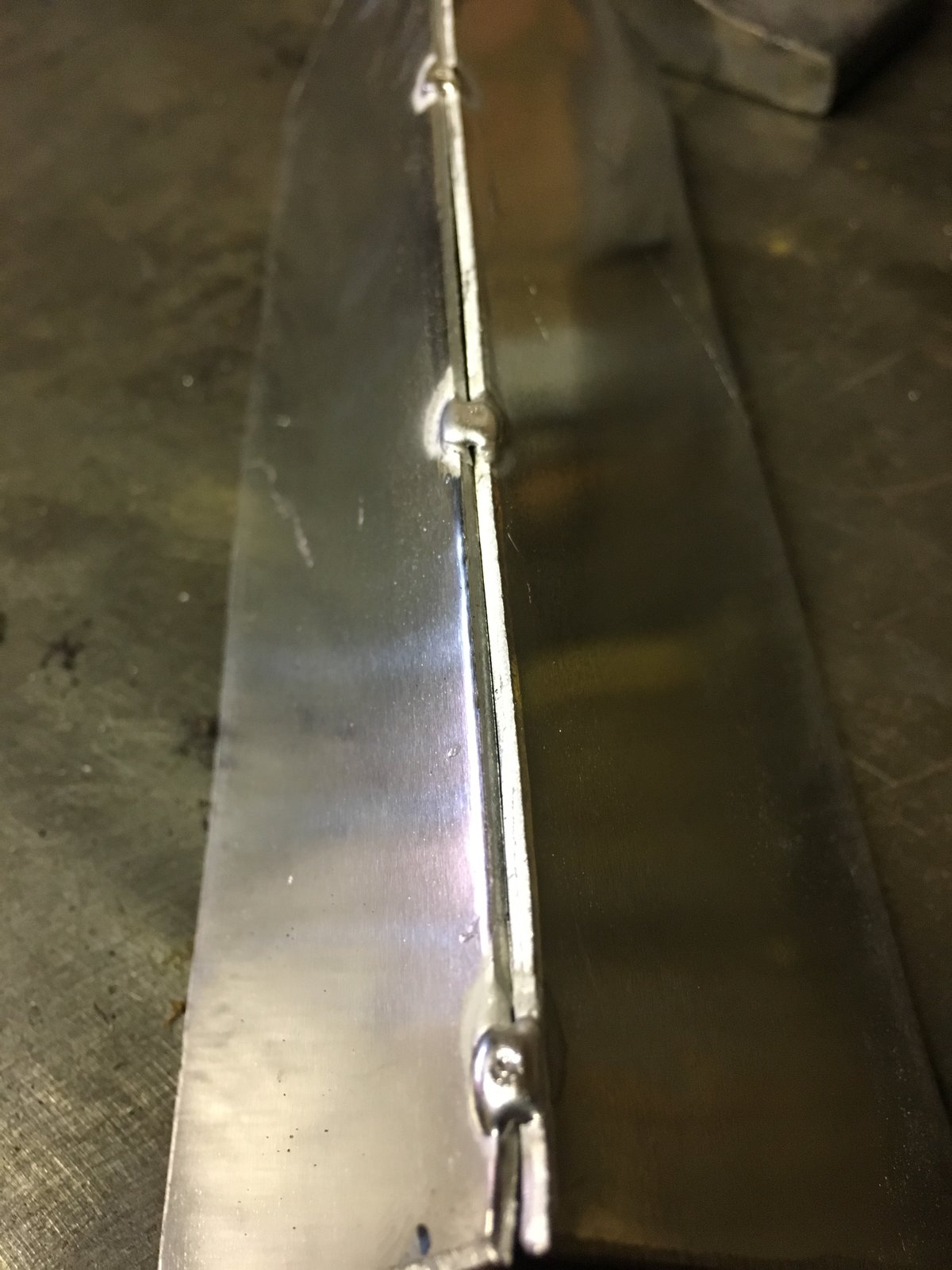

I had similar problems (still haven't mastered it...this thread is making me want to go to the workshop now!). Was advised in another thread to go about 25-50% hotter than you weld at when tacking so you get an instant pool, rather than taking ages and heating everything up too much.
