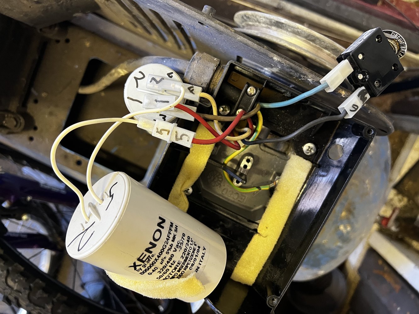

Much more basic than that. AC voltage is measured as the root mean square of voltage, as it alternates. It is the equivalent of a DC voltage wrt Ohm’s Law and resistive loads.
That means the peak voltage of a UK 230V supply will be ~360 volts - not allowing for any spikes above the normal range. Some capacitors supplied may only have an overload of a few %. 450V rating is a fair measure for longevity versus cost, but higher voltage rating is not unknown on high quality kit.
The above post, which quotes a lower voltage is flawed - because the UK AC voltage can be + 10%, of the nominal figure. Obviously there are a lot that don’t know the actual range we can be supplied with, from

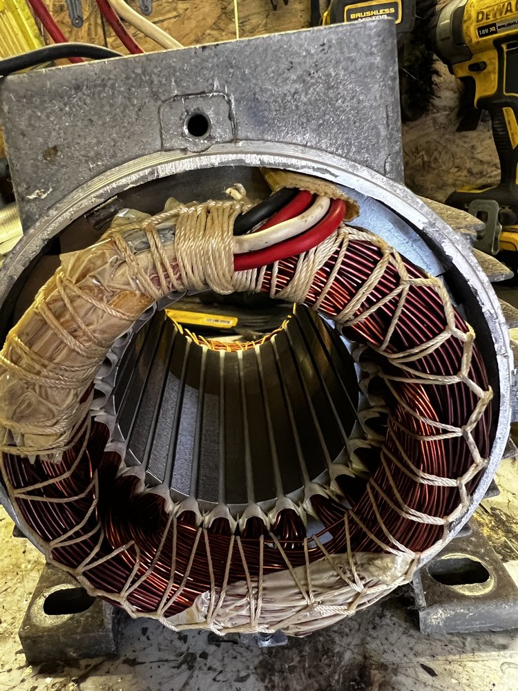

Just tried this , looking like the motor is goosedBypass the pressure switch you mean ?
