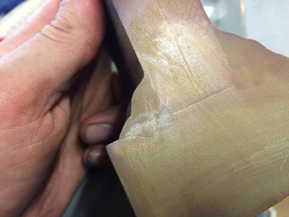

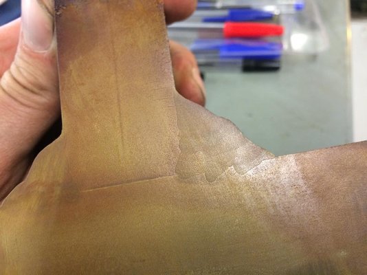

Good...........the welds look very different thats all.........I wondered if that was causing it.Pushing
