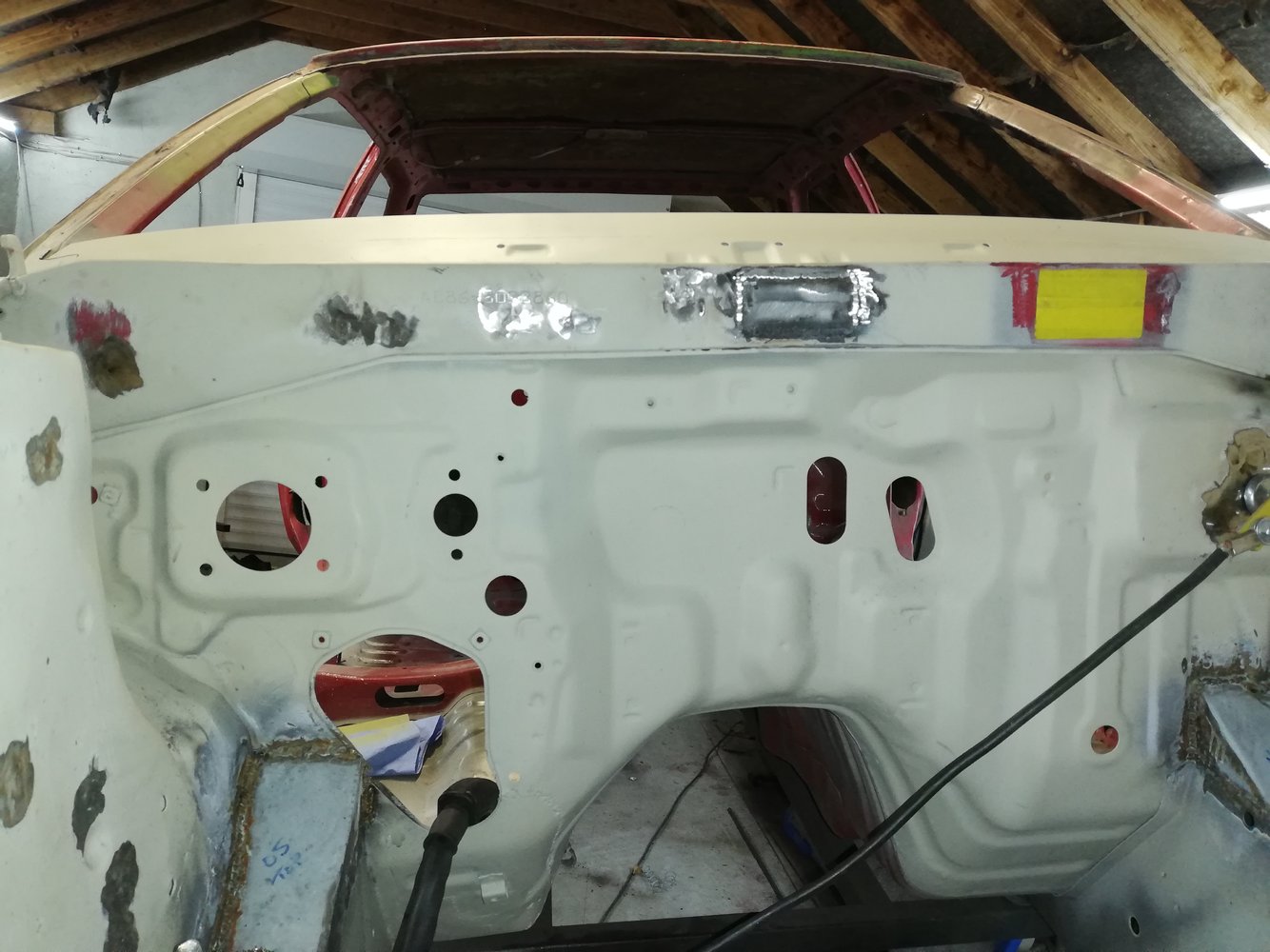

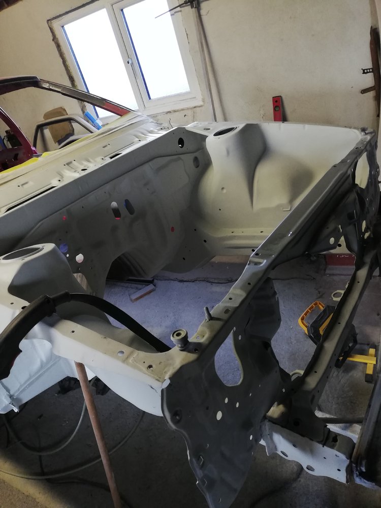

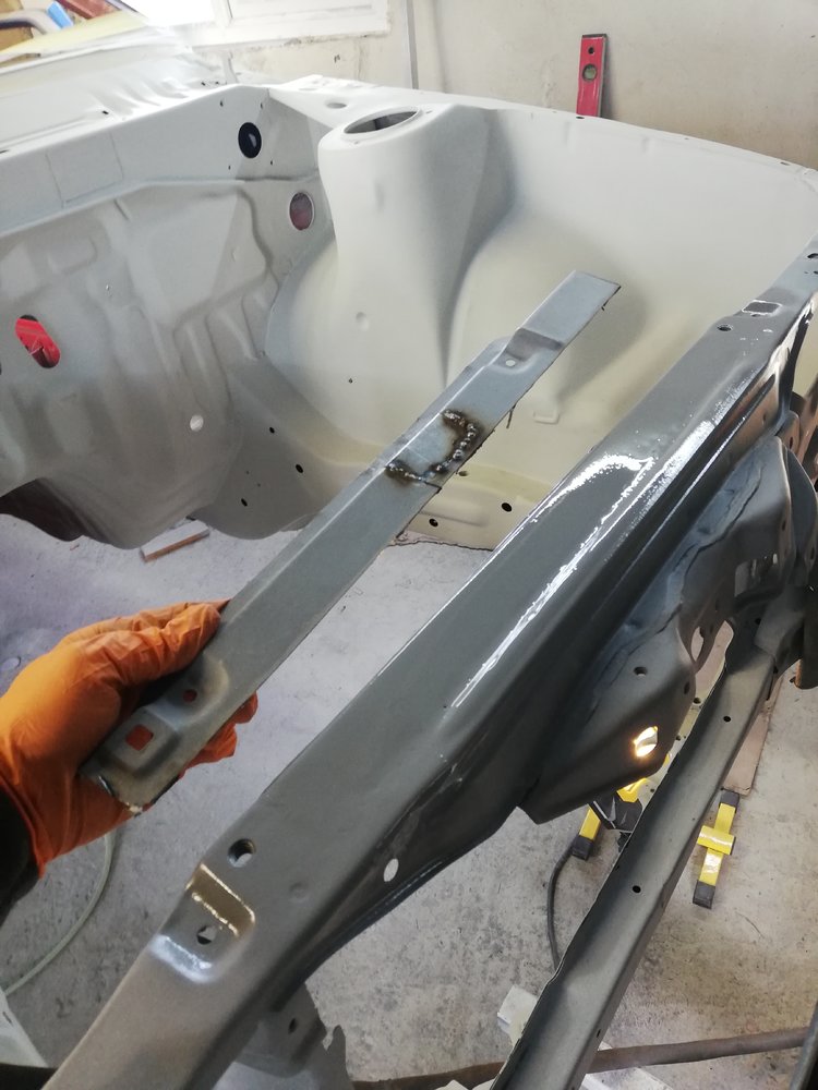

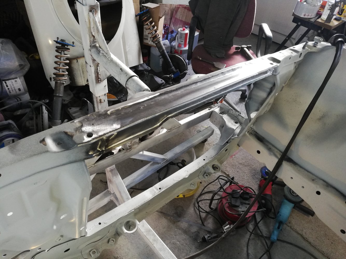

I plan to use it on the subframe, axle, and suspension components... Possibly the underside tooAre you going to out the em121 over the primer you've sprayed or somewhere else? I found it only stuck to bare metal so just asking as you're the bay sprayed.

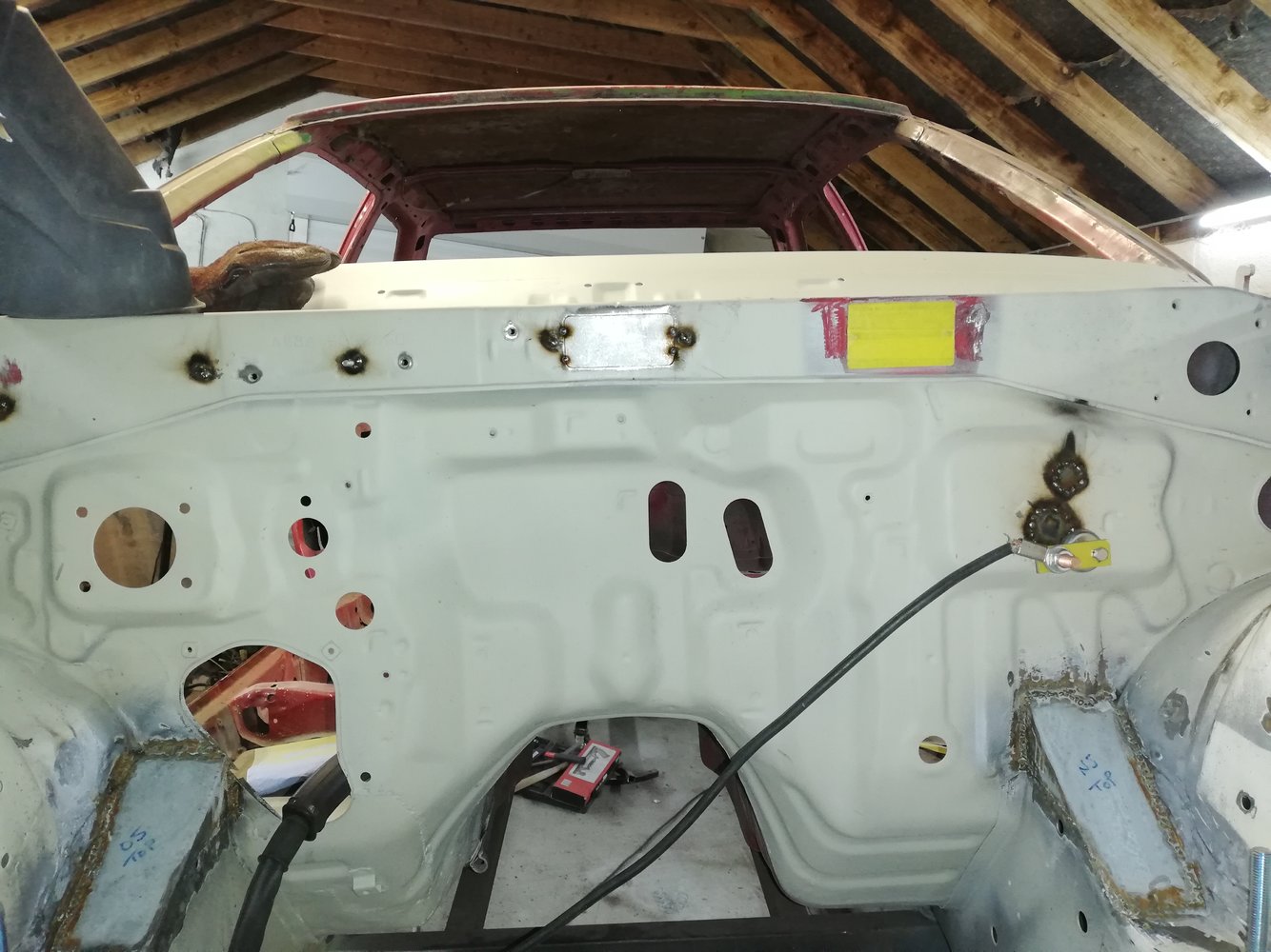

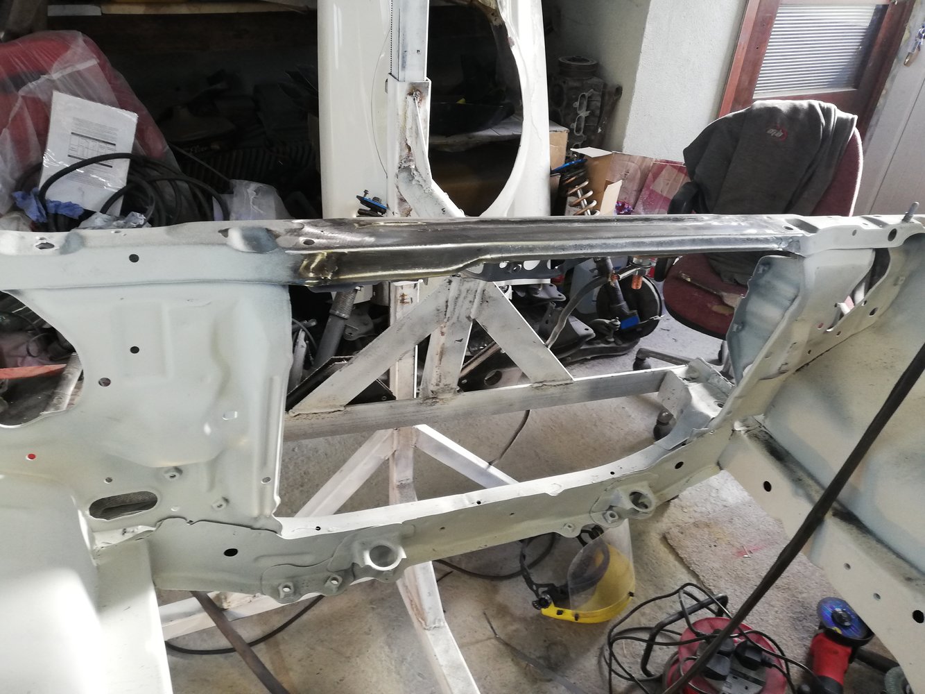

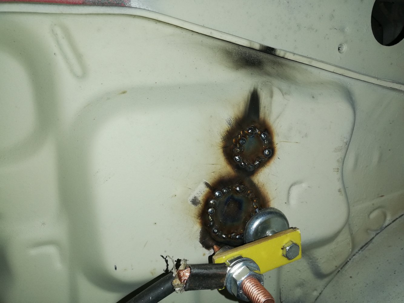

...the magnet/earth clamp? I got it off Wish lol, comes in handy except when you unknowingly nudge it onto a painted surface and can't understand why you're not getting any arcI really can't get over how well it looks just with a bit of primer and sanding.
Also what's the name of the do-dad that lets you earth on car and not have to use the clamp?

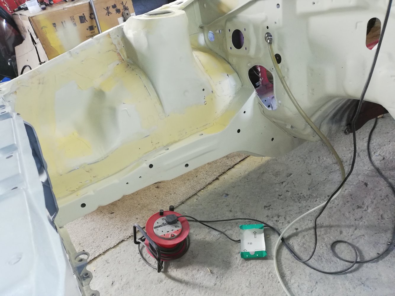

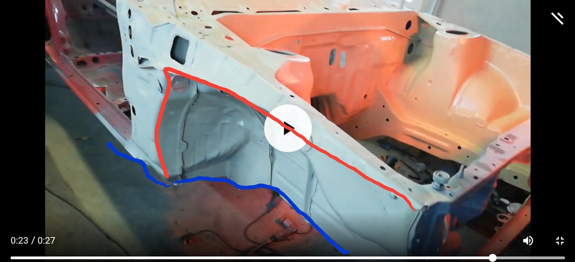

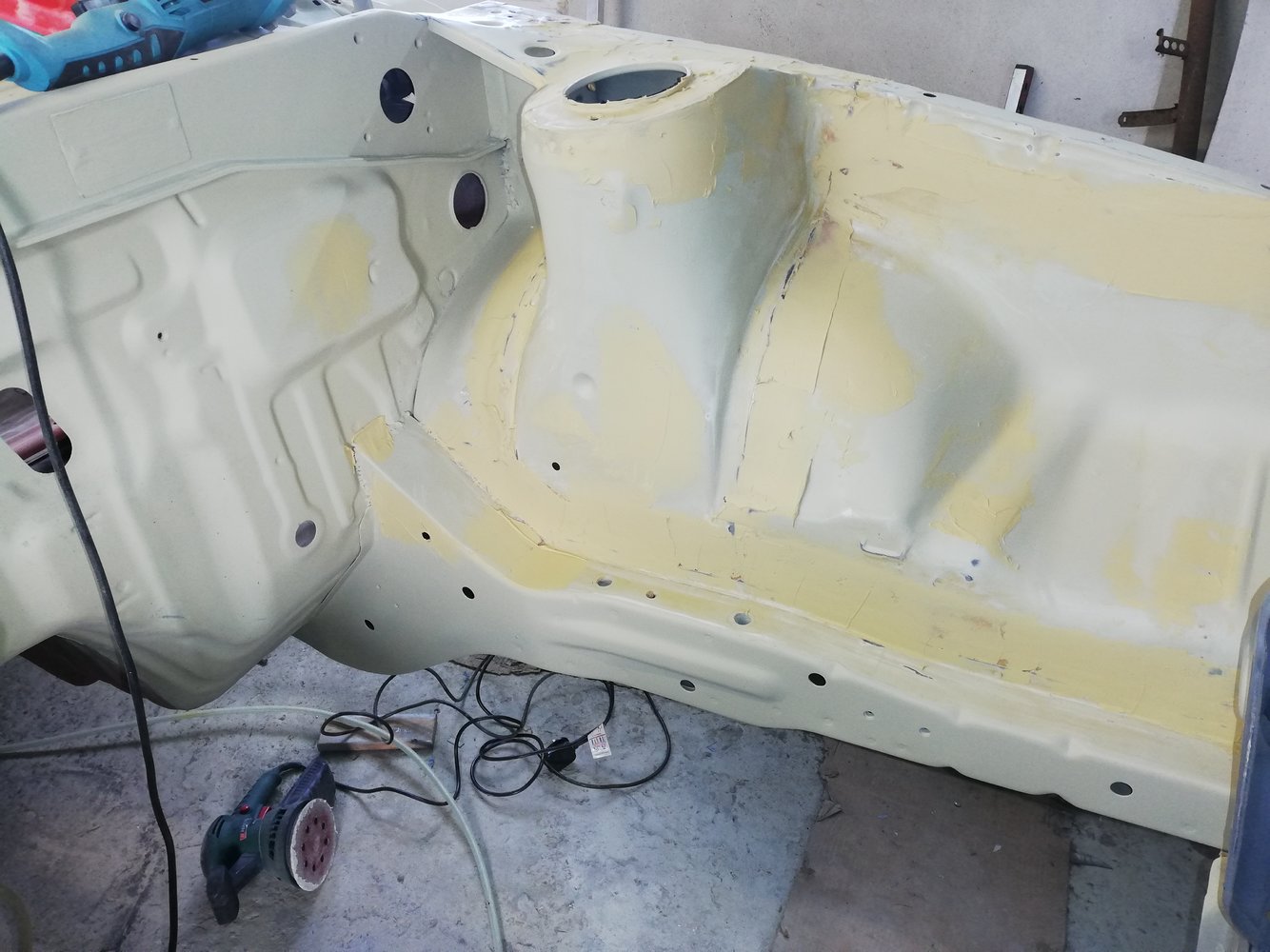

I guess it'd be personal preference... Are you using liners? If so epoxy 2k primer would probably suffice...Question for ya.... When you're doing mastic on the frame do you stop on the blue line or run it up to the red line

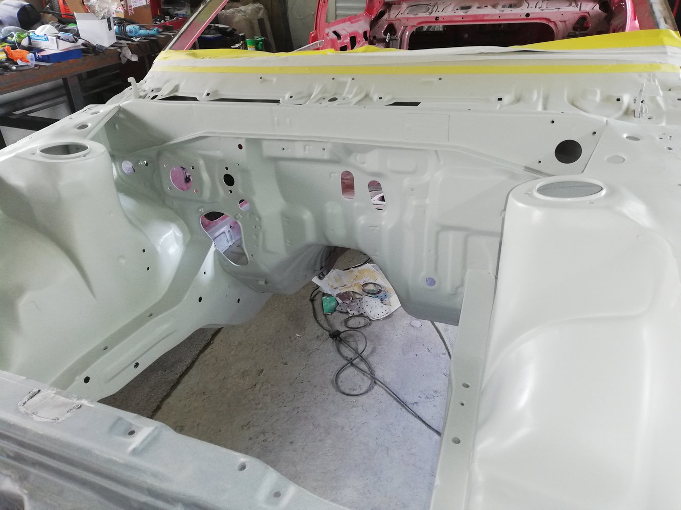

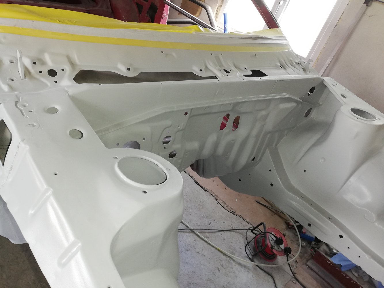

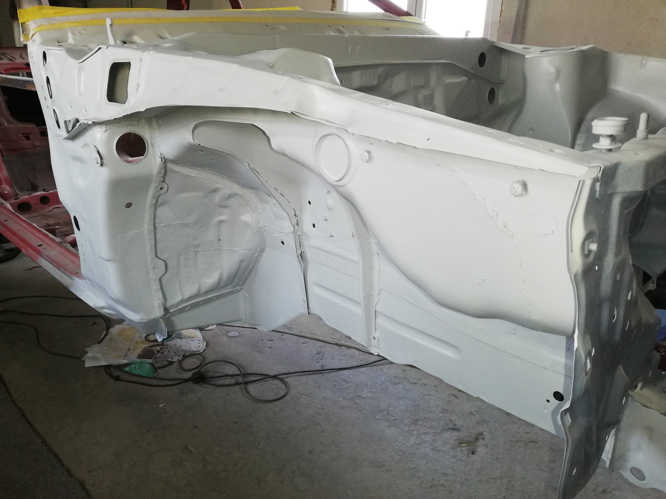

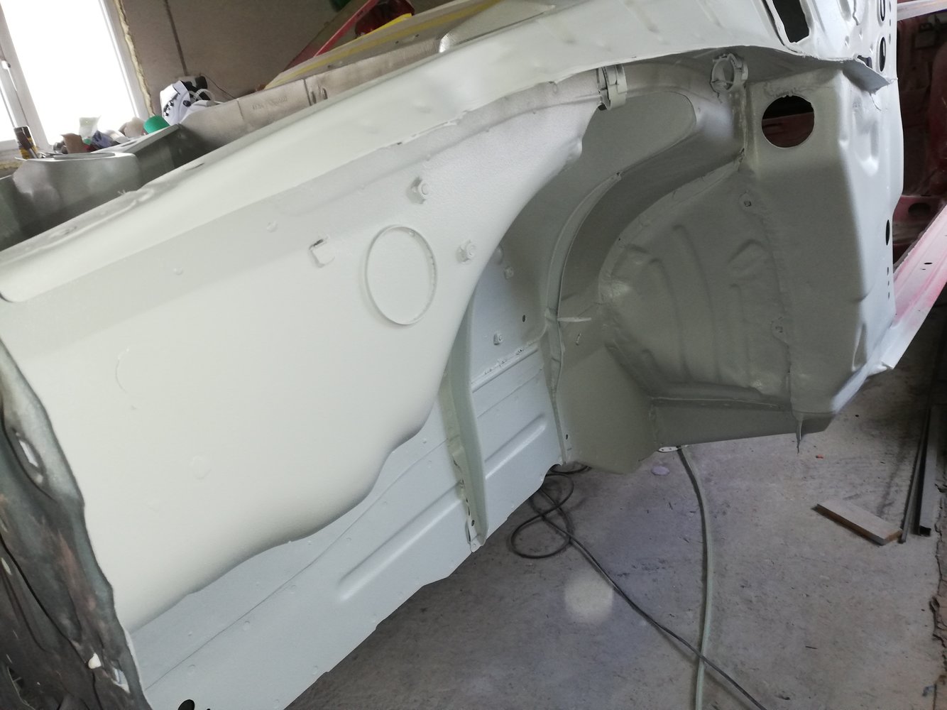

Is that a spray on job or brushed on Myles? I really can't get over how well it looks.
In fairness I only have one of those electric sprayers for 60 quid so you have to me working with way better tools. The 2K for the suspension has been good and in fairness I've been spraying onto mastic not primer so the surface is a bit harder to work but I'd be tempted to try use it for priming just to get the car looking reasonable on some level before it got sprayed elsewhere im not thinking of doing any external pannels but wheel arches and the like might be okay..... Maybe..... Probably not.
Depends who you ask... I sealed with 2k epoxy primer to preserve the steel, then filler, then a high solids 2k epoxy primer to seal againSo you filler before primer or primer before filler?
