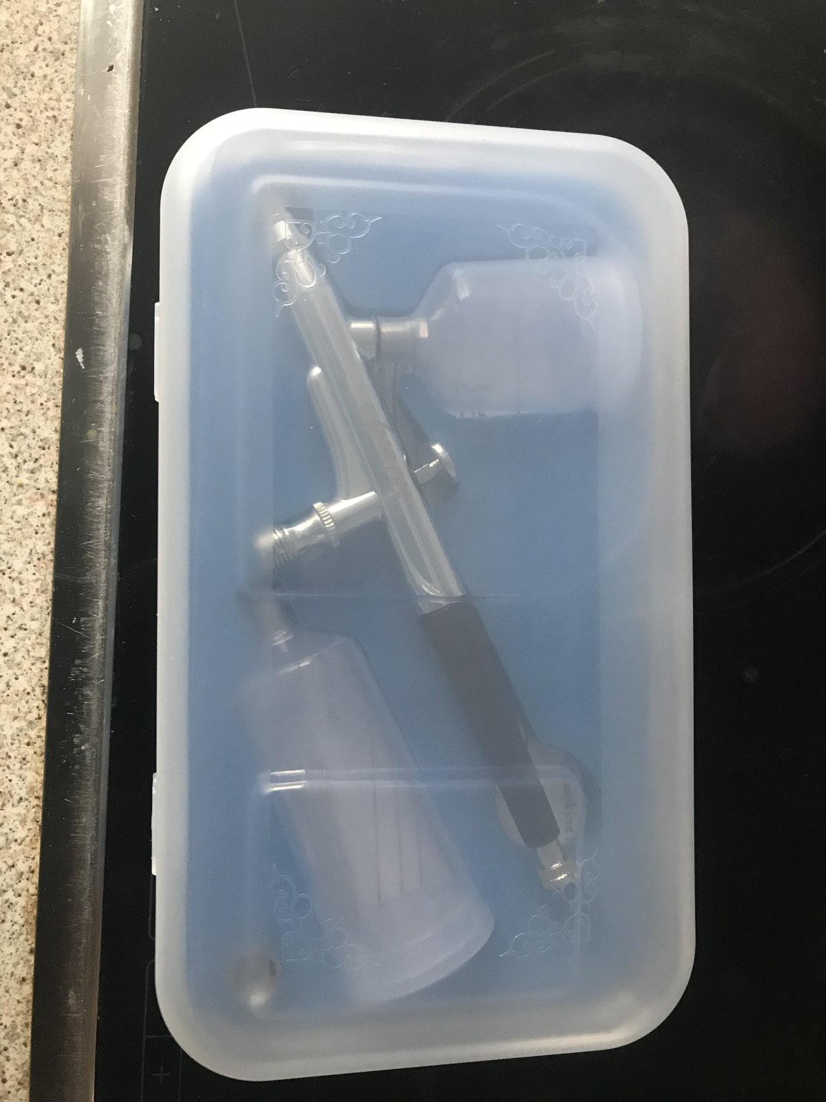

with the issue of reservoir capacity, I've just ordered one of these
https://www.ebay.co.uk/itm/223989643274
with 20cc and 40cc paint cups, that should do me fine.

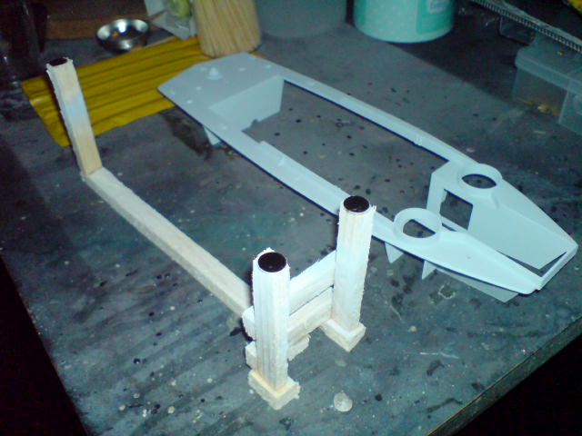

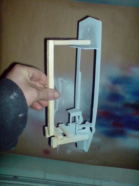

but with one of the models Im making I was thinking about how to hold it so I could paint it as its quite delicate and most of the part needs to be painted, so my solution was to superglue a frame together from the strips of wood I get as packaging on small diameter metal bars and use rare earth magnets to stick it to the part being painted.
its easy to remove to do other work on the part of the boat.

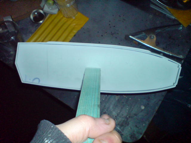

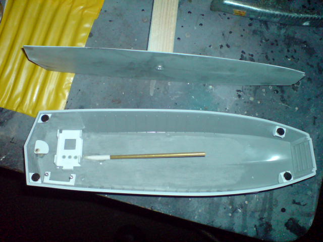

I always planned to mount the deck to the boat with magnets (in different positions) so for painting the hull, it was a case of making a metal plate to mask the inside

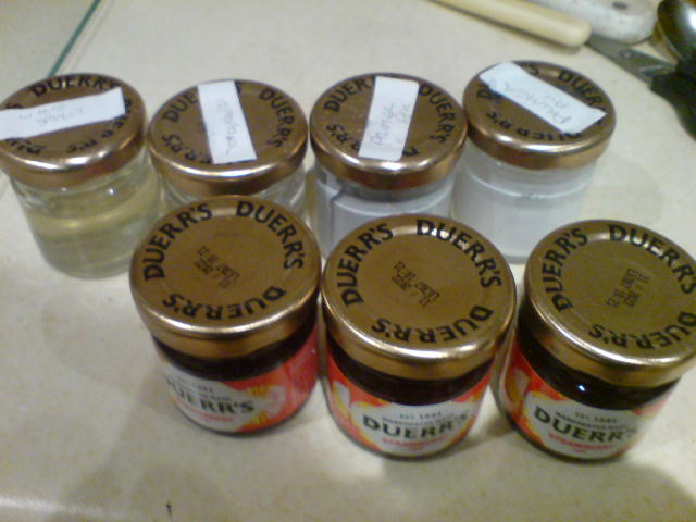

and you can get small glass jars (41ml) from wilko for storing small quantities of mixed paint in.
https://www.wilko.com/en-uk/wilko-mini-glass-jar-20-pack/p/0453106
unfortunatley my local one had sold out, so I ended up getting jars of jam and marmalade from Home Bargains for 25p a jar.
