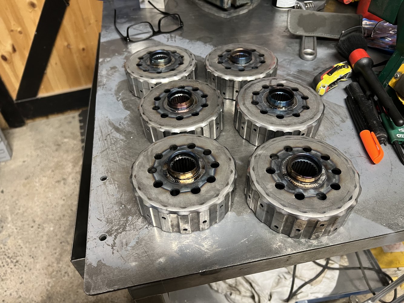

What are they?Make 3 times more money on jobs like these I just finished. Repairing the failed work of laser robots!View attachment 388258

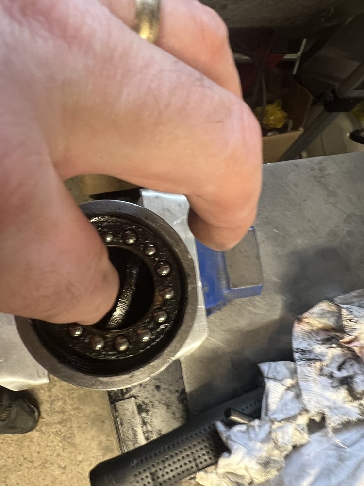

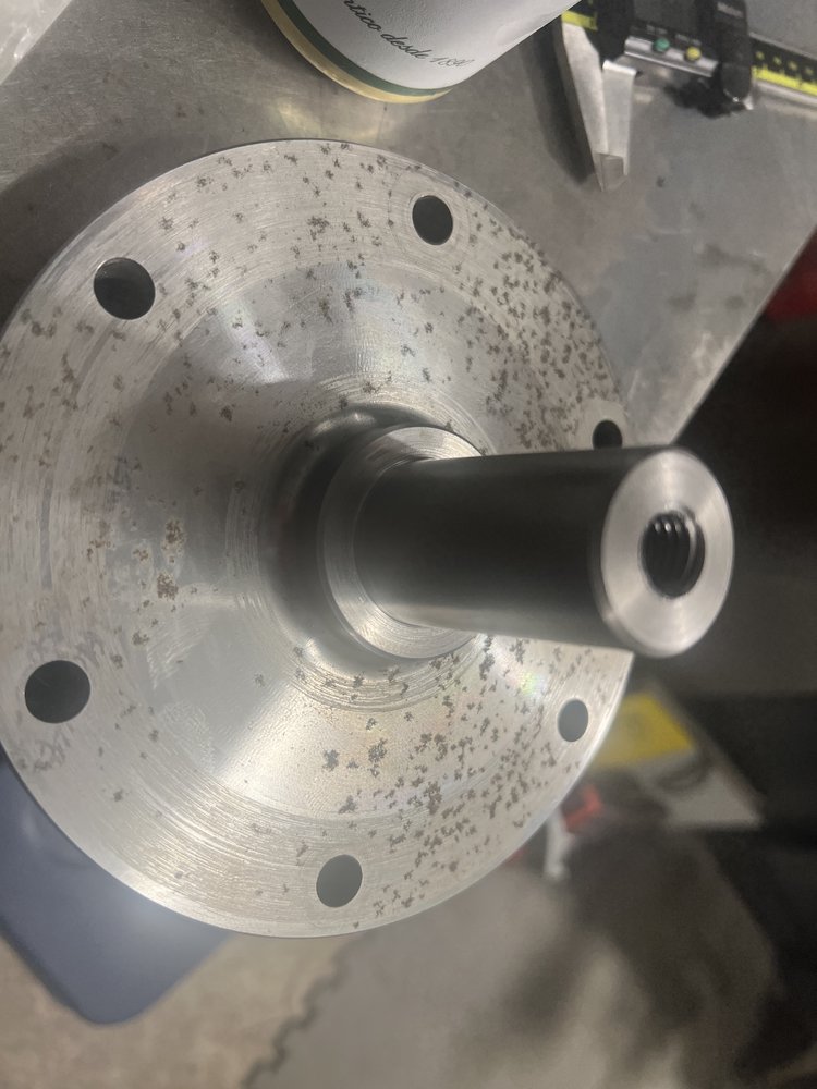

Now, I'm glad, that i have a TOS FN22, with curved bevel gear, and roller bearings on the vertical spindle..Started milling up my repeat o meter base and noticed the run out on cutter was horrendous (see it by eye). When measured there was 0.15mm run out inside er32 collet chuck. It is some cheap rubbish but knew it couldn’t be that bad.
Further checking shows around 0.05 and more on the spindle.

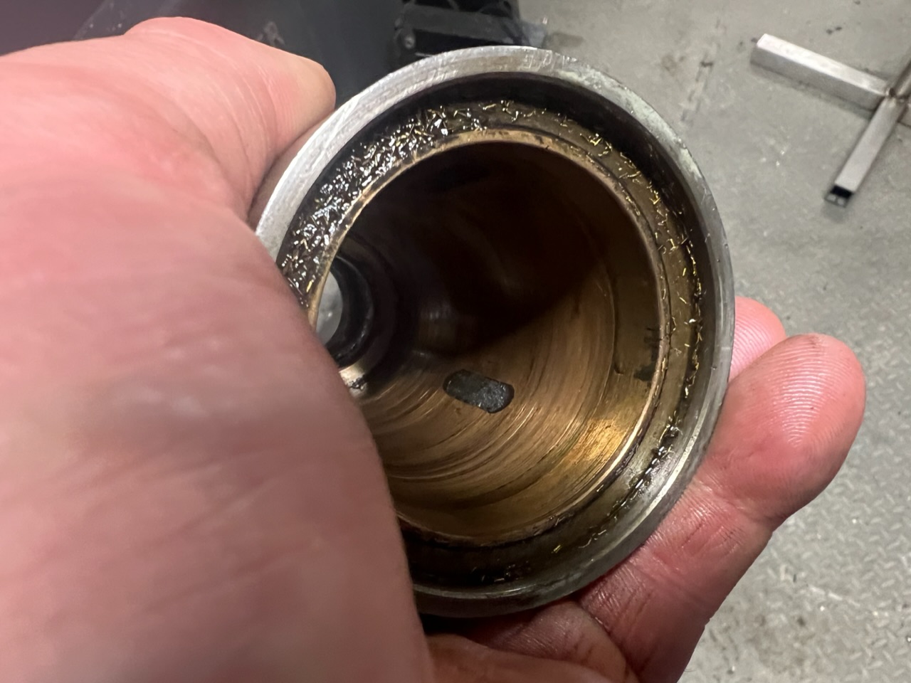

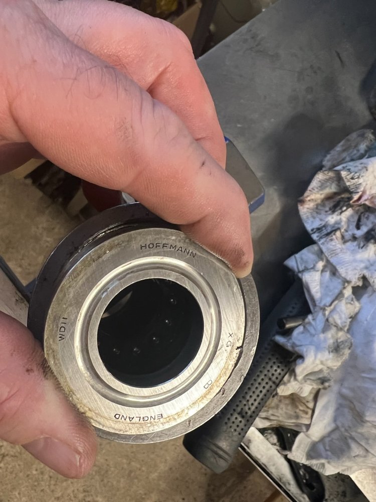

I have stripped it down and can see spindle must have ran with too much play for a while as the first 10-15mm of nose in tapered bronze bearing is worn more than rest.
There are depressions and wear but rest looks OK.

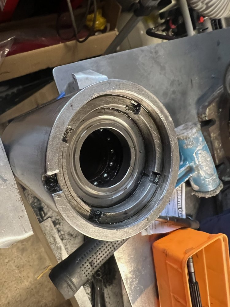

I’m a bit confused by the oiling system as it has felt pads in bush and felt washer on top of bearing stack but look how the oil has to get to all that!
I assume you are meant to have spindle fully retracted so the hole squirts over felt washer.
Have it all stripped and ready to inspect now. I also realised the little bearing preload nuts are left hand thread before stripping them, so there’s a good end to day
I think being so worn it would make sense to chuck this up in lathe somehow and skim cut before scraping the bronze back in (assuming there is enough meat left).
I want to get a high speed head for this thing so don’t have to listen to scream of all the straight cut gears so maybe this is a sign.
Didn’t plan on bearing scraping but here’s to another skill to learn!

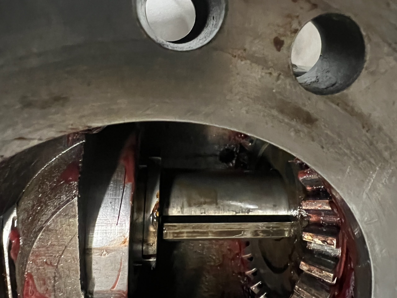

The machine will deliver 1900RPM with the vertical head but sounds like an air raid siren! Its a mixture of vertical head and the straight cut gear that runs everything.Now, I'm glad, that i have a TOS FN22, with curved bevel gear, and roller bearings on the vertical spindle..
What is the max RPM that yout machine can deliver? How much is the noise with this gear setup?
Maybe you can shim the vertical gear to achieve a minimal tooth clearance to make it less noisy.
They are clutch baskets that the laser weld fails onWhat are they?

thought they looked clutch relatedThey are clutch baskets that the laser weld fails on

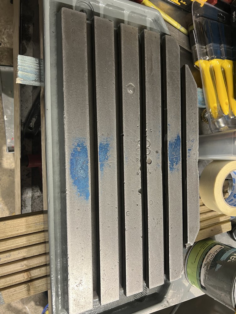

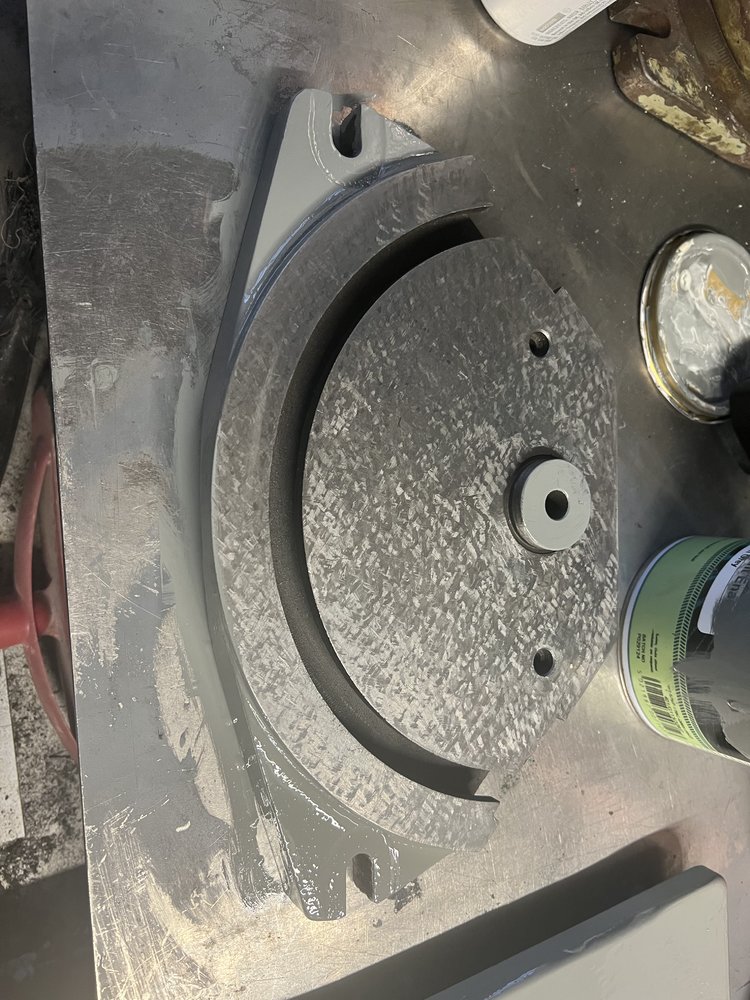

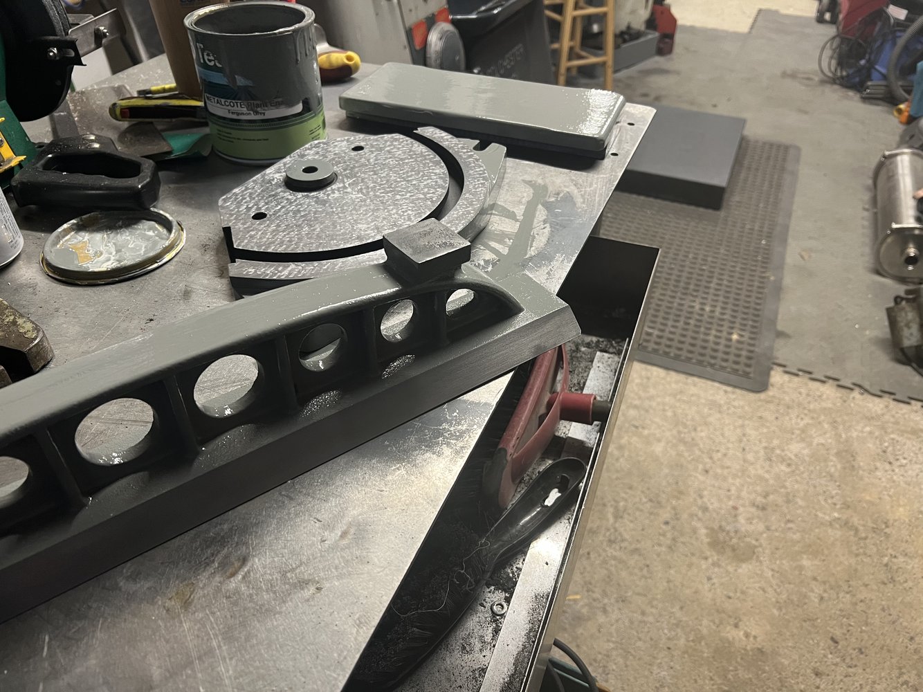

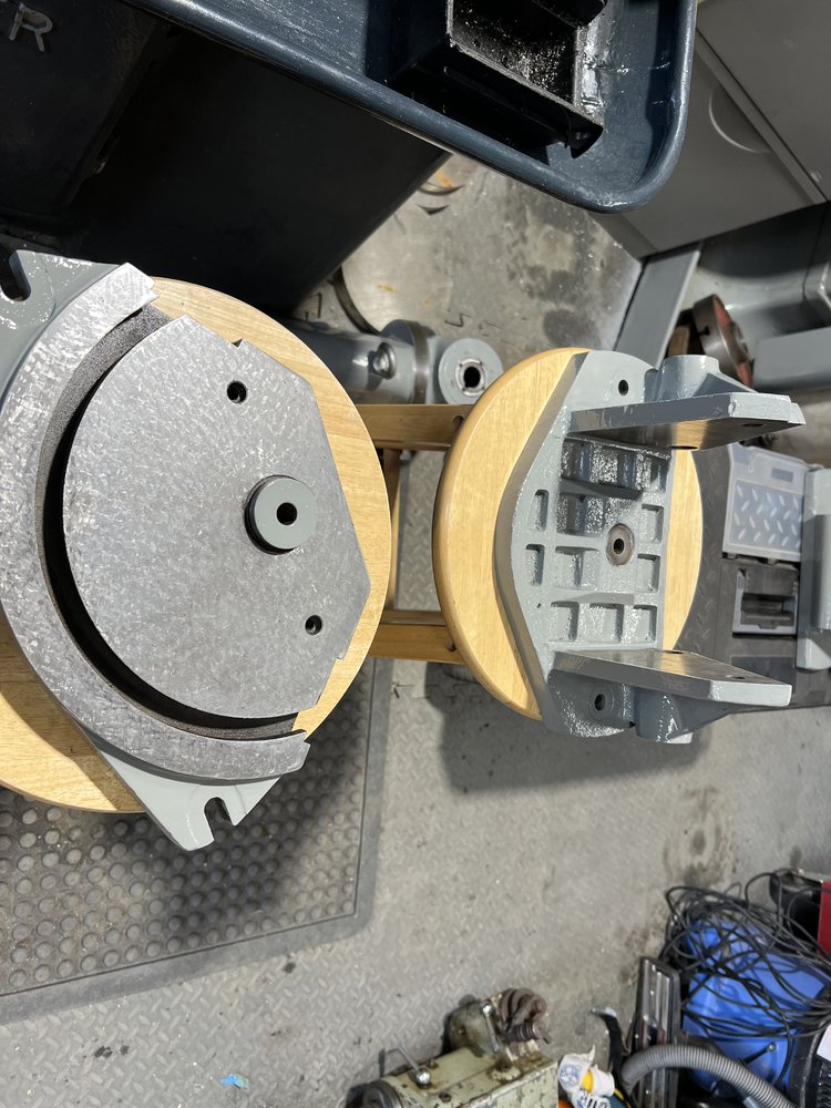

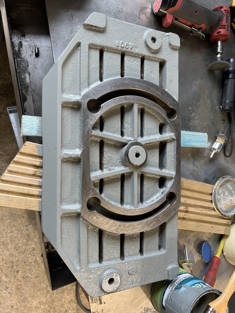

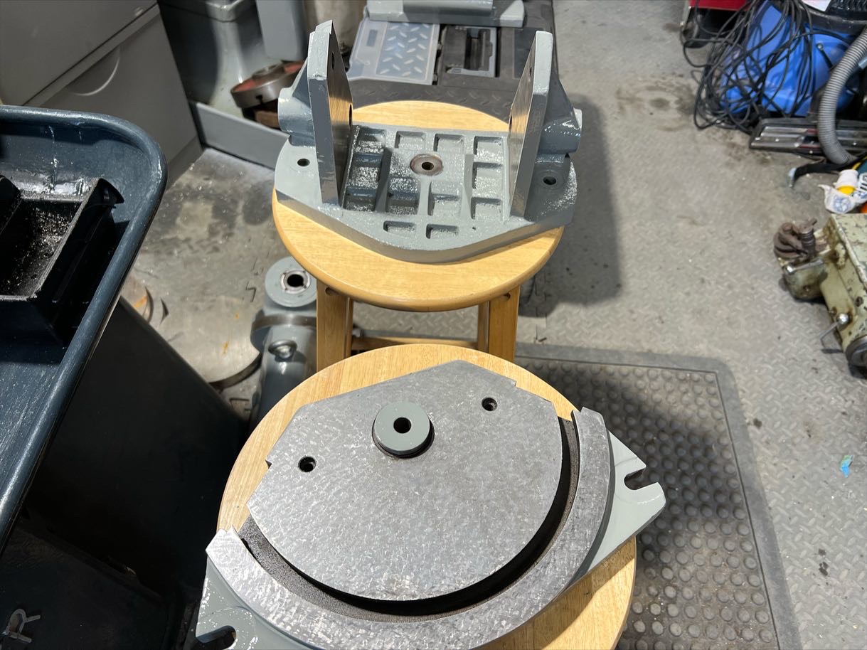

Work on the table continues today as I’m on @pressbrake1 scraping course and brought some bits to work on.
I will do a detailed write up on my experience once finished but I will say for now, if you have anything that matters to scrape take the course!

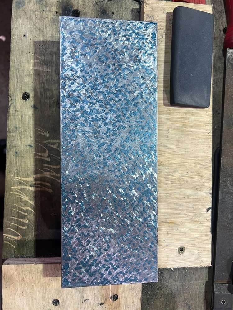

Little test piece that will no doubt serve for years to come
I had completely butchered this earlier in day so even a webbed fingered, hamfisted, spanner spinning farmer can be helped
Thanks Pete, I got a little lucky with that one but I’ll take it as the next side was a complete pain in the backsideThat is nice point spotting. Well done
