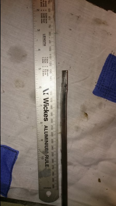

They are usually made of ductile CI, Meehanite if you can source some easily. Any old iron will do the job if you can find something close enough in size to cut up and have someone grind for you.Got the top slide in bits now. Unfortunately the gib strip has a kink in at the tool post end, so I think it will need a new one. Anyone know what sort of steel they are usually made from?
I guess that you will be a busy man with this job Scott. Images of what you have, what you have had worked on and what you have assembled are appreciated and valued by people owning machine tools of the vintage sort.Thanks Ian, I have sourced a good used gib along with a few other parts. The bulk of the machine is away to get re ground and I'm now in the process of gather the parts I require.

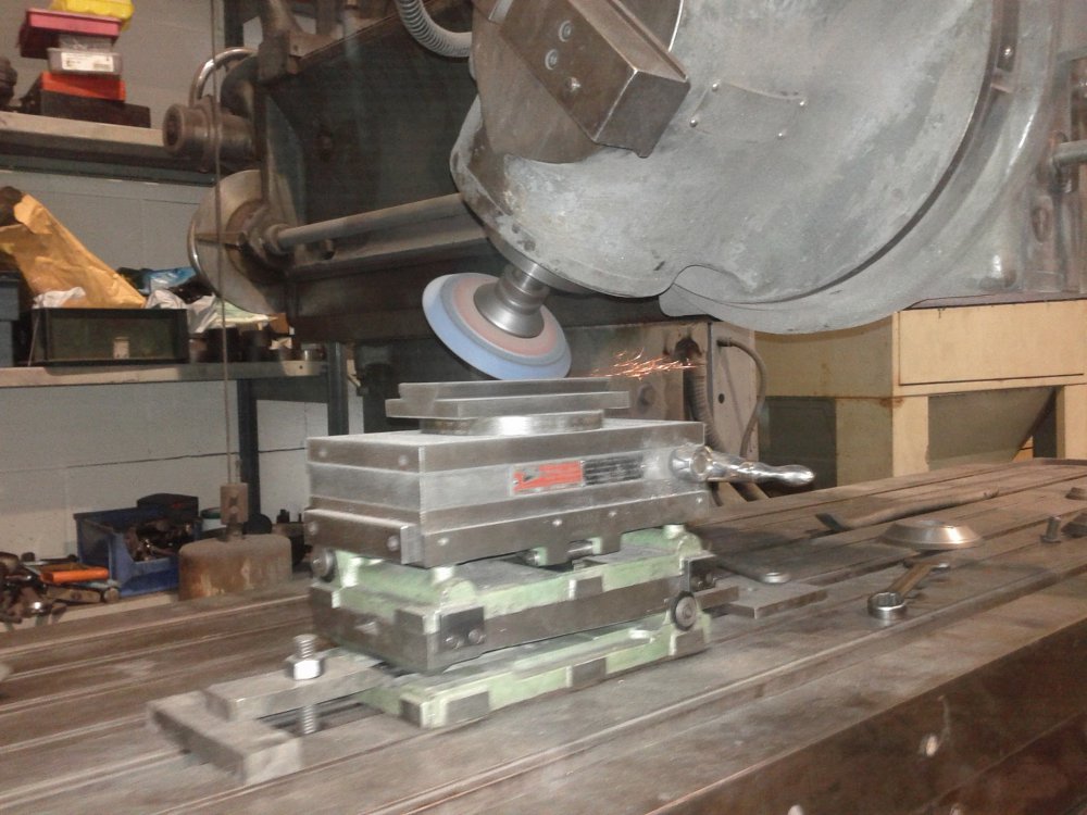

...grinding is being done by Brian at Slideway Services.
It's hard to tell on a phone, but is that mag base on a compound sine table? I'd love to look around his workshop.He uses really really big grinders, topslide for a M300 been cut, to give you the scale, that picture was taken in his old shop down the road, from where he is now. One of his machines was from Bridgeport in Bridlington, one of only two in the world.
