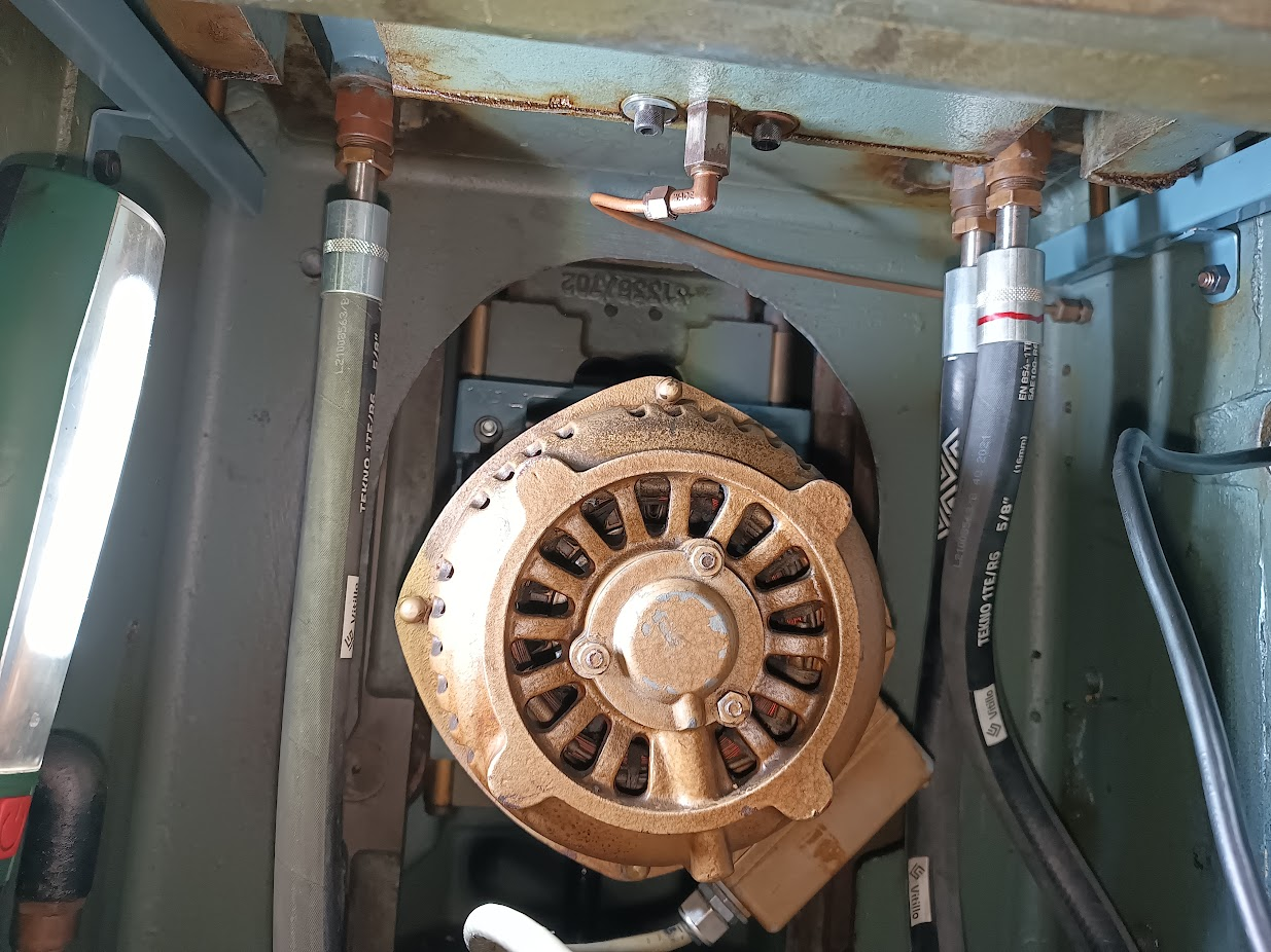

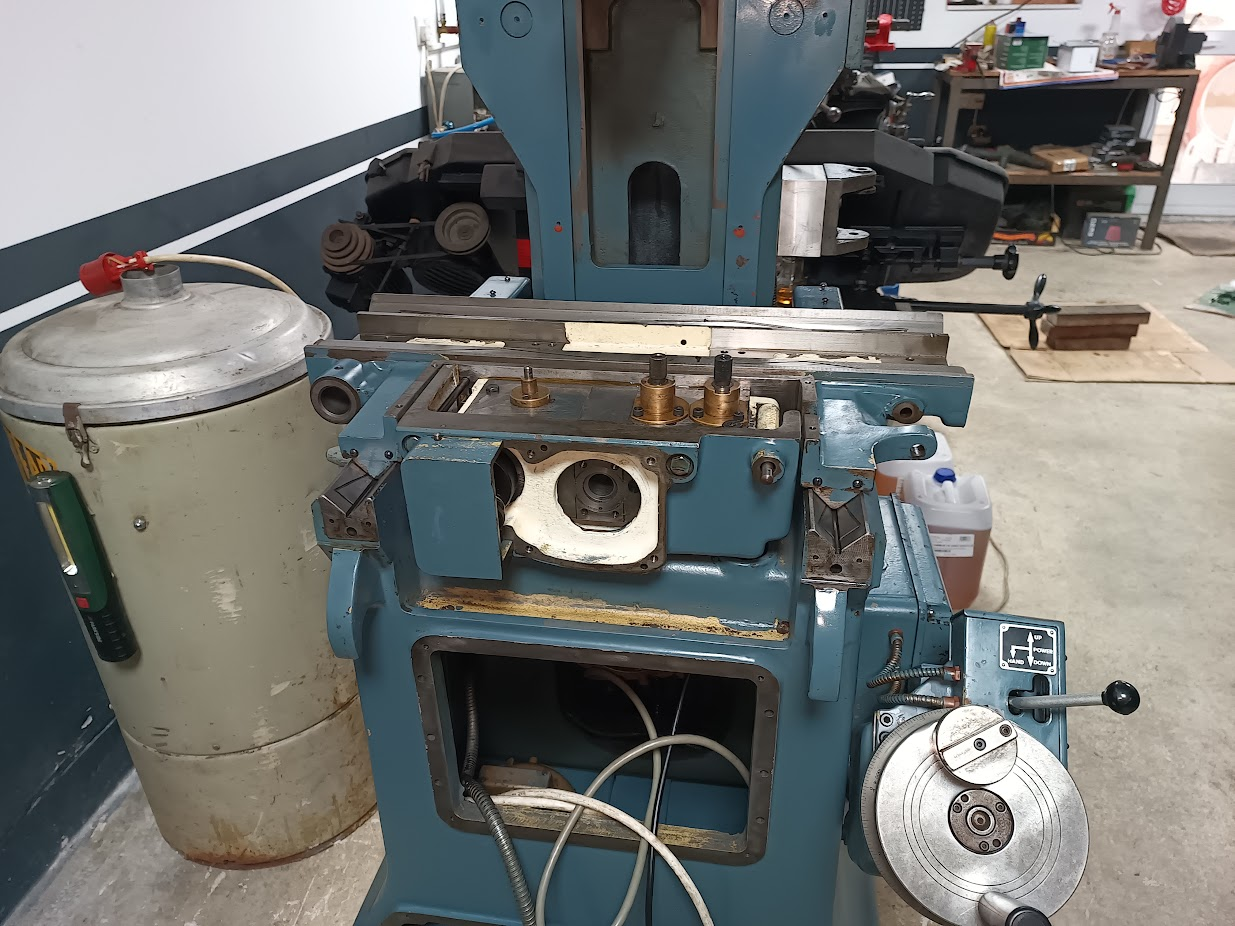

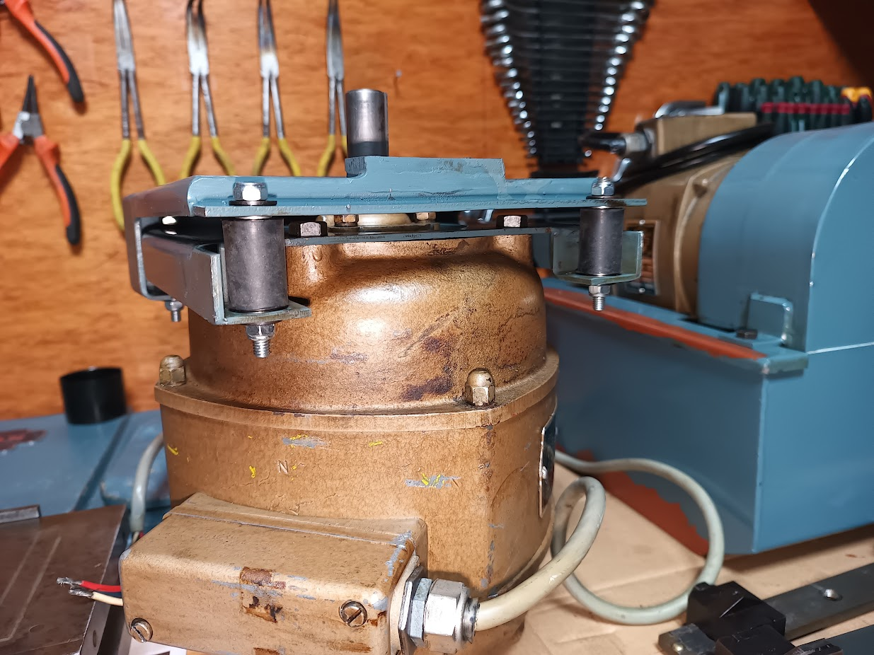

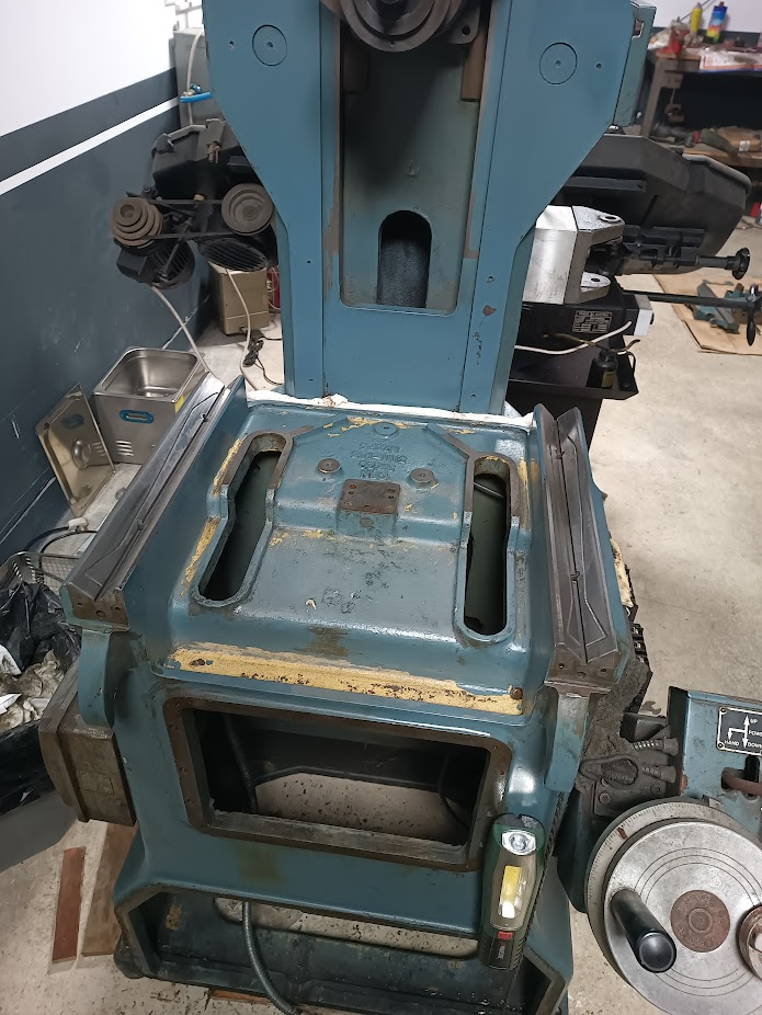

How does that coolant tank work exactly?Took some more photos of the dust collector:
View attachment 460756 View attachment 460757

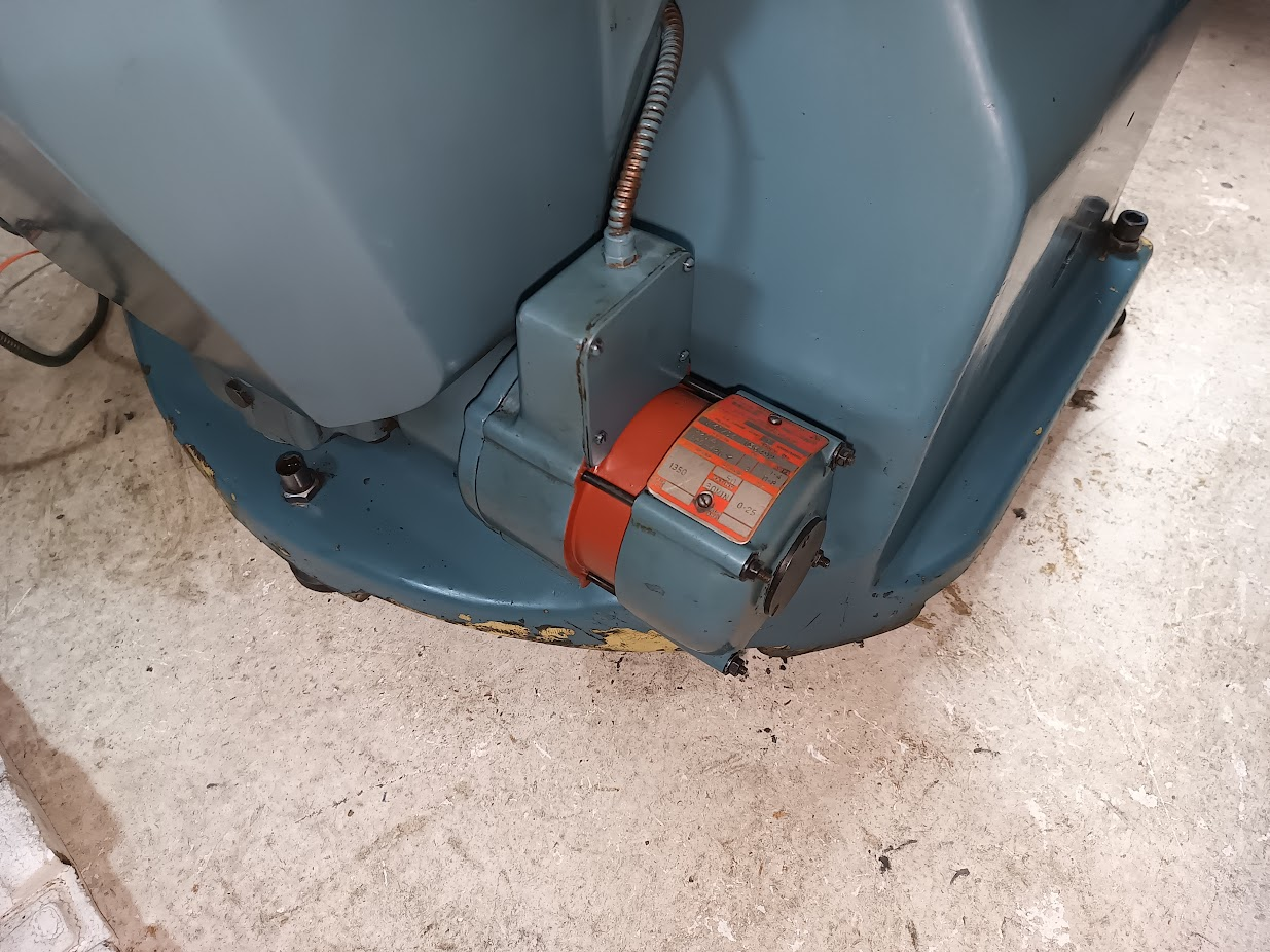

Not much to see on that - seems to have a bag of some sort inside and and impellor with a 0.5Hp brooks gryphon motor:

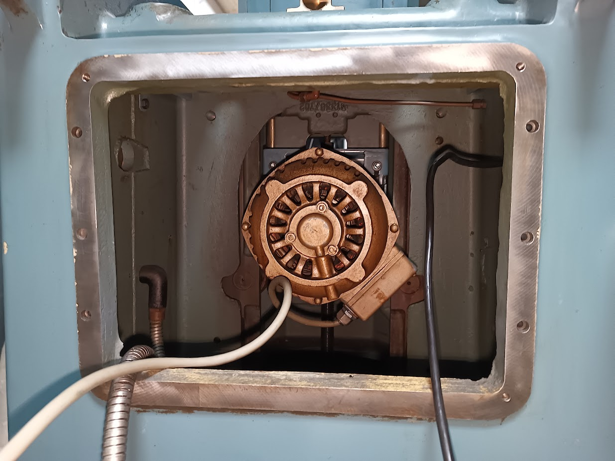

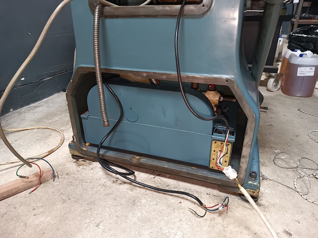

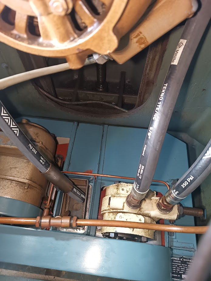

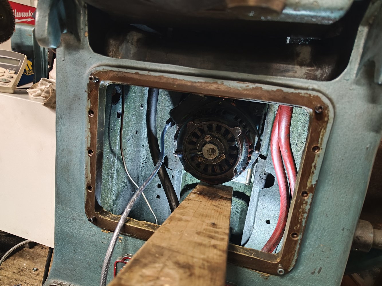

And some more photos of the coolant tank - this is the back side (back panel is off because I was trying to see how it was wired up)
The coolant tank has the J&S tag (albeit very faded and worn out):

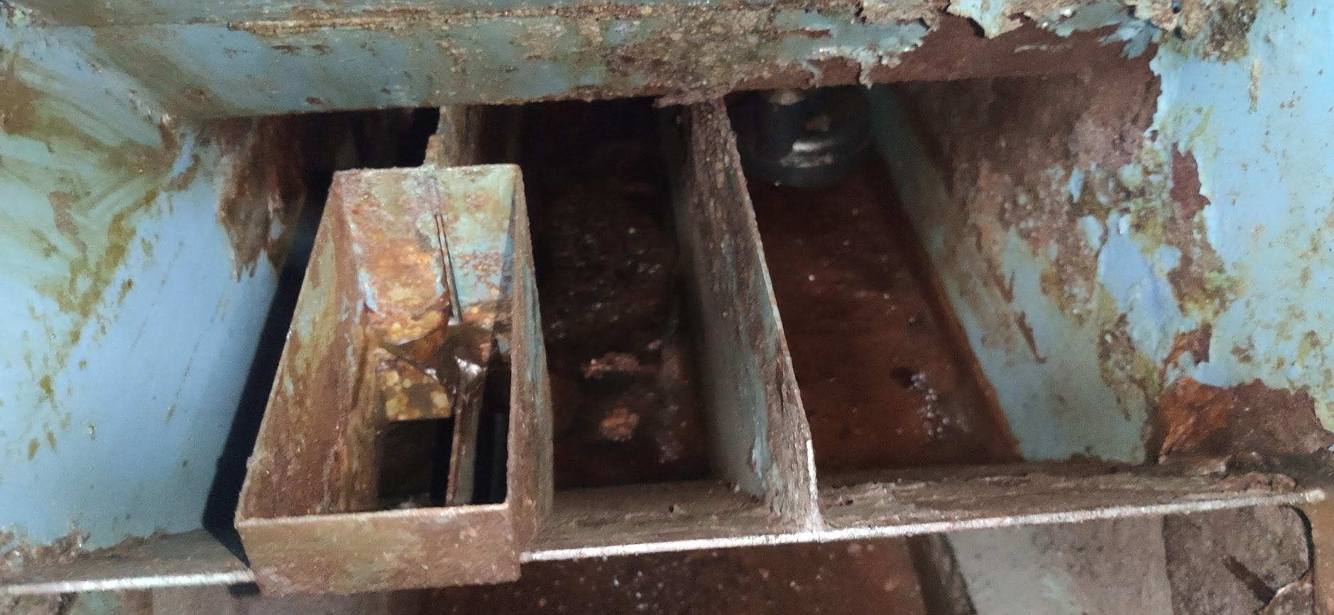

Front side:
View attachment 460763 View attachment 460764
This is going to require some deep cleaning - not really looking forward to this... most probably will keep it for last
I assume the 'compartments' are used as 'settling ponds' to keep the coolant as grit free as possible.
I need to make something up so I can run coolant on my SG.
I am pretty sure I have a coolant tank from a lathe (possibly Colchester) which I am planning to use on my SG as I can't seem to get good results grinding dry.
Besides, everything I have read so far suggests that coolant is the best wat forward on a SG. It keeps the dust down, removes the problem of parts getting hot while grinding and produces a much better surface finish. Some people even suggests that coolant makes a lot less mess compared to grinding dry...
