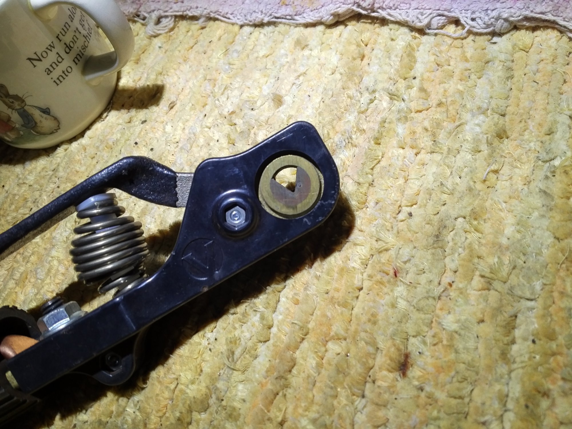

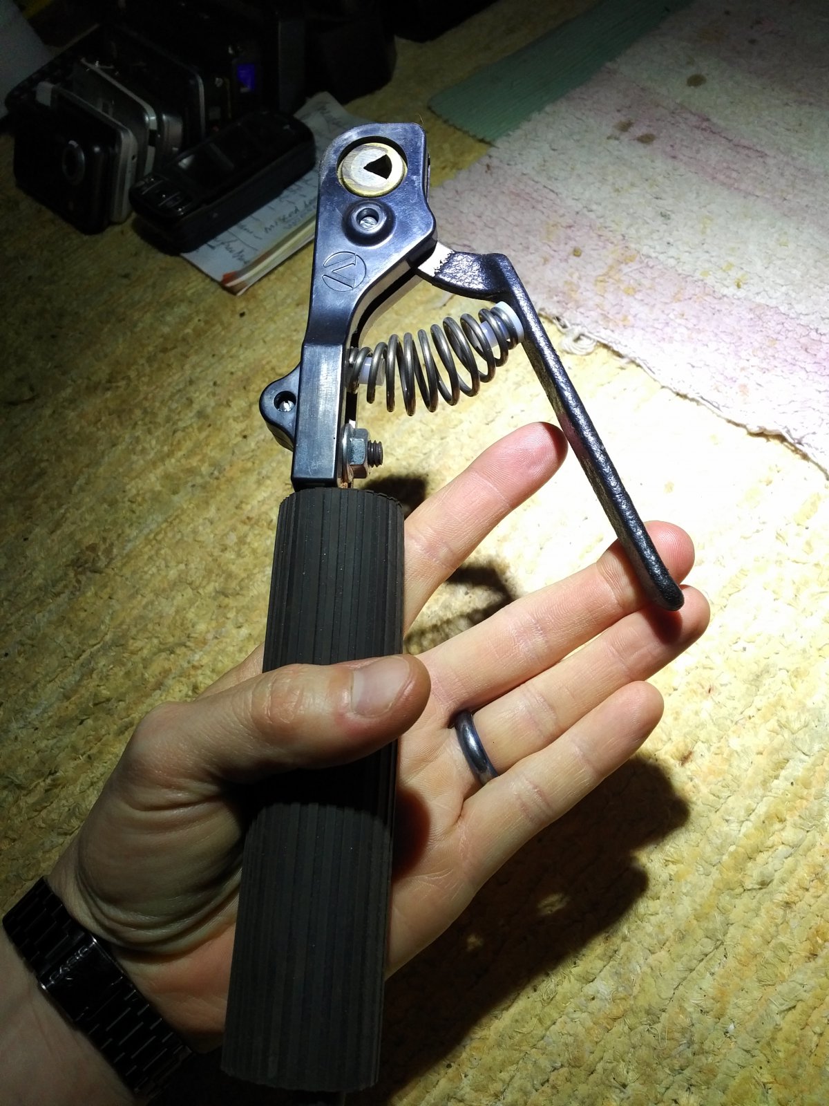

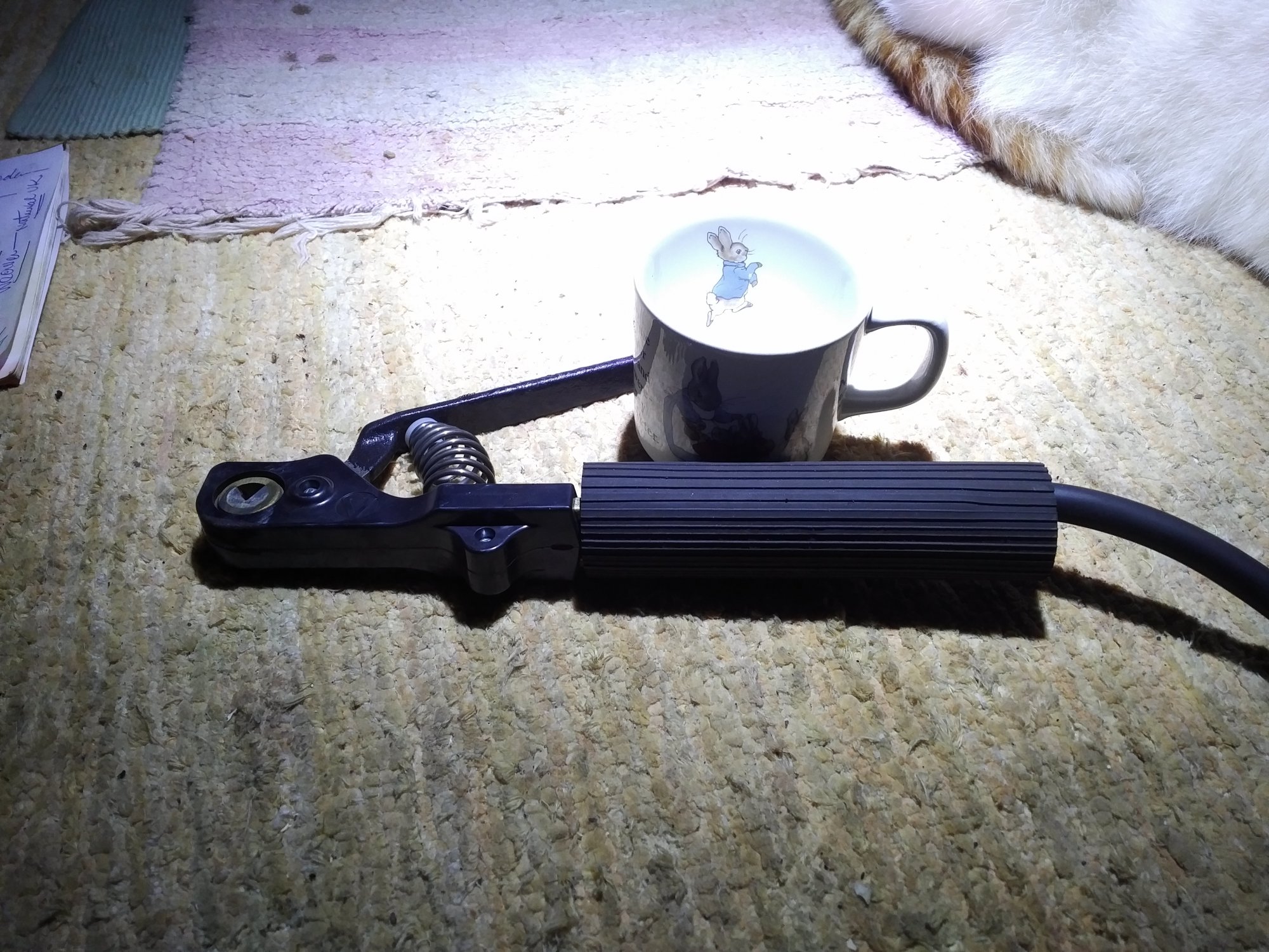

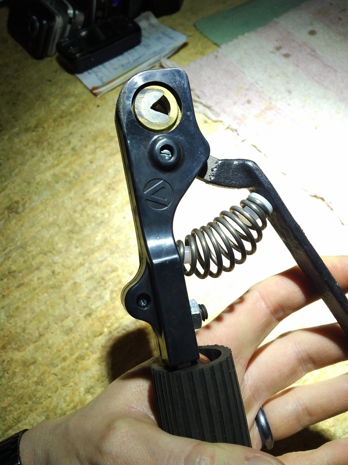

That's exactly what it is. For the earth clamps.Unless...... thinking about it there is a lug on the return of those daft crocodile clamp things.
He may need a crimp if using those.
???I smell something rotten here.
That's how I done the last one, looks horrible.You will need a crimped lug to connect to most crocodile clamps.
Some 600 amp screw type clamps terminate with a grub screw, but mostly with a bolt.
You can buy knock on lugs which you smash onto the cable with a hammer (I hate them, they offend me) or the bolt on type where the lug has two halves that clamp together round the cable.

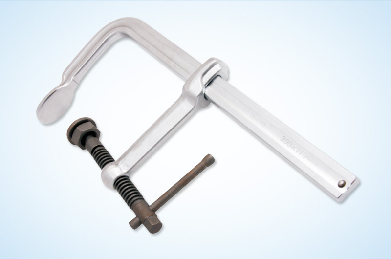

Our Lorch sets (500 Amp) came with earth clamps same as these F clamps with a hole drilled in the end and the cable bolted to it with a decent lug. The cables are a bit frayed around the lugs and need making off again, but they are the only earth clamps that have gone the distance. I don't know if that is a Lorch standard or not.
Some of the cheapy croc clamps don't last the week and the more expensive 'brass'/zinc coated steel (?) loose their grip and the jaws bend apart then eventually explode into a million pieces
Probably bessey, also German made?
