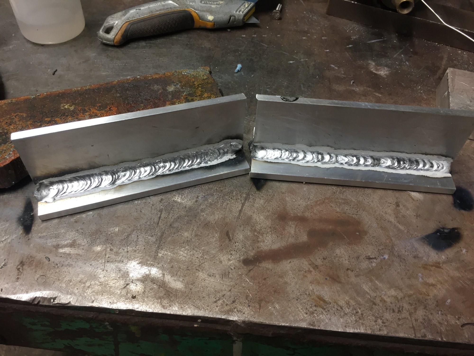

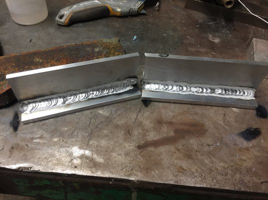

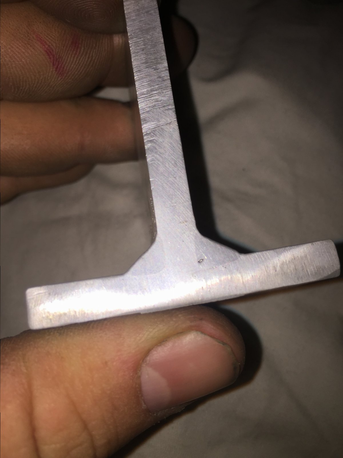

@Hood have you etched any of your welds with the Phoenix?
Cool. Just use oven brite or similar as long as it contains sodium hydroxide it should etch. Left it on about 10 minutes.No, think the only one I have etched that was Mig was one of the first runs I did when I got the R-Tech.
The EWM is not at my workshop at the moment, I left it up where I have been fitting out the boats as I will be back there next week sometime, so can't do a test this weekend but will try and get a test done soonish as it would be interesting to see.

I have been using Avesta Pickling paste, seems to work but maybe the oven brite would be better?Cool. Just use oven brite or similar as long as it contains sodium hydroxide it should etch. Left it on about 10 minutes.
