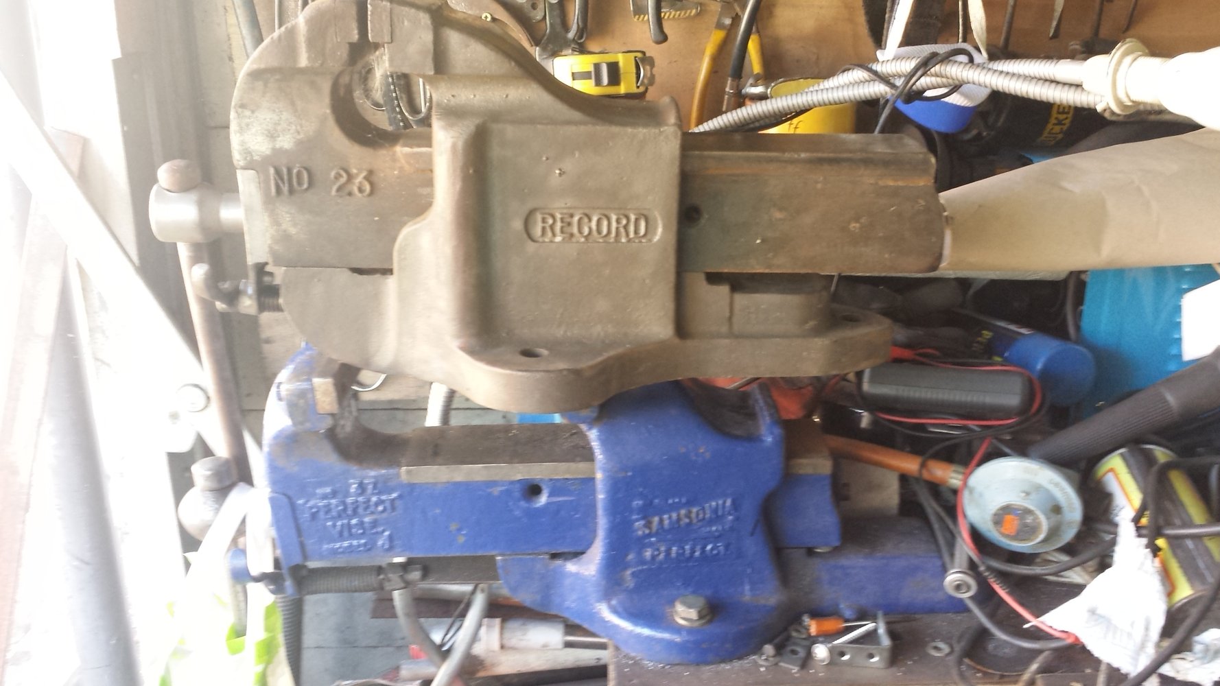

Famous last words.My old 114 and 25 take a battering without any complaints, anything really brutal happens in the 114.
Maybe! The 114 is steel so it should be a bit tougher than CI.Famous last words.

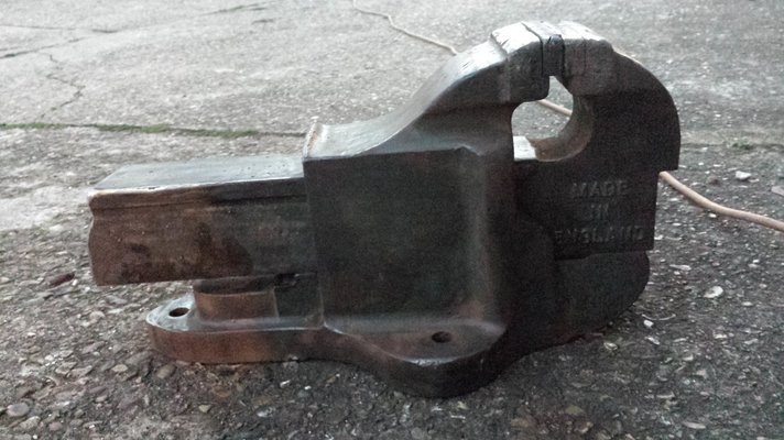

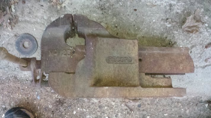

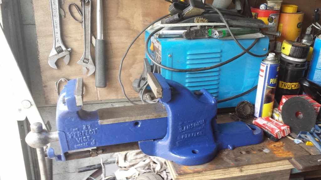

exactly what i have done, got bigger vice and use the repaired one just on the drill table for light stuff.Here's what I would do/suggest:
Touch the metal with a grinder, if the sparks are red then it's cast iron and it won't be so easy to repair. If they're white/yellow then use a 7018 rod to weld it having first spent a very long time V-ing it out so you get penetrated well in (ideally all the way). If you want you can then smooth everything over and add paint and make it look almost as though it never happened.
Then buy a much bigger vice to use for being rough with and keep this for sentimental reasons and small jobs which are within its limits - which are likely to be lower unless it welds nicely and you make the weld full thickness.

That was going to be my suggestion. I’d forgotten how heavy they are until I had to move mine the other day. I do’t think you can break a blacksmith’s vice, only bend the handle.If you are going to do stuff like that get yourself a floor mount blacksmiths vice. Then let us see you break that.

Are they silver colored and rough finish?.Can be successfully welded with oxy/ acet cast iron welding rods. I did one that was thrown out from a workshop a long time back, it's still lasting. Break was veed, propane torch till red around break area, then gas welded with square cast iron welding rods and flux. There is plenty of space where break is for extra build up of weld. I do believe that is the only way. One of my old bosses welded 2 vices successfully before I attempted that one.
Yes they are, look a bit like tinmans solder sticks. They are not exactly square, squareish and you revolve them in your hand so you are stirring the weld pool and bringing the bright spots (which are bits of carbon) to the surface of the weld. I don't know if you can still buy the flux, IIRC my tin rusted till the bottom fell out of it.Are they silver colored and rough finish?.
If so I might have some but no flux
