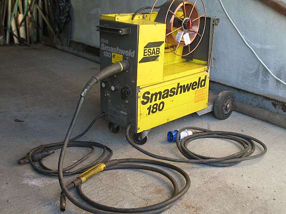

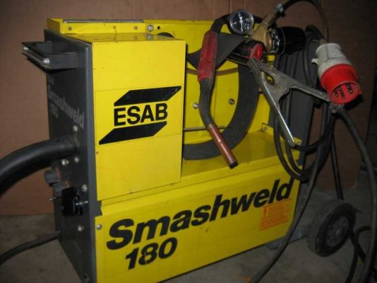

Just picked up one of these (Snap-on Branded). From an old guy, he`d bought it new, didn`t use it anymore and was selling all his gear.
Welder, ESAB Auto-Dimming Helmet, 90% Full spool of 0.8mm Wire, Gas Cylinder and regulator for £130. I think I got a good deal.

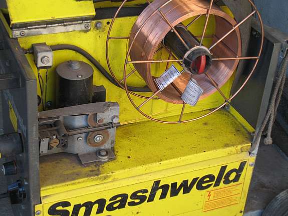

Just spent a little time practising this morning and I`m very pleased with it. Yeah, the wire feed may not be as smooth as a portamig or similar, but this isn`t a comparable machine, I can`t get one of those for the money I had available..
The 3-position switch is broken and only works as on-off, so I can`t try the stitch setting, not something I think I`ll use much anyway ?
The only thing I`m unsure about is keeping the existing torch or swapping to Euro-Torch ? Seems a fair outlay and I`m not certain what benefit that would give me. The gas shroud is held in place by a piece of rubber tubing pushed over the shroud and torch, it was a little loose, so I cable tied it into place and it seems fine.
Not sure what thread the contact tips are, I need to get a few spare as well as a roll of 0.6mm wire and 0.6mm tips for thinner stuff.
Are contact tips `standard` 6mm or do different manufacturers use different tip thread ? Same for the `push on` gas shroud, anyone have a link to a new one please ?

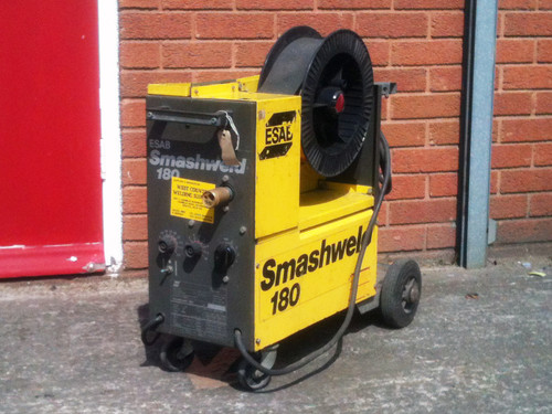

Mine still has the standard torch assembly, like this
I see this one has had the Euro Torch conversion

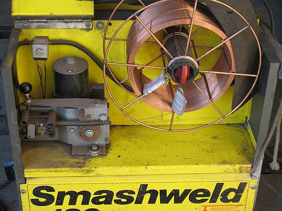

I`m having wire-feed issues with mine and it makes sense to change to a Euro Torch. There seem to be several readily available kits for the conversion, has anyone done it and if so, is it pretty straight forward ?
I thought that too ! but I cut a length of wire, pulled it through the liner and you can feel it keeps catching, definately the liner. Seems daft changing it like-for-like, may as well go Euro torch.
you can buy a euro adaptor that fits esab machines directly. No modification. Just undo the allan key screw, pull the original torch out and slot in the esab euro connector back in. Mount the plastic flange on the front panel and connect the one trigger wire up. The esab euro connector is a bit more expensive than standard ones, but it is alot easier to fit. PM me if you want further info.
Thanks, I`ve found that, but buying one of those and a 4m torch works out another £30 or so compared to buying the `kit` complete with universal adapter plate.
Has anyone fitted the `standard` Euro torch conversion plate to one of these, or does the feed assembly / gas hose proximity mean the only realistic way is with the ESAB connector ?
Before anyone suggests it, I`ve tried ringing Steve (weldequip) who I`ve used before, but it goes straight to answerphone and he hasn`t been online here for almost a month, so I`m guessing he`s away.
Bought one of the ESAB adapters and 4m Euro Torch. The front of the case needed 2 holes drilling to secure the Euro plastic cover, I used the original top hole. Slight modification to the plastic feed `tube` but it only took half an hour or so to do the entire conversion. Would be quicker next time.
Piece of cake and the welder performs SO much better now, not cheap, but definitely worthwhile

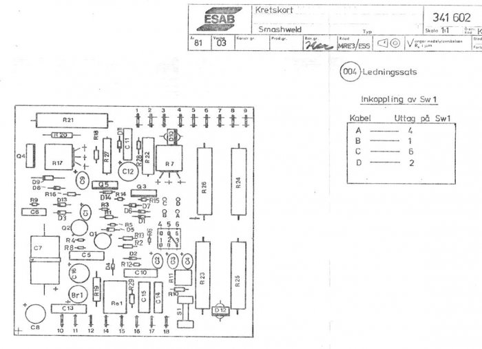

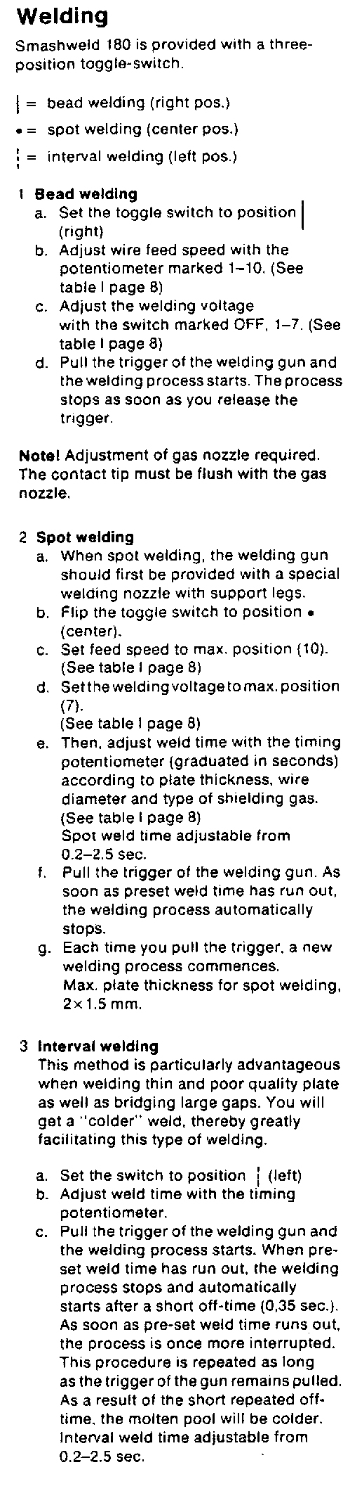

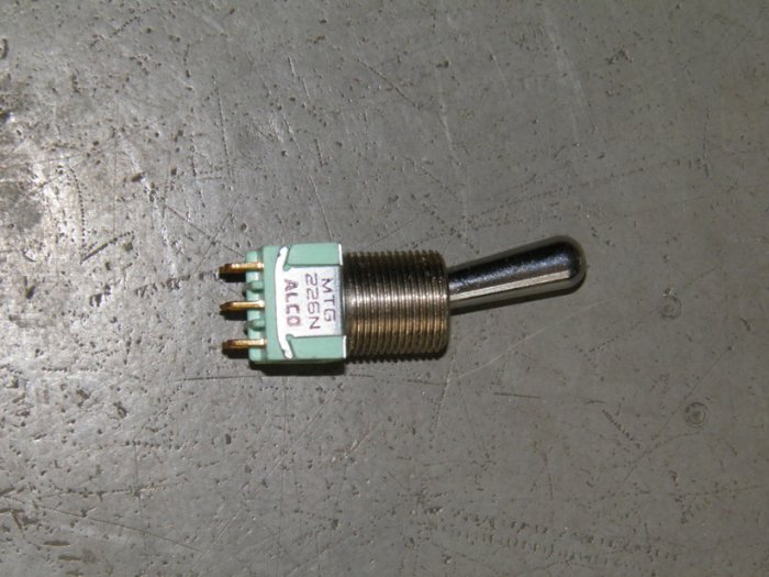

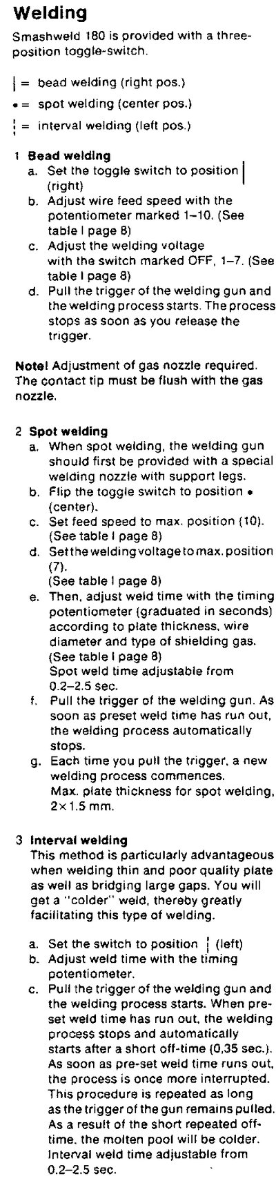

When I bought my welder, the interval / spot / normal selector switch was broken and had been bypassed. No problem, not something I was bothered about, but I`d like to fix it so the welder is fully functional and I have the option to interval weld if necessary.
Removing the side cover and it`s obvious to see where the switch has been bypassed. (I removed the tape to look at the joints)
A is linked to B
C is linked to D
I`m guessing a 3 position switch is needed, but don`t know how to wire it up. Anyone know what requires changing to swap to the interval welding mode ?
