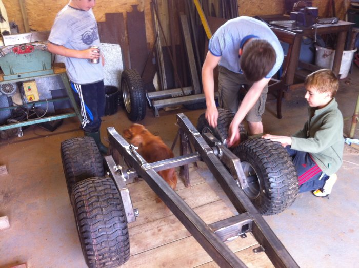

Final spec remained with the tandem walking beam axles mate! managed to trim the measurements of the trailer down so the load bed is just bigger than the Argocat dimensions. Going with mesh side panels to save weight. Still confident of getting it around the 200Kg mark, but time will tell! I will be making it so it can be converted to standard suspension units should it require it later on down the line. i carried out a fair few miles of road testing with our timber trailer fitted with walking beam axles to see how it handled and I am happy with the results.

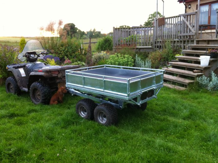

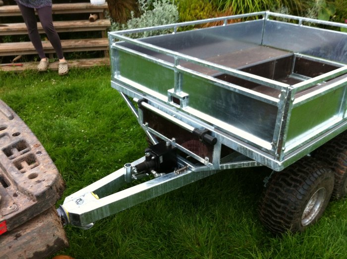

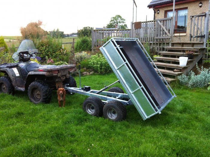

All the welding is complete on the tub and chassis, and the Buffalo Board has been fitted as per the photos. Lower tail gate in and working as planned. Box ends have been capped and drain holes made for the hot dip galvanising.

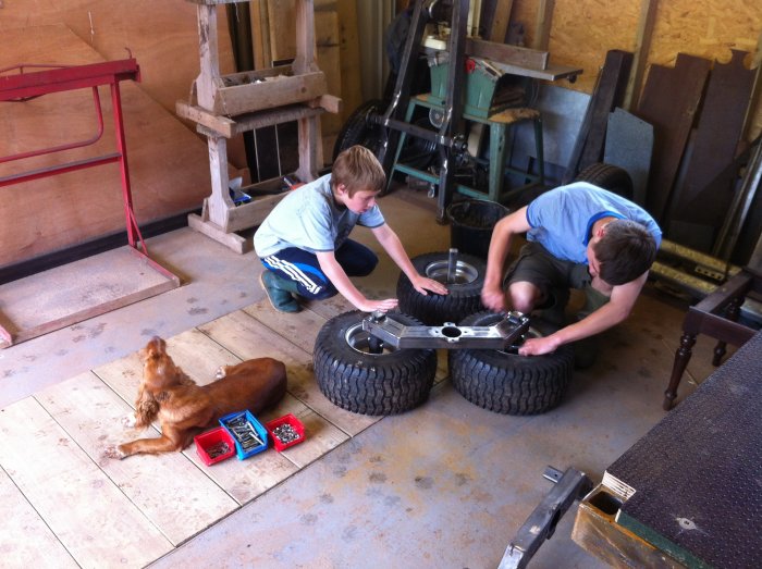

Got the kids next door to come and assemble everything this morning so I could take it out for road and field trials.
Yet to add are a few tie down cleats, the removeable extension sides and upper tail gate. These will be 20x20x2 SHS skinned with pre-galvanised sheet or alluminium.
There wasn't much came to light during the field testing. At the minute it doesnt have bump stops for the beams, the tyre simply hits the underside of the deck. I'll probably fit stops before it's finished.
I'm going to weld collars around the ends of the axle tube where the stub slides in. I can see the hole becoming elongated with constant abuse and then the beams will be canted, the tyres leaning in and it will look old and tired.
I've got two spring bolts to hold the tub shut but these will be mounted on rivnuts which will go in after galvanising. (holes drilled previously)
The bare edges of the phenolic ply will be coated with resin before the final fit to keep the moisture out. These boards are pretty amazing, I have another trailer that often sits full of water and the ply board in the bottom is still as good as new.

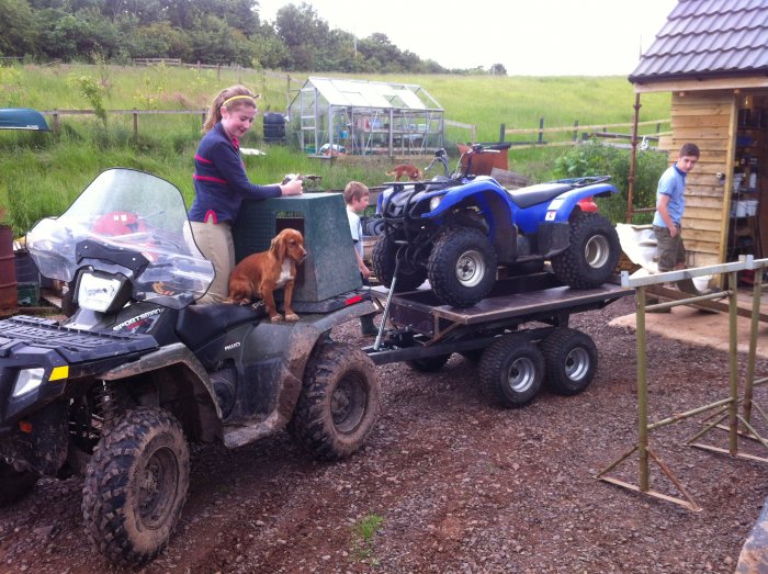

Pics 1-3 , the kids getting stuck in and pretty pleased with themselves at the end. Ewan said there was no way his 125 Grizzly would fit on it .

It doesn't look in proportion, or the wheels are too small. And it's heavier than I'd hoped. I'll put it over a weighbridge when I get a chance and tell all.

First thing on the list is 22 inch tyres. I'll get new beams knocked up ready for my next trip to the galvanisers. The current beams articulate beyond 45 degrees so there is plenty room.
