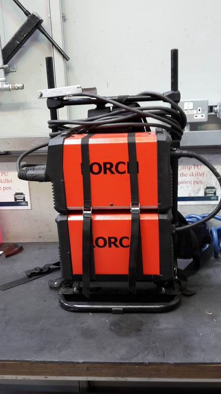

The machine was delivered today but I was on site. Got a very quick play when I got back to the yard. Ran a 2.5 along the edges of a bit of 12mm flat.
First impressions are very good.
Will report back when I get a better look at things. Probably after the holidays as we're flat out.
Having trouble uploading photos. I'll try and get some tomorrow.

Yeah they've had one about now for a short while.I didn't know Fronius made battery welders, we've got 3 of the Lorch models and they've saved the day a few times now![]()
Yeah that steel pack back looks well handy.The backpack carrying frame is great for us as we can have an easily accessible job at ground level or it could be below ground in one of the lifter pits or overhead on the conveyor systems. We're normally all set up and ready to go before the internal fire brigade turn up to issue the hot work permit![]()
I like the fact that the lorch is the standard unit with a battery add on. At least this way if the battery dies you've still got the option of plugging it in. Not sure if the fronius does this. Looks like the unit is all in one dedicated battery welder.
