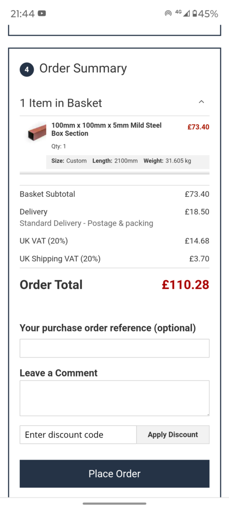

Just looked up the price of 100mm by 5mm box section, would be more than £100 delivered.
100x100 fence post? Cheap as chips.
I've had this "Roundtuit" thought of a "Car Port" type thing as a covered working area in between my block-built workshed & the house (lack of space inside the shed & to take dust/debris out of shed).Just looked up the price of 100mm by 5mm box section, would be more than £100 delivered.

My first thought was box steel uprights.
However it's around £100 a post in steel versus more like £15 for a tanalised timber 4" × 4" post.
At that cost difference...
The OP could get a square fence post tanalised to do his job cheapest. Stand the ends in creosote for a day, & it'll see any of us lot out.
