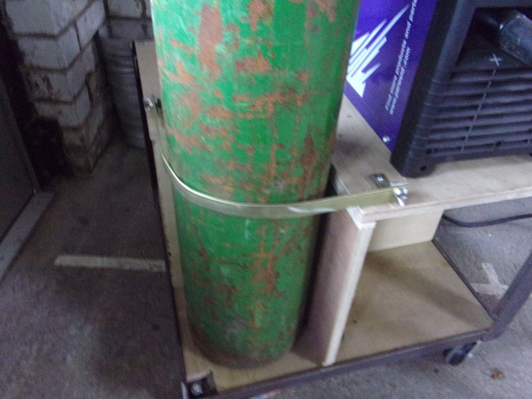

I'll now add something to the welding trolley to secure the larger cylinder then cut up some aluminium practice blanks; I might even do a bit of metal spinning. As I type our black car is white after a severe overnight frost and it's bitterly cold outside; I'll wander down to the workshop wrapped up like an Eskimo and switch on the fan heater; I'll soon warm up and be comfortable; I always believe there are many better off than me.

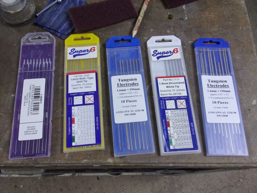

I've just been doing a job in the workshop and this time remembered to take a picture of my tungsten selection "Battery exhausted" on the camera but my pencil and paper didn't let me down.
1.0mm Zirconiated.
Super C 1.6mm Multi-type Gold tip.
1.6mm 1.5% Lanthanated.
Super 6 1.6mm Zirconiated White tip.
2.4mm 1.5% Lanthanated
All in packs of ten. The Lanthanated I bought through eBay the rest supplied as suitable for aluminium TIG welding by Wakefield Welding Centre.

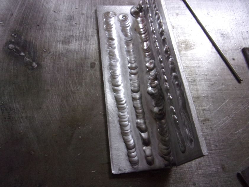

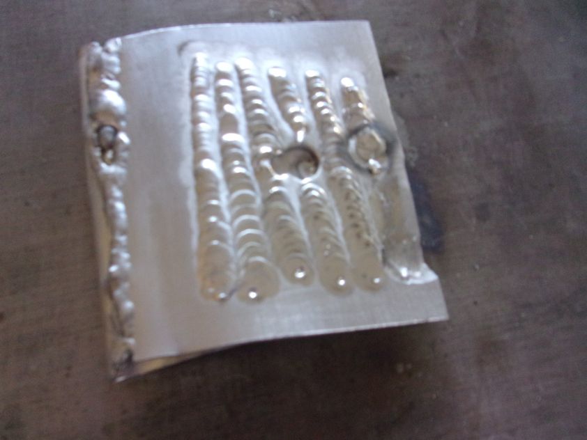

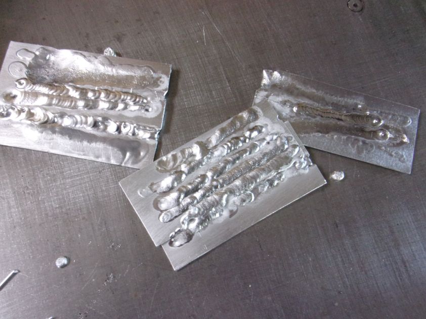

I've been practicing welding 1.5mm thick aluminium using a 1.6mm Lanthanated tungsten and 2.4mm filler rod but found the filler rod didn't work as expected so I then used 1.6mm filler rod with better results; I keep running out of workshop time; I've just been doing some planing because our new front door was sticking at the threshold due to all the driven rain; there's always something to divert me from welding but I'll keep having a go whenever I can.
Happiness at last, two sessions practice welding in the workshop today just getting the feel of things. This morning I ran lots of practice beads on 1.5mm thick aluminium using one of the 1mm tungstens and it went pretty well. This afternoon I thought I'd have a go at pulse welding so installed a 1.6mm tungsten and set the pulse at 1hz. I started with a peak of 150A but as the job heated up I knocked off at 122A. Anyone looking at the privacy safety glass in the workshop doors would think I was playing with a strobe. I'm finding pulse welding very interesting indeed and it heats the metal up a lot less giving me more control. I'm definitely improving; not much puddle dipping and only one hole appeared which I filled in.

Camera battery now charged so a picture of my tungstens.
Practice runs without pulse; mixed results but not much soot and no holes. 1.5mm thick aluminium.

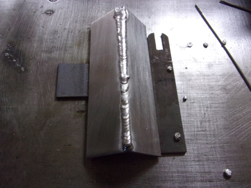

A corner joint in 3mm thick aluminium on pulse; the top end looked a bit rough so I went over again adding more filler rod.
Not pretty but pretty good practice. I'm even getting a few dimes.

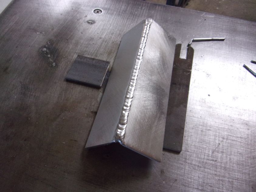

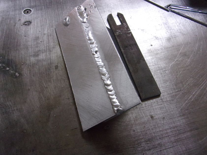

WOW a clear bead of weld on a corner joint; pulse 122A on 3mm thick aluminium; no puddle dipping; holes or soot; its taken a long time to reach this stage but has been worth it.

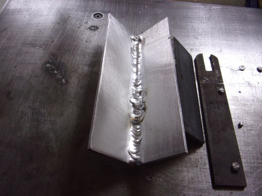

Bottom to top I was doing OK with this 3mm thick aluminium lap joint until the filler rod stuck and as it broke free I jerked the torch but again lots of progress and no puddle dipping etc; I resharpened the tungsten and finished the joint; I'm now well on my way with lap joints; more practice still needed but I feel I'm getting there.
Just doodling with the torch on a bit of 1.5mm thick aluminium adding 2.5mm filler rod; still on pulse but at much reduced amps which I should have reduced even further. Pulse welding is helping me a great deal; I can revert to standard welding once I gain a lot more experience.

Coming along nicely Colin, practice is all that is needed now, the more you can do the easier things become.
Pulse on AC is not something I like or use but everyone is different and if you can get on with it then that is all that matters.

I find as a novice pulse suits me better because it greatly reduces heat build up as the bead progresses; I've also been experimenting with 2T & 4T playing with the torch buttons but it all comes down to putting the practice in. Pulse set at 1hz I find very useful in that I've got time to dab the filler rod between pulses and if I hold the torch more upright it focuses the heat downwards rather than forwards; having the torch pointing forward too much I notice it melts the end of the filler rod before the rod touches the puddle making it extremely difficult to control; once I make the start with pulse though I can simply keep stepping over the rod with the arc giving the "dime" pattern; its more akin to stitching. I feel a bit miffed that I should be a lot more advanced by now; it's not from lack of interest on my part but I've lost months due to so many problems getting in the way; I intended to have another session in the workshop this afternoon but former neighbours dropped in with Christmas prezzies and best wishes which was a pleasant surprise; now everything is working as it should I can pick up the pace a bit; in a way I'll be sad when I can weld proficiently because I do like learning curves and leaving my comfort zone; TIG welding though has given me the run around big style but I'm too thick to know when to quit so I always stick with something new whatever is thrown at me. On the final run up to Christmas we'll go out less because we don't like crowds in fact I'll be glad to see the back of Christmas and all its falseness looking forward to springtime.
