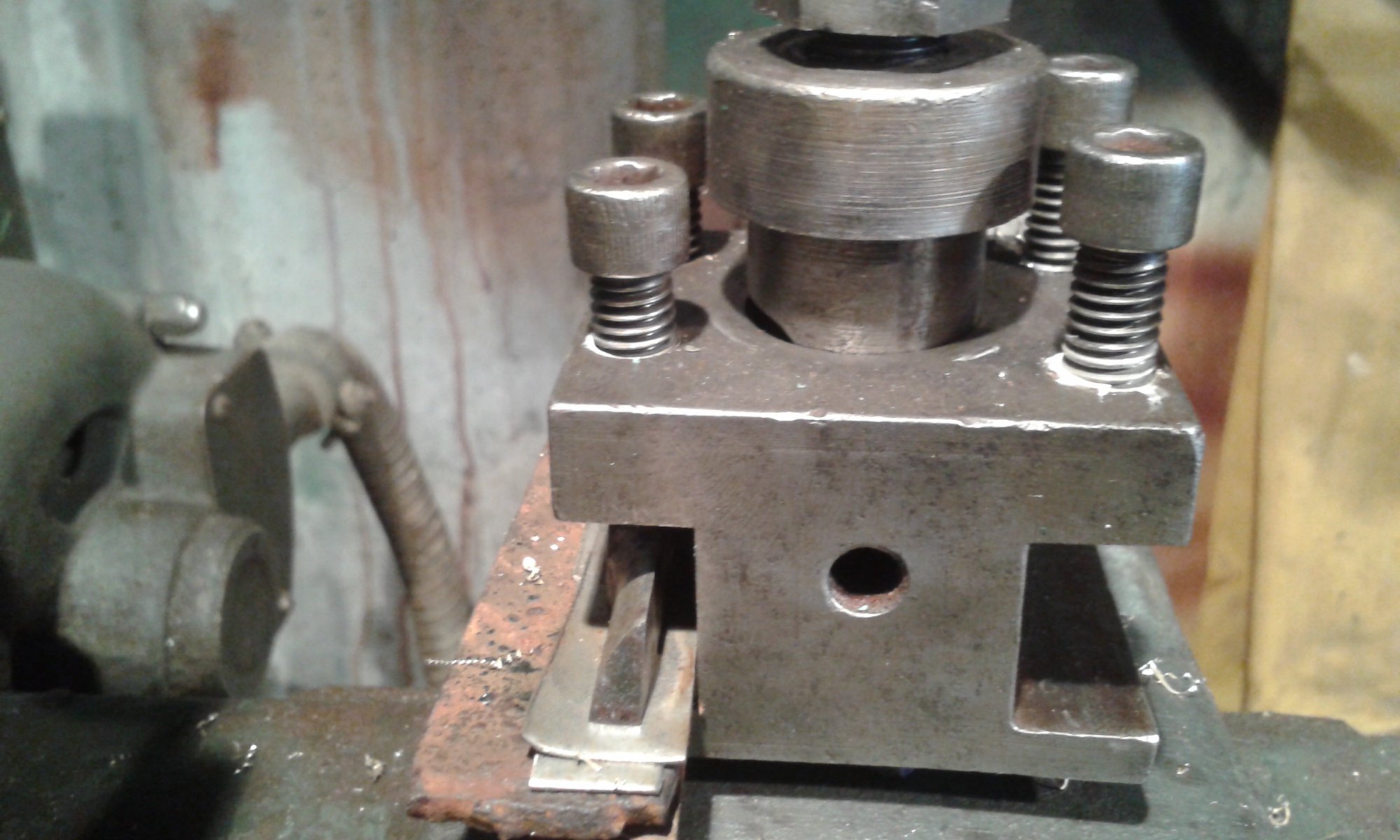

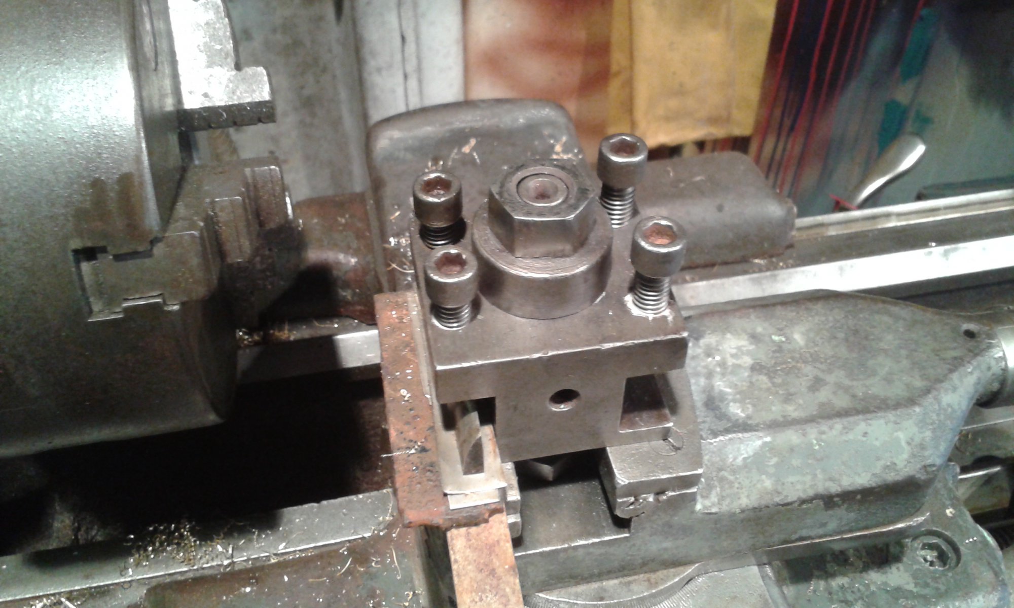

if its any help the t0 dickson toolpost is the correct size. 73mm sq and 51mm high
so it looks like the smallest listed the 250-111 is a little on the large size, but should do. if its too big the centre hights going to be harder to adjust.
RDG tools usually do a disckson copy the right size, but they look to be out of stock.
Rotagrip do them too, thay had them made but thay are a wee bit on the steep side.
A word of warning though. the tolerences were a few thou over or under the inch size and have caused confusion in people making copies. I bought some holders from rotagrip and they didn't fit and the tolorences had wandering in the copying.
They are helpful though. they changed the non fitting ones after explaining the issue and they had some that fitted.
