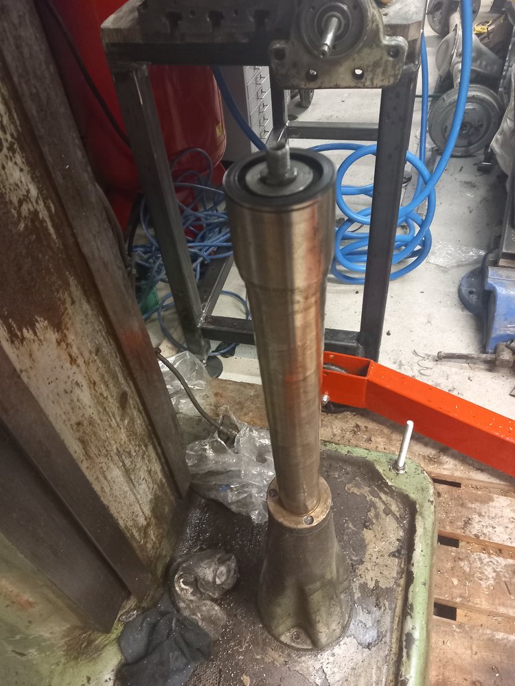

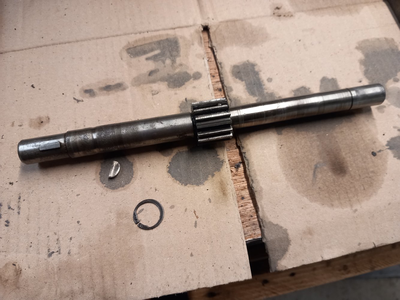

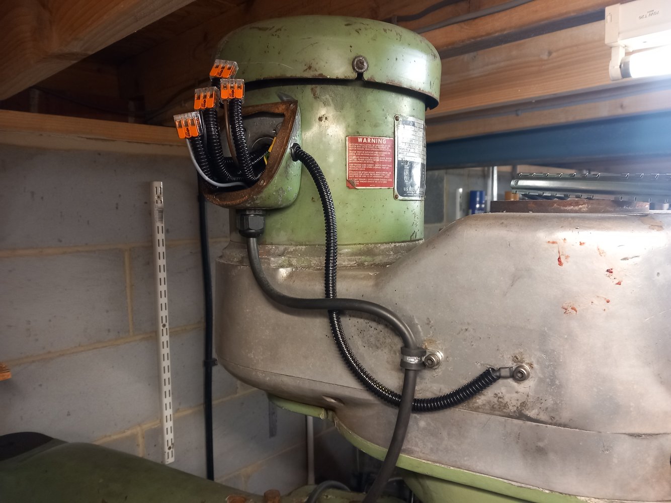

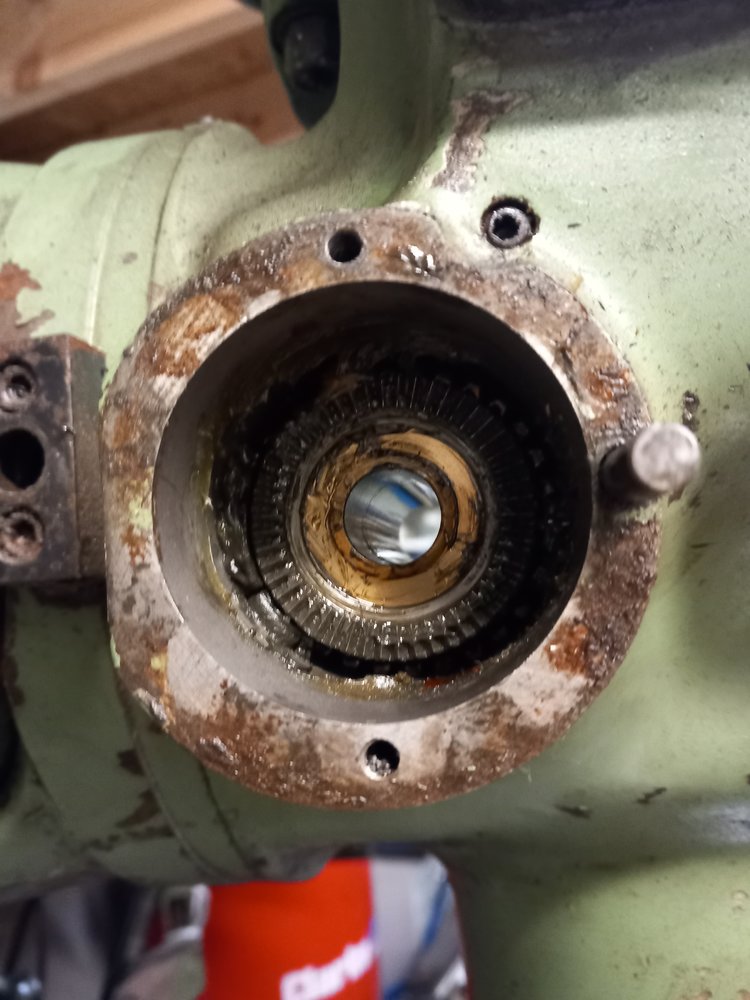

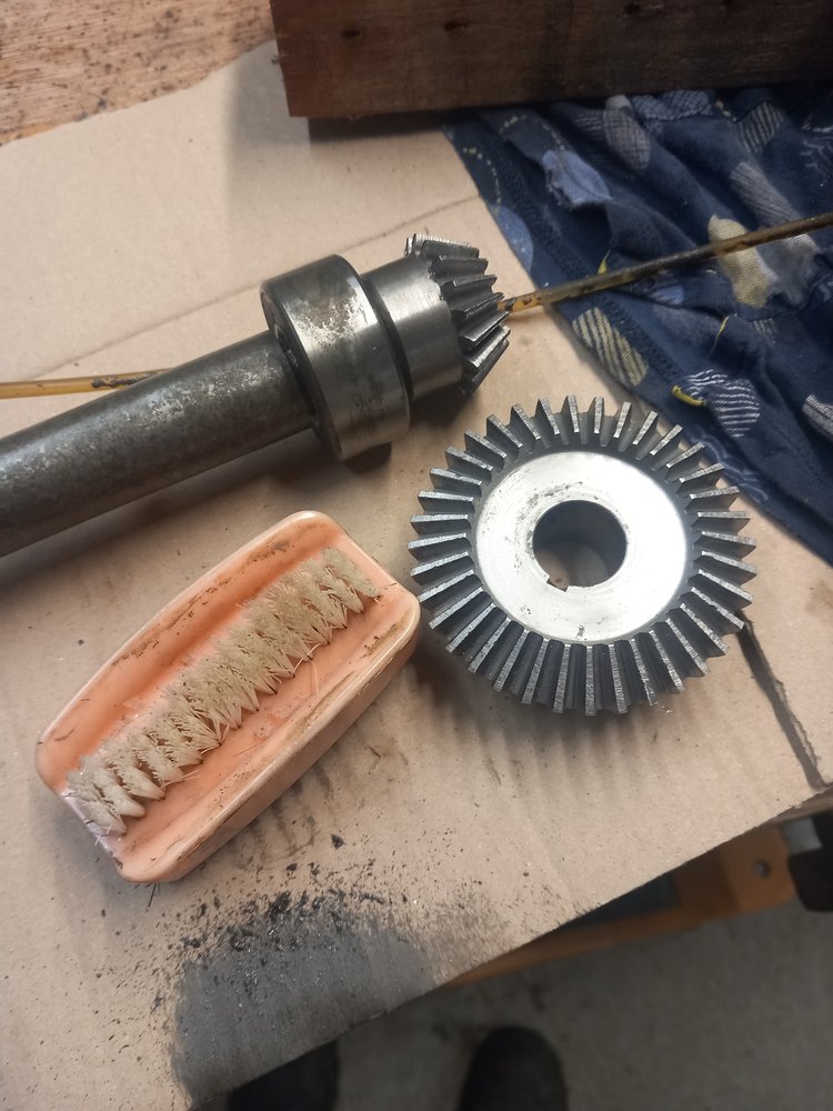

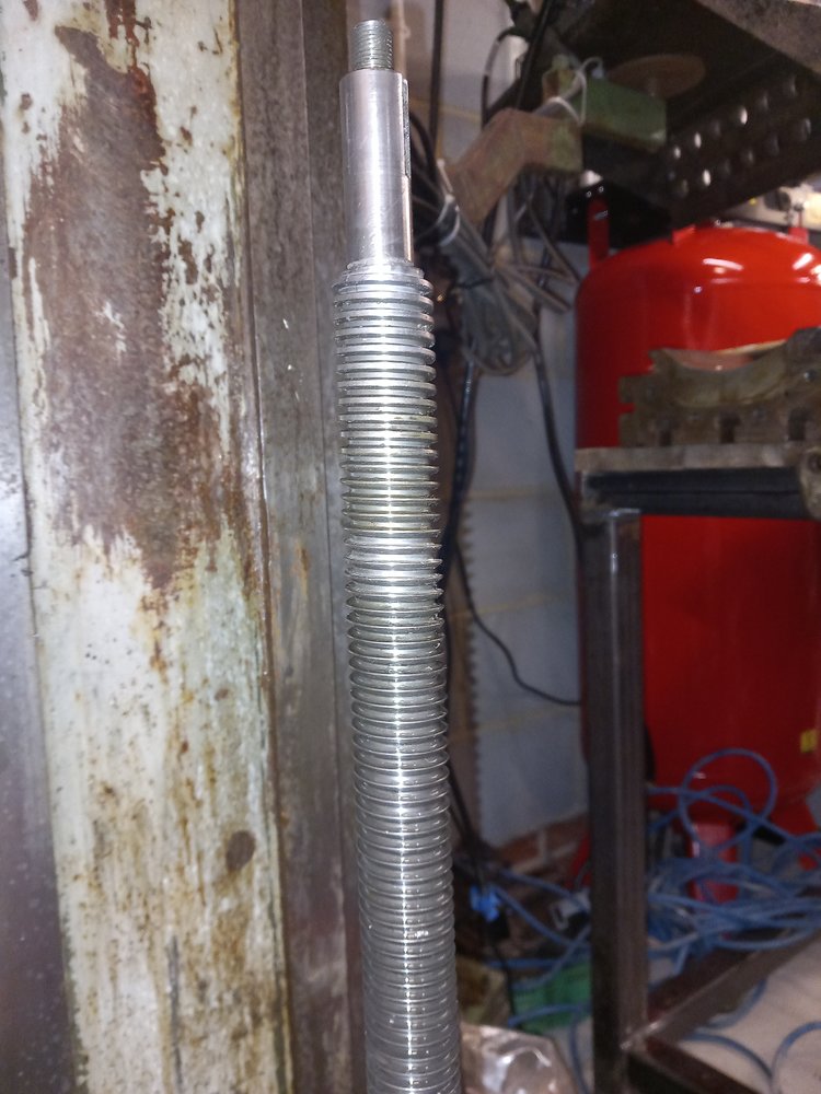

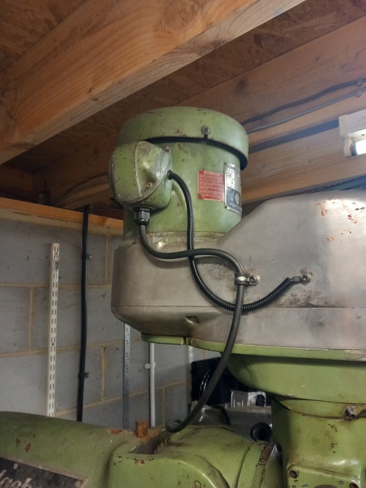

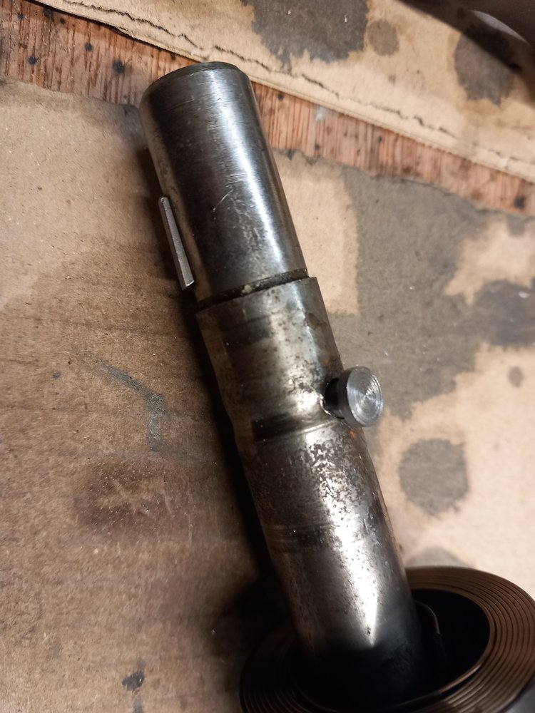

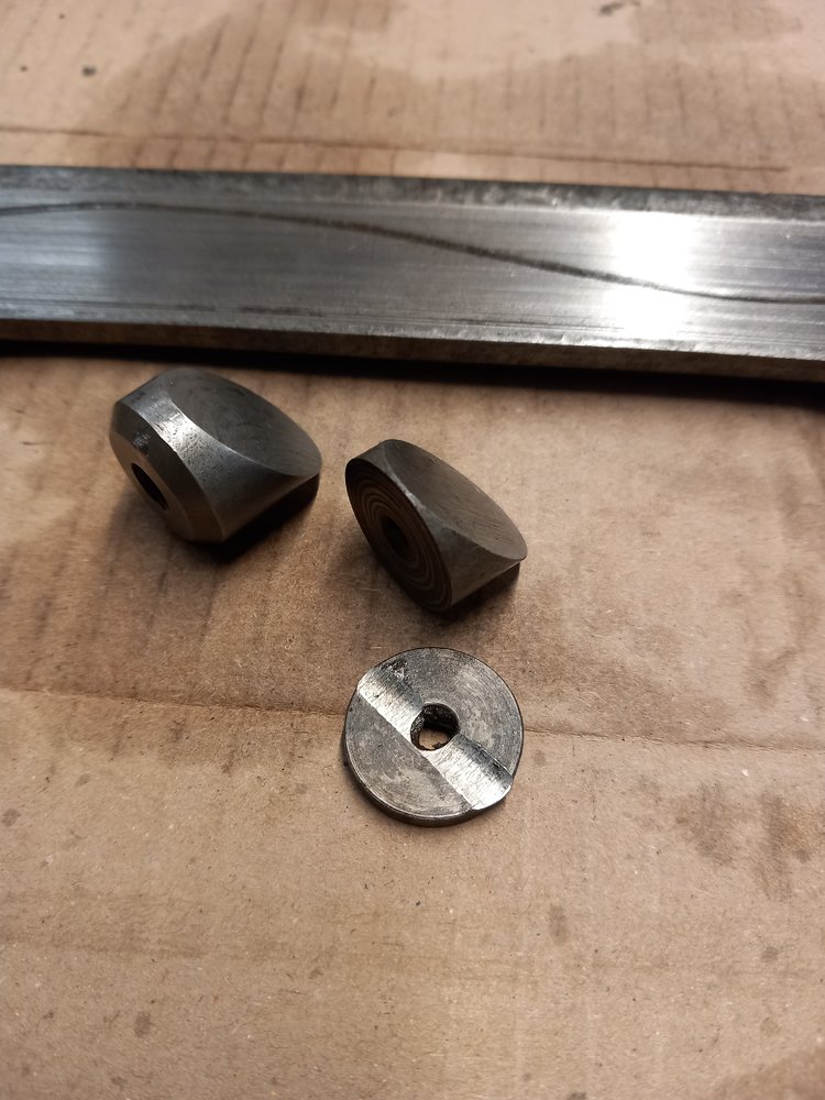

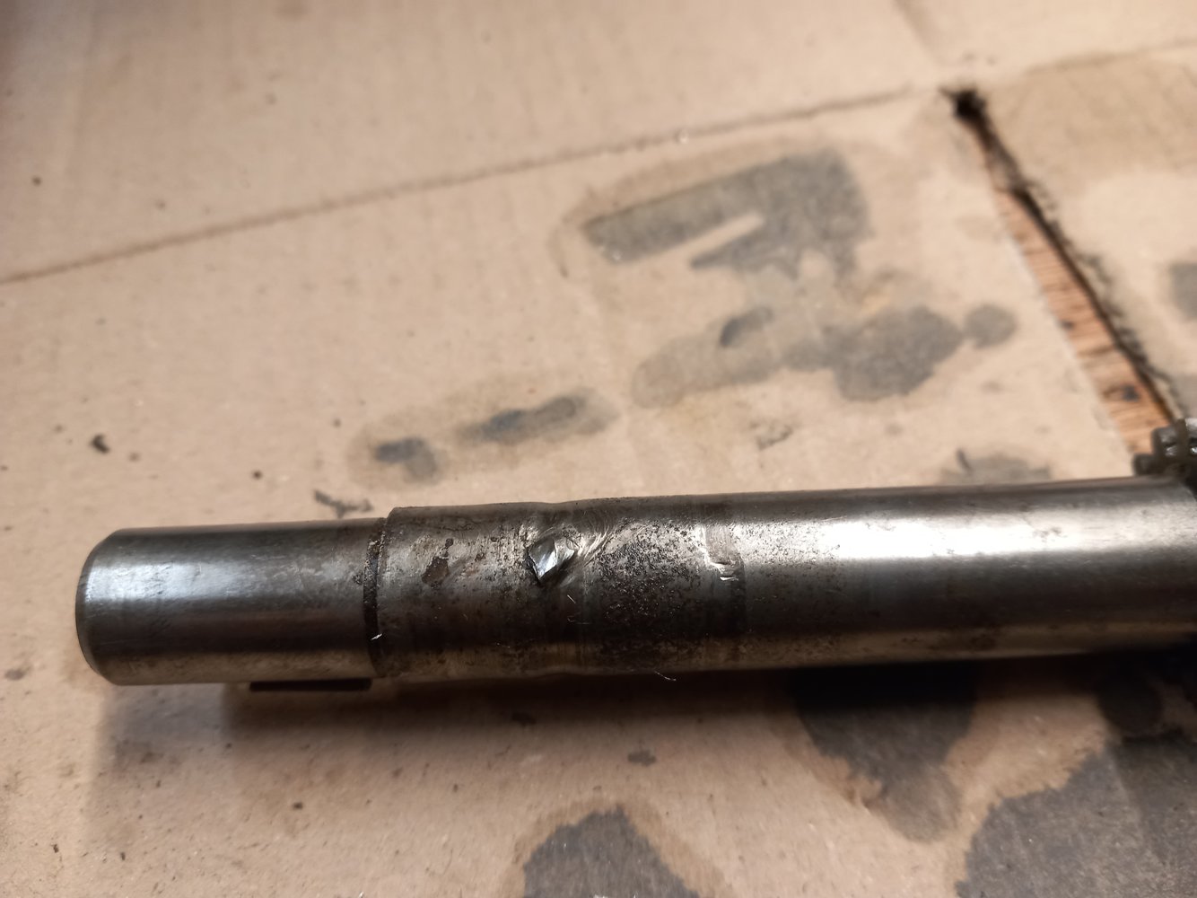

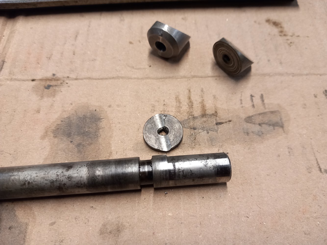

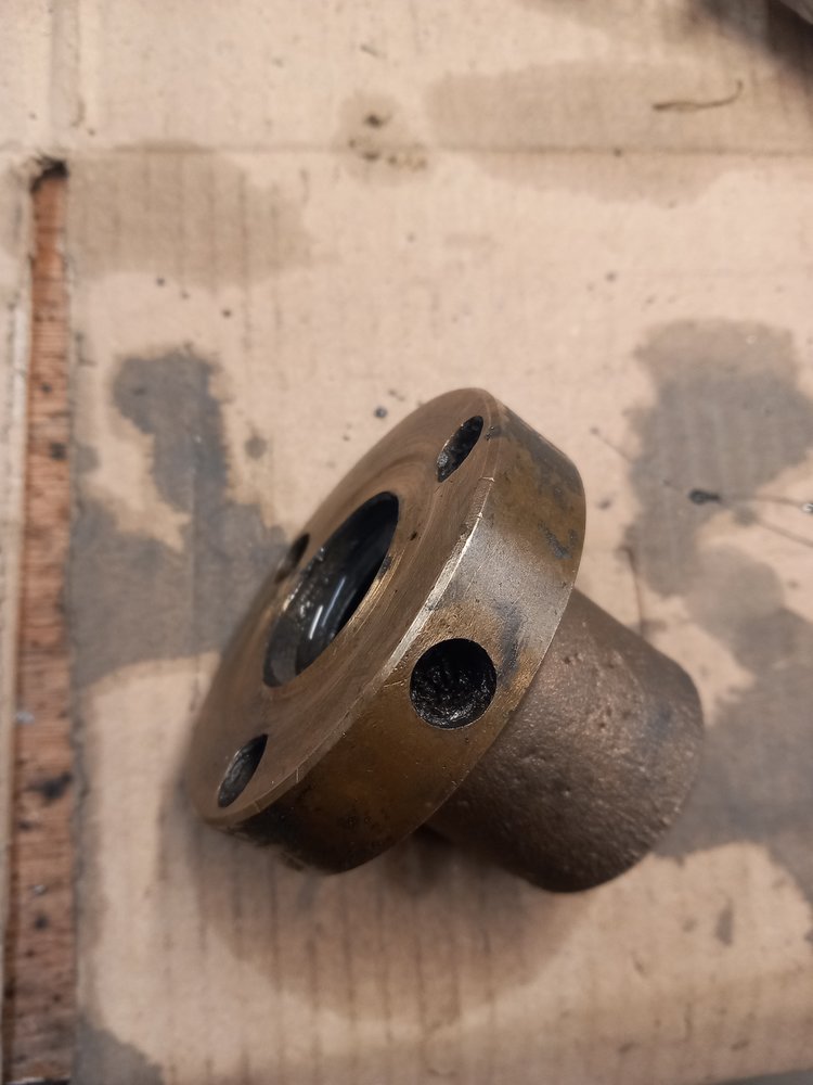

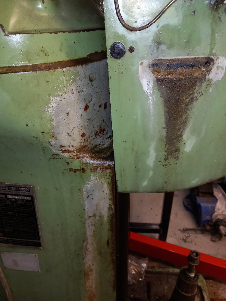

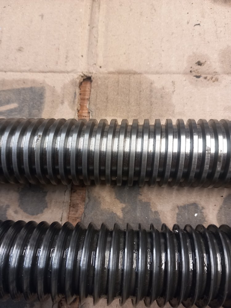

Earlier in the week, I removed the knee elevating shaft. It was a struggle but got there in the end. Some oil on the outside of the bearings will be applied when it goes back in. The ram and head also rotated out of the way no bother on the second attempt. I did wash the rusty ring down with WD40 which might have helped.

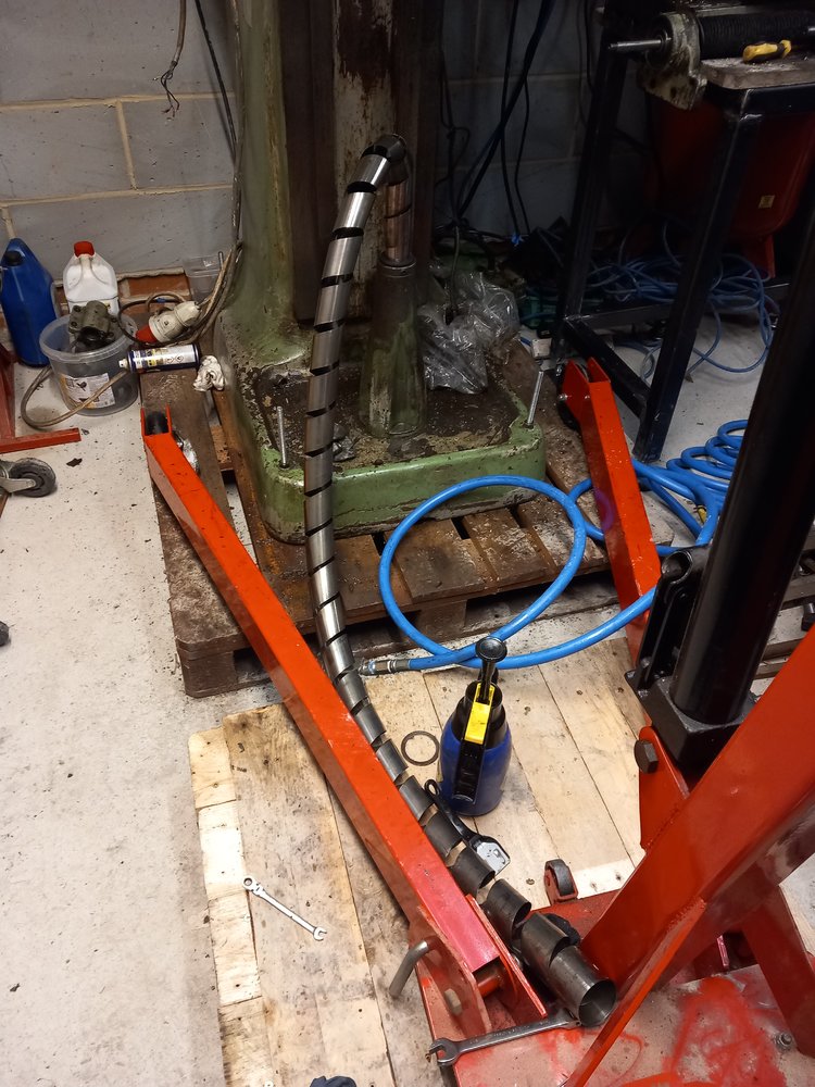

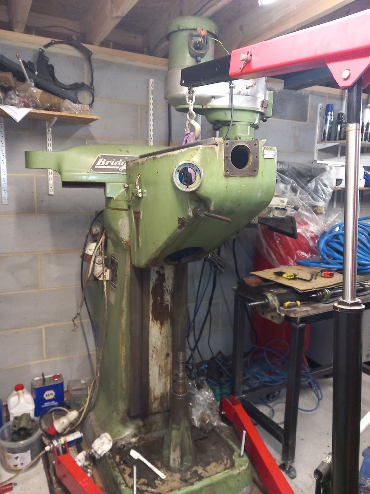

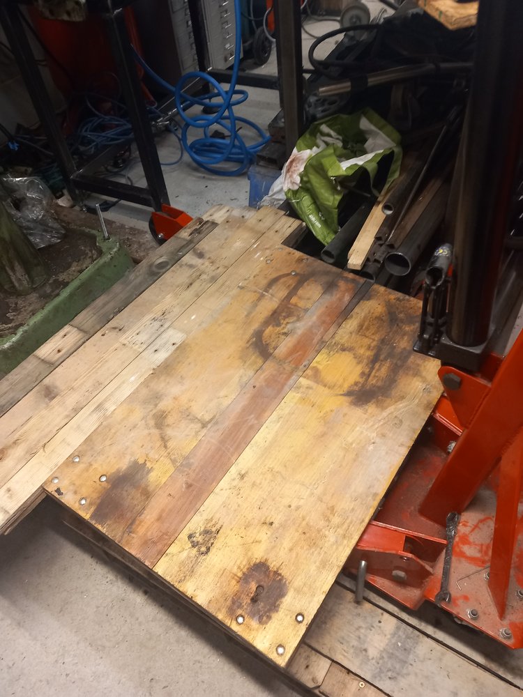

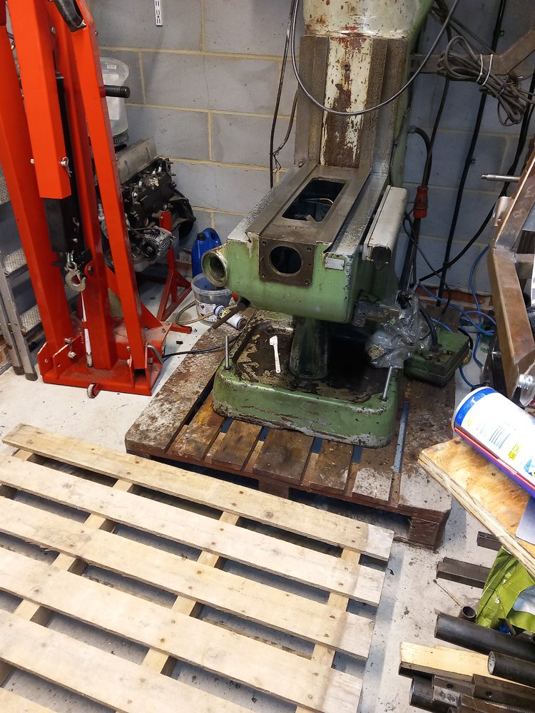

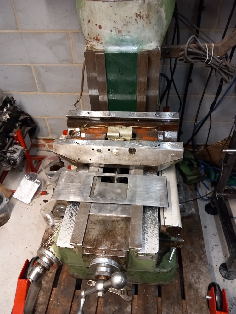

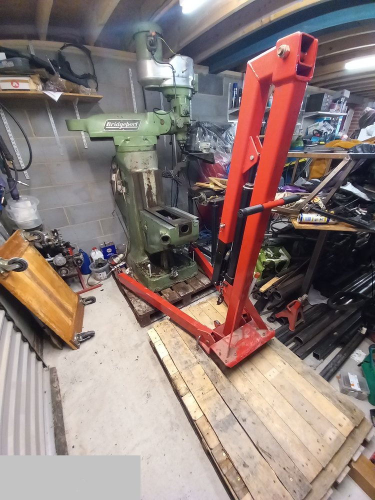

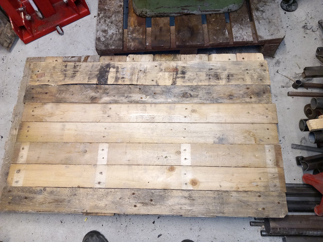

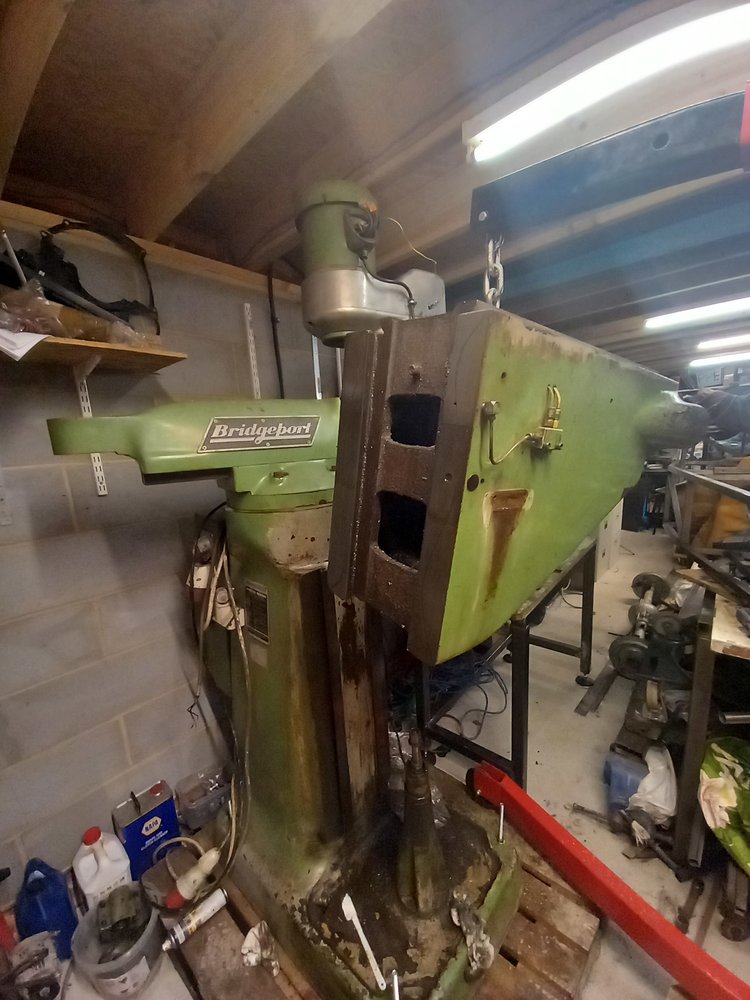

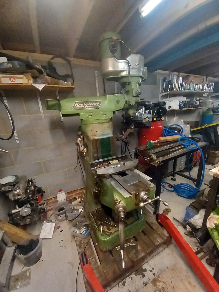

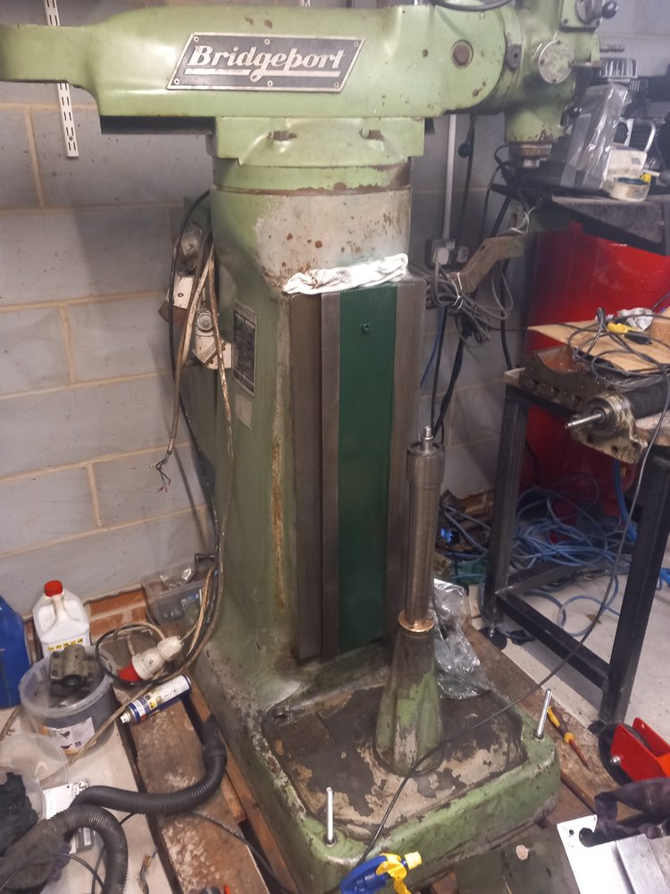

Time to remove the knee with the engine crane. The mill is on a pallet so the engine crane needs elevating to match. I started with this pallet below. It's rather flimsy, gappy and too low. Fortunately I have loads of dismantled pallet wood to beef it back up.
Two opposing layers of 3/4" boards screwed down later and we are here.

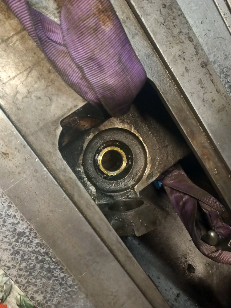

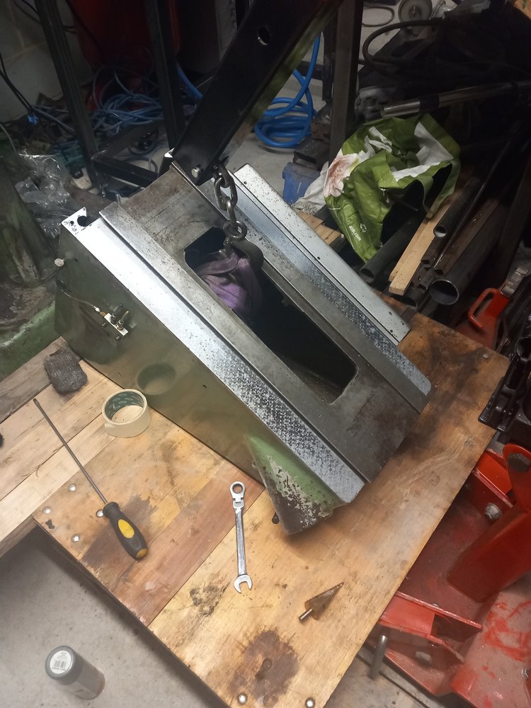

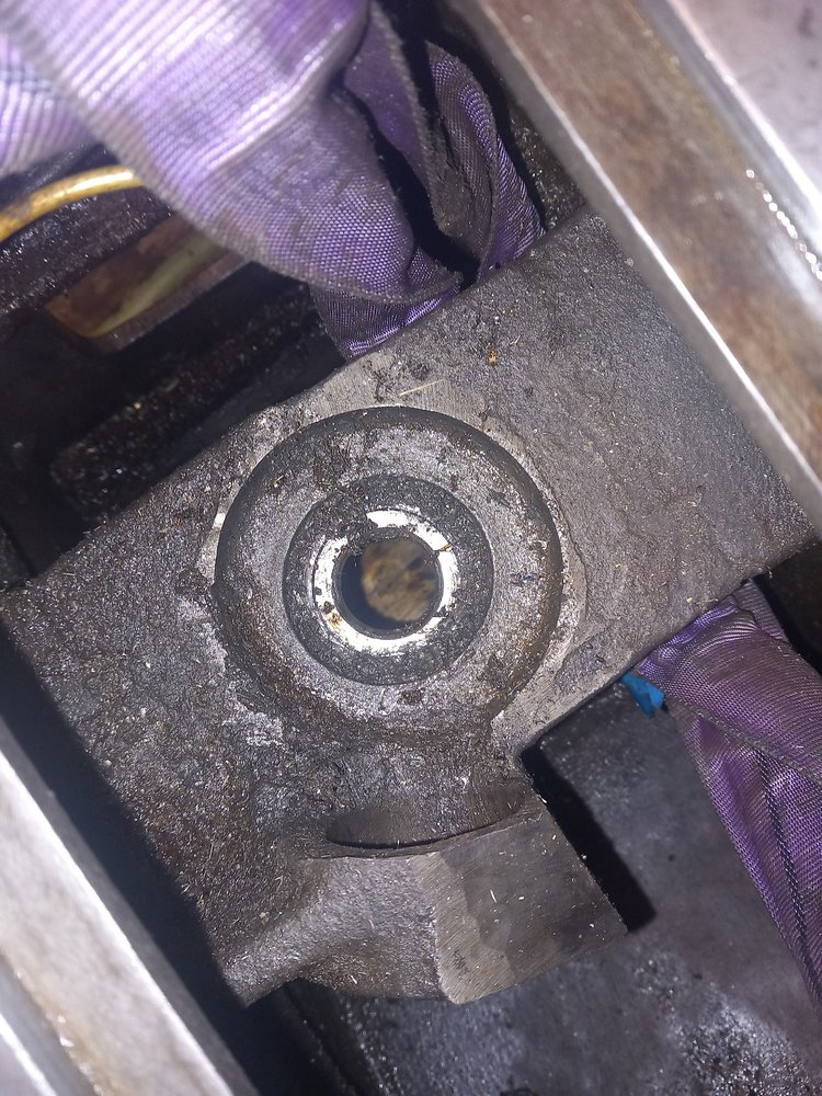

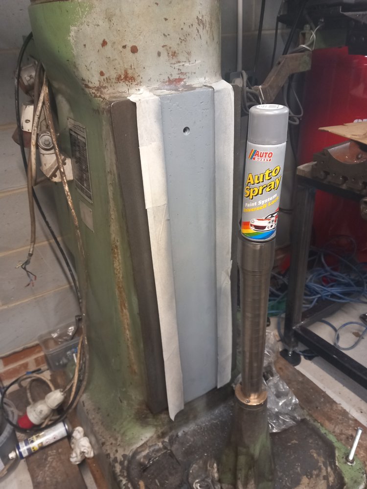

This is as high as I managed to get it today. The crane is at max lift. I can probably get the knee to clear the ways if I can shorten the lifting strap. It's only a couple of inches and I can pad out the area where it is wrapped around to remove some unwanted length. I know straps shouldn't be used like this but it's nowhere near capacity.

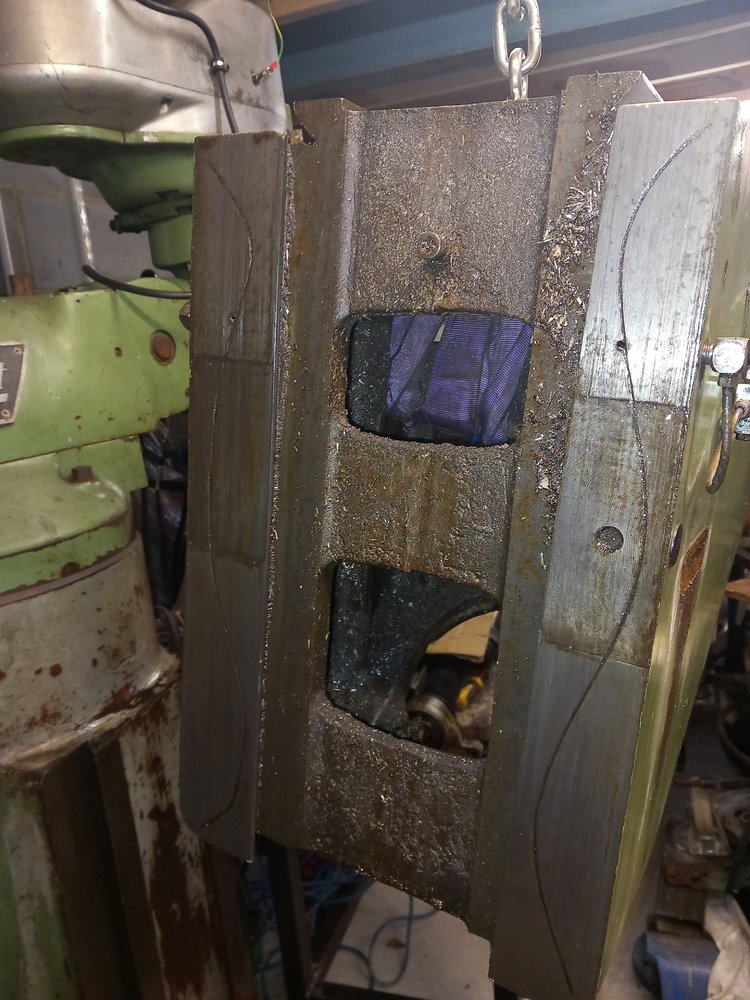

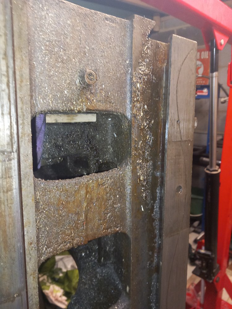

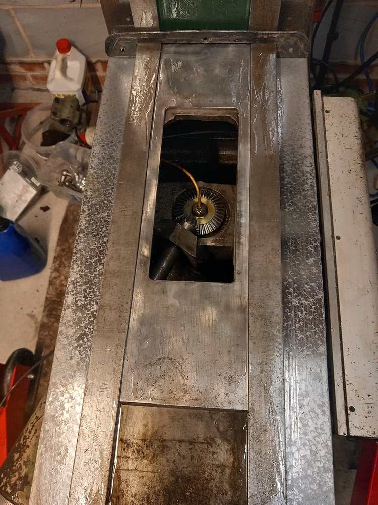

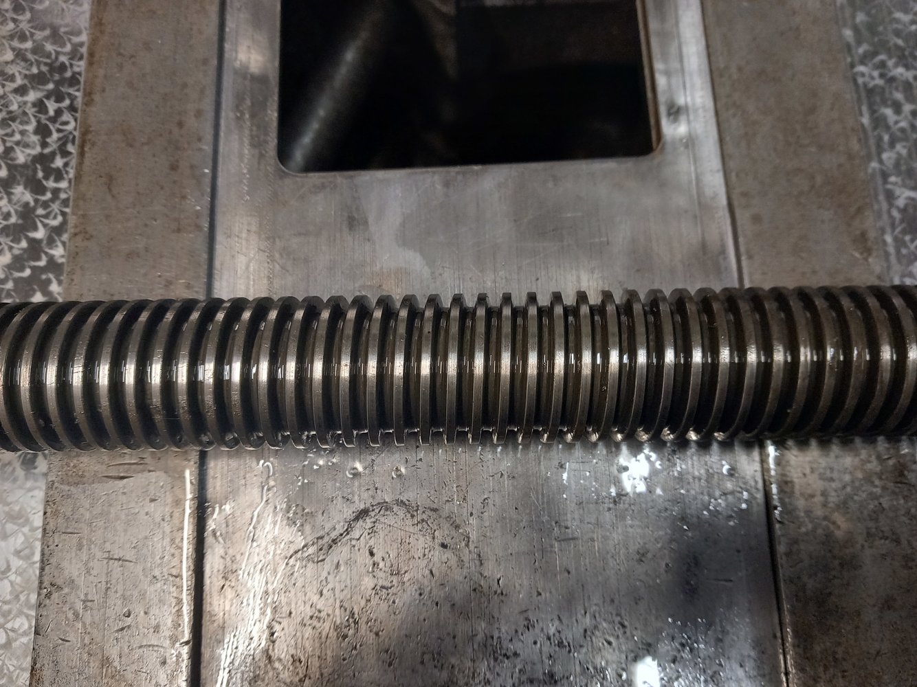

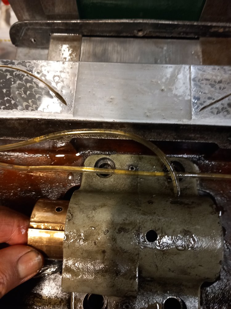

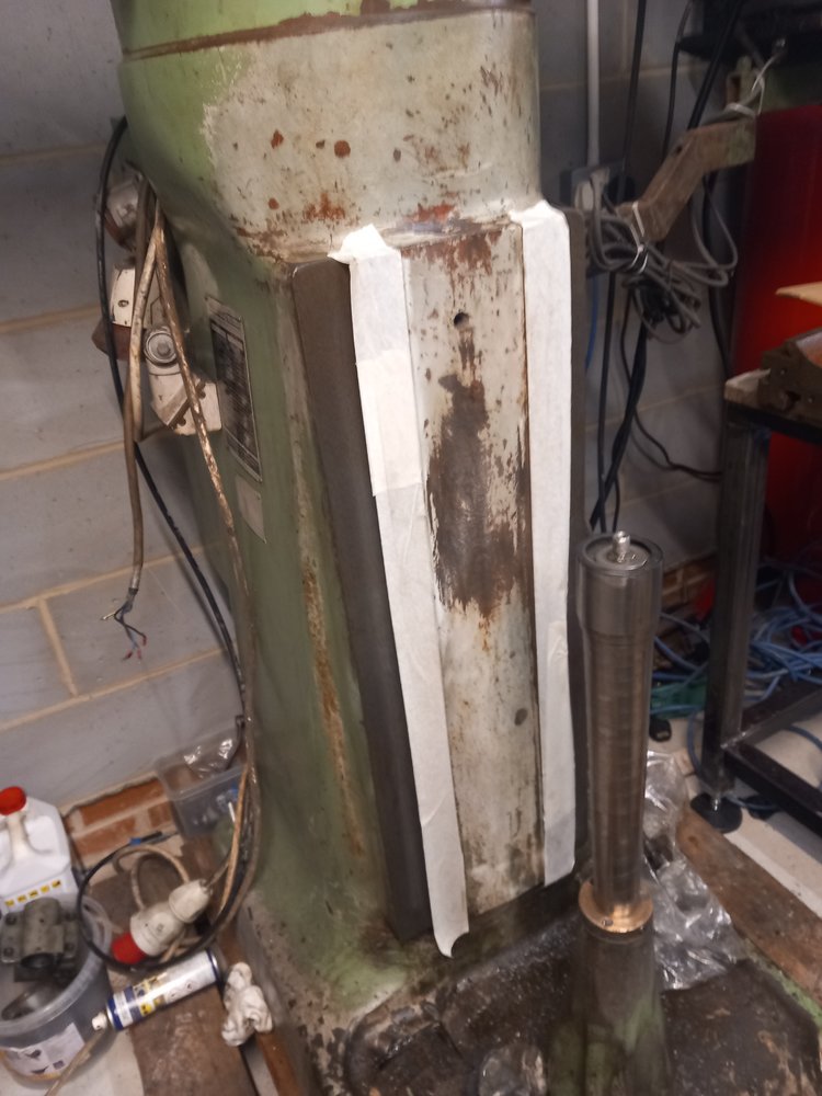

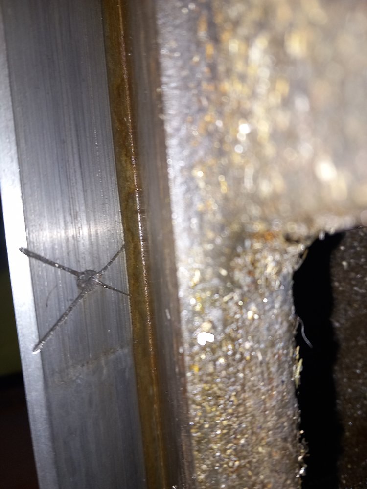

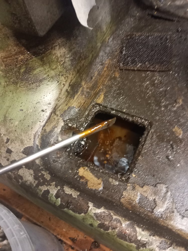

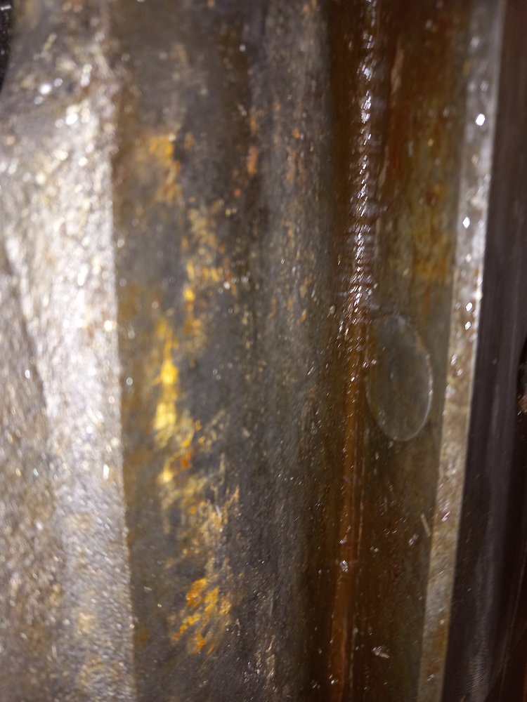

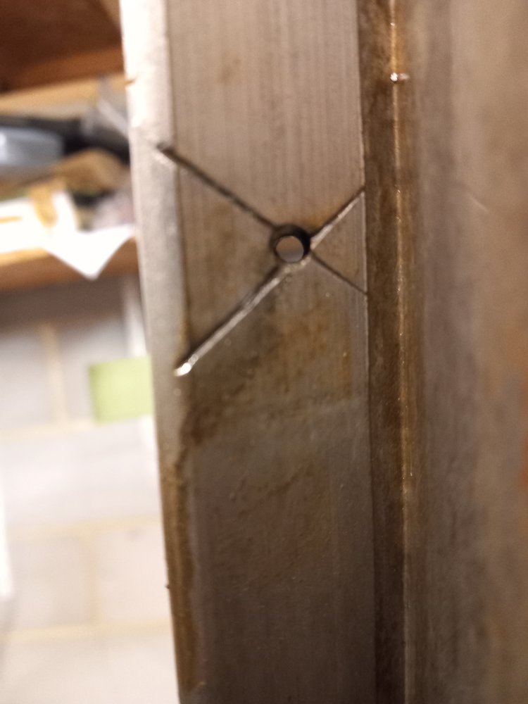

I can probably flush out and clean the ways in a satisfactory fashion as it is shown in the picture. The ways seemed fairly clean. I think all the chips and swarf are concentrated near the gib space and I could run some cord up and down there to clean it. It would be nice to properly clean up that horrible rusty patch between the ways, mind.
If I did get the knee clear I'd have very little room to manoeuvre in the cramped space left so it may be unnecessary. If I did remove it fully then the pallet would need turning 90 degrees first so there's more room to withdraw the crane back over.
I've lowered the knee back down and left it resting on the lifting column for now.
