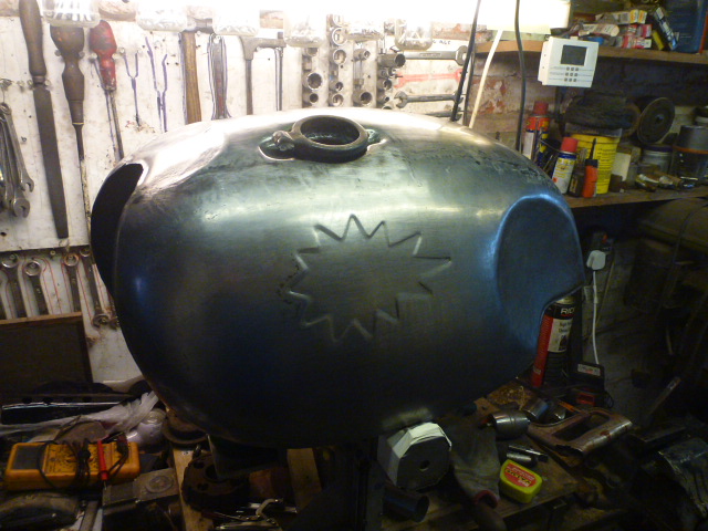

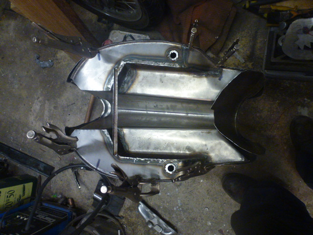

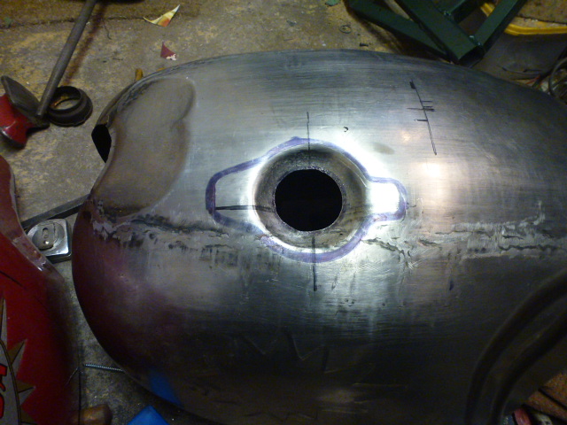

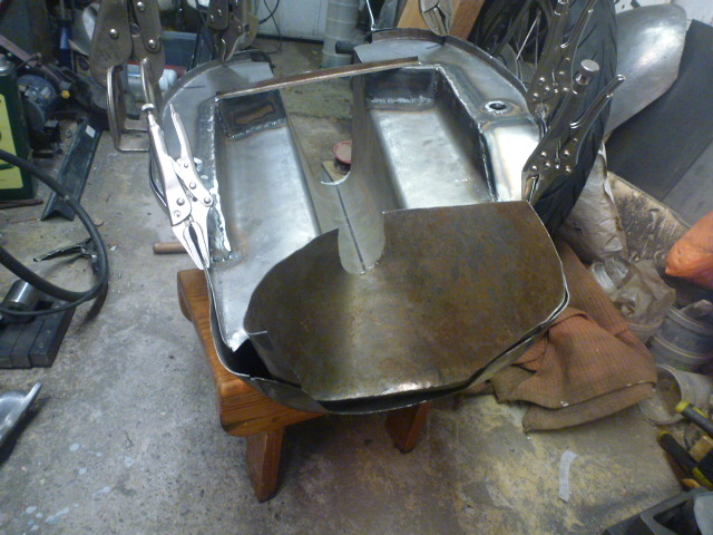

Nice bit of tin bashing
Obviously only of use once the tank is complete but 1psi of air, a paintbrush and some soapy water will find tiny leaks
Petrol can find leaks that are water tight due to the difference in surface tension, obviously gun wash would fix that but whatever you use to dye it will probably mess things up from a viscosity and/surface tension POV. The dye penetrant Drains mentioned are purpose made for the job, more detail here... http://www.mig-welding.co.uk/wiki/Dye_Penetrant the basic kits aren't spendy but are very good at dying everything in the vicinity bright redYes good point what sort of dye? I was thinking of gun wash with a paint colour rather than water, not petrol
