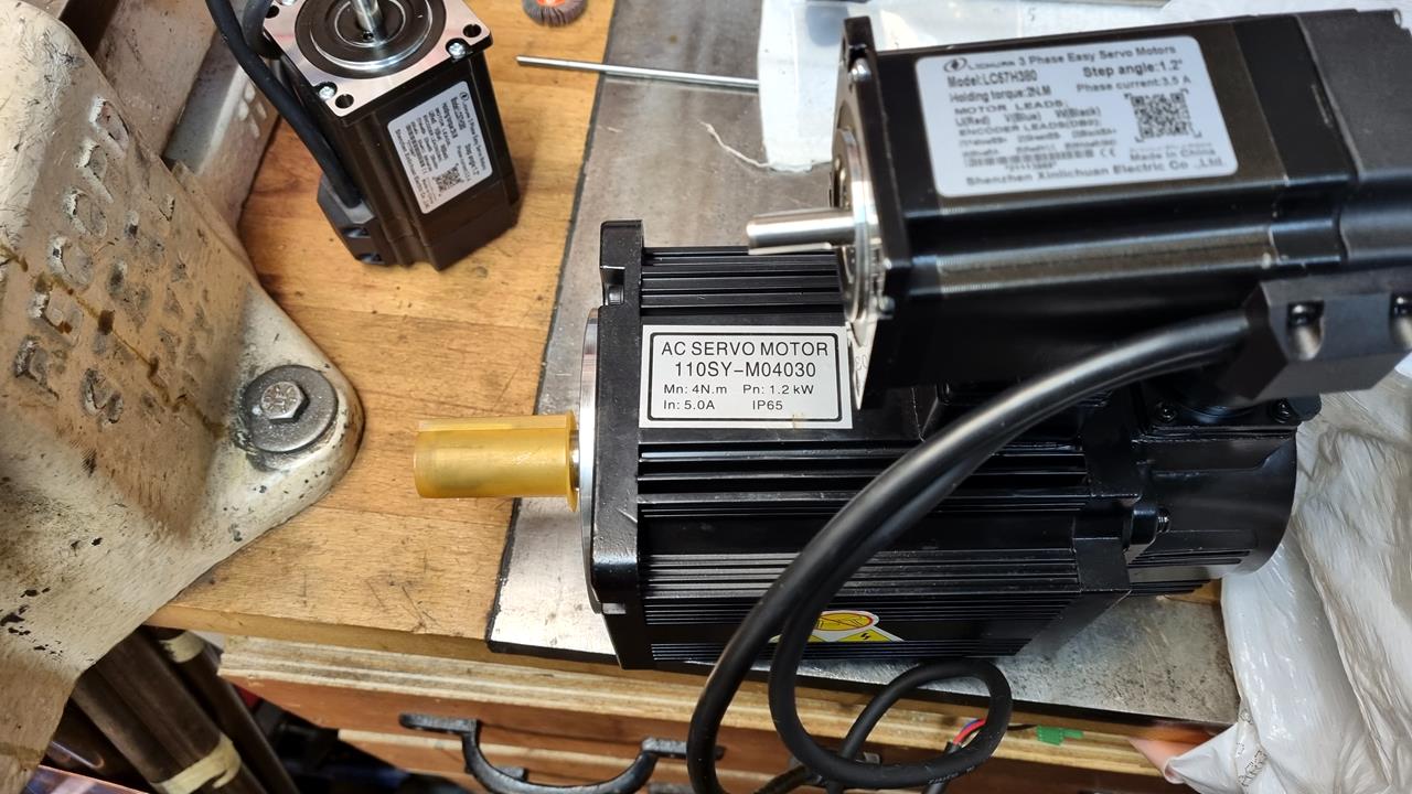

Those photos are closed loop steppers, which technically are still servos.
Essentially any electric motor that runs under closed loop control is a servo, although servo is usually taken to mean a non-stepper motor based system.
I've never went as far as using closed loop steppers, for the reason every machine I've considered using them for, I've never bothered upgrading from the original steppers, and all the bigger machines would be crippled by steppers.
However, those are 3 phase steppers, which although they do still cog, run far smoother than more common 2 phase stepper motors, and can be pushed that bit harder than an equivalent 2 phase. They do still suffer from torque drop-off, but for this size of machine, I'd say they're an ideal fit. They won't be the fastest, but when you've only got 9" of travel, low speed torque for acceleration is far more important than outright speed.
Only thing is, going for a 2:1 reduction for the Z axis may give better acceleration, given the inertia involved with spinning two ballscrews, however I'd try it direct drive first.
