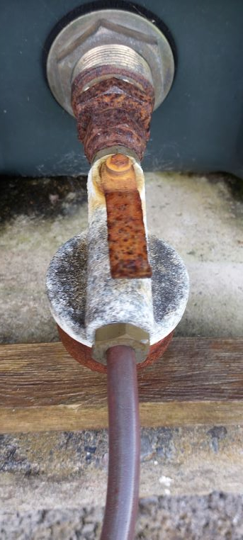

If i undo it to look, will anything fall apart?! At least i would know for sure then!That kind of looks right … probably nip up and test

I think so - even if I do have to pay a little to have someone check it who knows what it should look like, the tank was still a bargain second hand given that it retails around £3k! Impressed with the speed at which my query has been picked up as well - you cant fault Kingspan for that or the detail of their answer.Good result though
ImpressiveEven better - the chap I was speaking to at Kingspan has offered to have their engineer take a look and change the seals FOC if I can wait until next week. I thought good customer service was dead - apparently not!

I think you are right. But they have offered to come and check it and change the seals, then torque it up correctly so I would be silly not to accept that offer i think!If I'm reading the Kingspan response correctly then the large silver nut in your original photo should be tight against the outer tank face with an o ring behind it and all you really need to do is gently turn it to ensure that it is tight. You would then support said nut with your adjustable to stop it turning whilst screwing in you valve assembly.
Agree and I will try as I am curious as to the setup too - I think I have it figured out in my head now but we will see.First class response from Kingspan I think, any chance you could take a few pictures of the assembly when he replaces the O ring. I can send biscuits if it helps.
