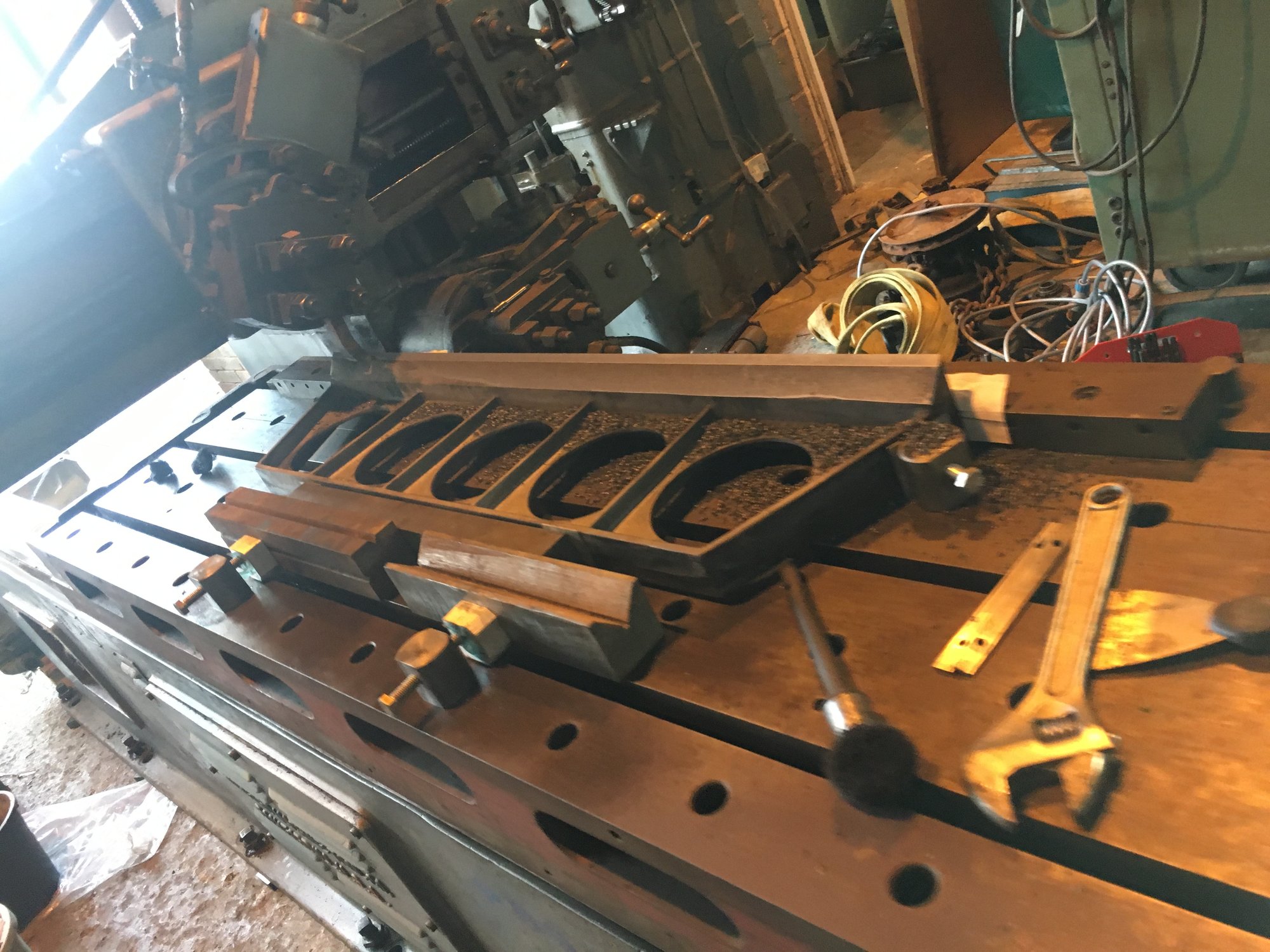

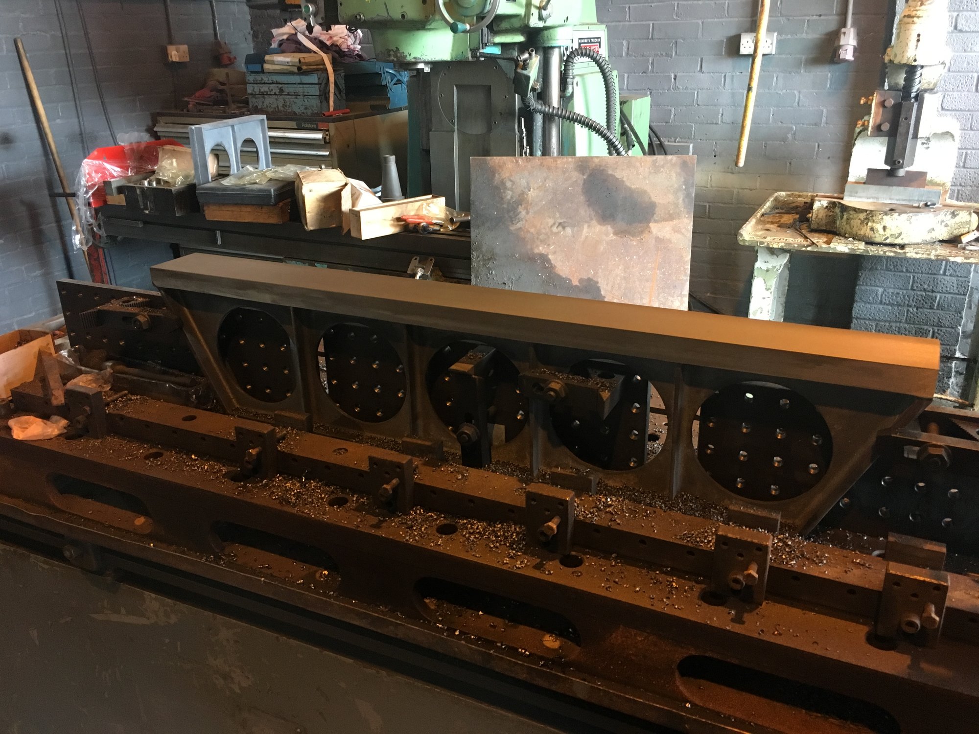

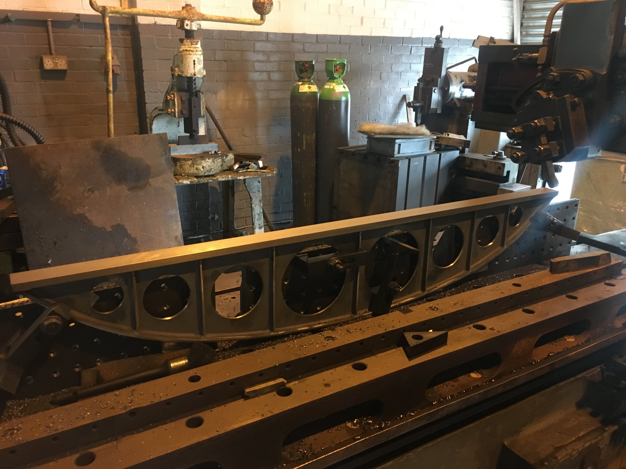

Oh no a excuse to make a pattern for a 36” camelbackI gotta get a dovetail model of 32", I guess I could use a 30. It's for scraping my cylindrical grinder. Only trouble is I'm not sure I have any good way to hold the thin table without it bending under it's own weight. I guess I could support it at about 25% in from each end.
If there’s a good area to clock I’d put it on a surface plate and experiment moving support s to find the airy points.I gotta get a dovetail model of 32", I guess I could use a 30. It's for scraping my cylindrical grinder. Only trouble is I'm not sure I have any good way to hold the thin table without it bending under it's own weight. I guess I could support it at about 25% in from each end.

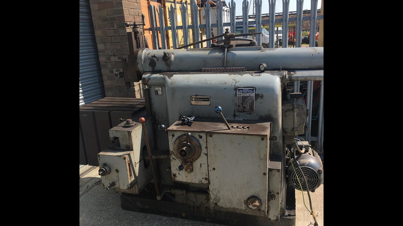

whys that .if it were the case they would still be in service in most machine shopsWonder how flat it comes off the shaper. Far better than off a mill I imagine.
Yes much betterWonder how flat it comes off the shaper. Far better than off a mill I imagine.
perhaps @Pete. will explain. I don’t have the stamina to explainwhys that .if it were the case they would still be in service in most machine shops
was talking about a shaper not a planer .the planer is more accurate and can handle a lot larger stuffperhaps @Pete. will explain. I don’t have the stamina to explain

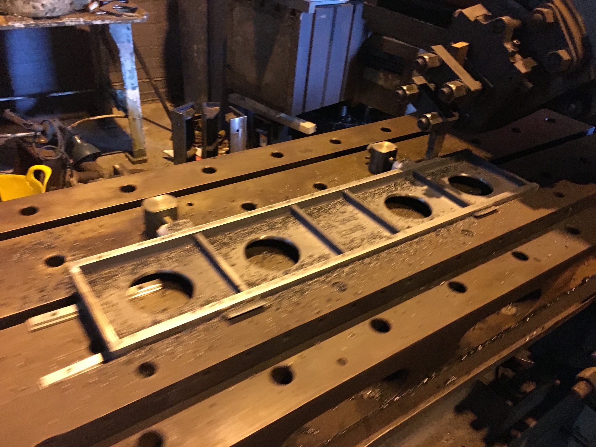

that is true but a shaper doesn't and isn't as accurateA milling cutter is a rotating tool that inherently has an interrupted cutting action, or at least variable loadings. The planer uses a static tool and a steady, constant cut. Aside from that there is the matter of sheer mass and surface contact/weight distribution. The planer table rides on a huge surface where it's supported most of it's length, and has large mass. Just the clamping arrangement in the photo above weighs more than your average small milling table.
Why doesn't every machine shop have one? They are huge, and slow, and specialised in use. We no longer have the industry in the country that requires the common use of such machines.
My butler toolroom shaper is dead bang accurate though a shaper won’t stay accurate as long as a planer willthat is true but a shaper doesn't and isn't as accurate
Planers aren’t obsolete, the work has gone off shore.
