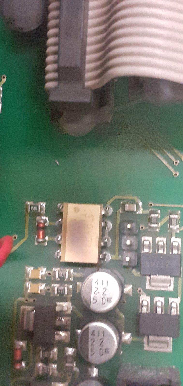

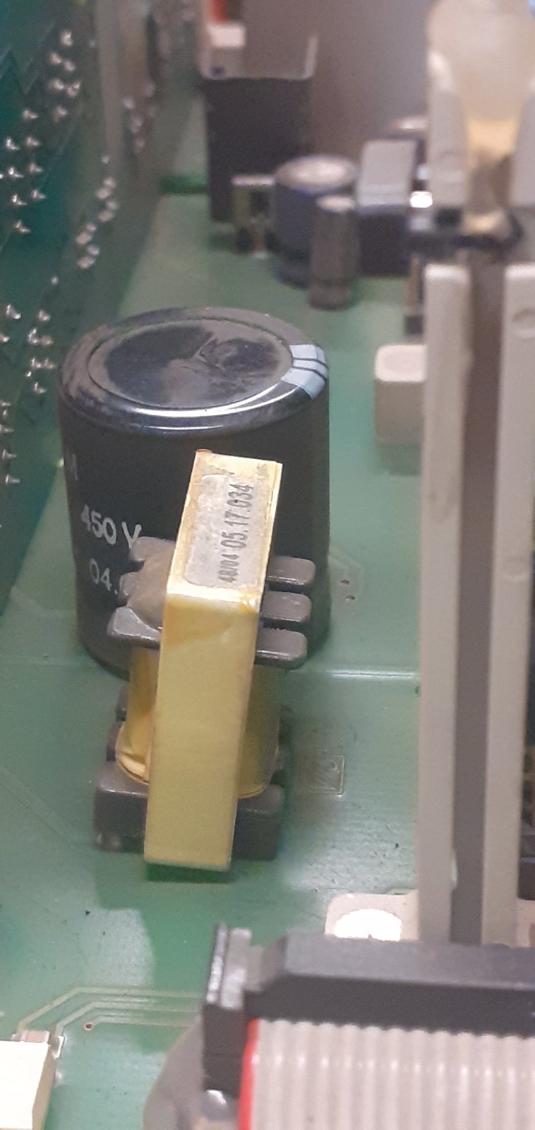

There is a small chip which looks to have got hot and 1 capacitor that the top is very slightly raised, but next to the capacitor is a little transformer type component that is emitting a high pitched squeel/crackle when turned on and stays for a few minutes , I'll get some pictures.Any damaged components visible?

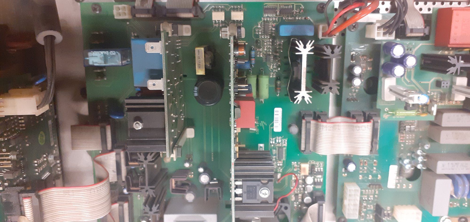

I'm not sure what I'm looking for to be honest?Could get very tricky.
Any controller ic in these area?

If -25.5v is for driving any Igbt there is a chance that gates getting blown.
Dividing by 1.414 ( square root of 2 ) means your AC supply is 417v. I hope that you have appropriate test equipment, with well-insulated clip-on leads rather than hand-held probes, and PPE ( at least a pair of Class 0 gloves ) ?I have 590vdc across the capacitor
