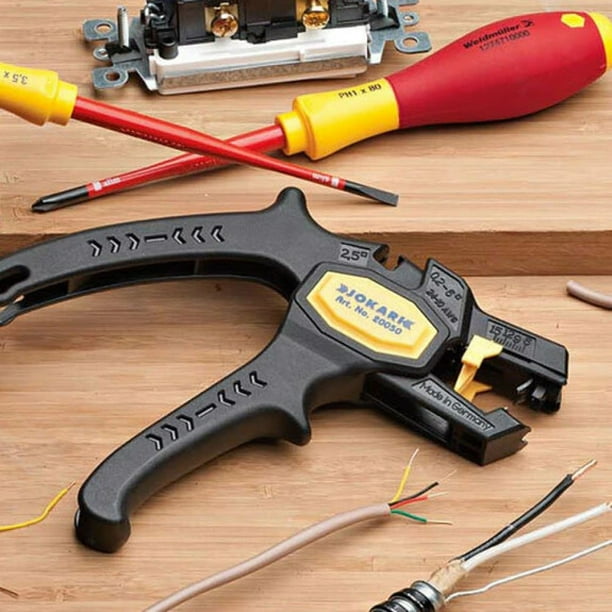

i have a set of those. i only use them on on 1.5 mm lighting twin and earth thats loose out of the ceiling there no use for stripping cables in socket or light switch boxes as u cant get them to strip far enough back i normaly use knipex side cutters for thatI have the CK ones at a similar price , I'm impressed with the range of sizes , specially the smaller data cables it manages to strip.
They don't use a blade like some clones , it's purely a tension pulling operation.
I've been using them for a while (not every day tool but regular) and they seem to be doing well.

only down side's
Some 2.5mm flex its a struggle to fit the sheath in it.
If the cable insulation is old and "shinny", they sometimes struggle with it
The ruberised tough flex , it doesn't always strip the same length as the insulation stretches.
Sometimes a piece of insulation gets stuck in the mechanism and you have to pull thinking face to figure out whats going on.

Jokari do some excellent gear - I had a wire stripper for larger cables made by them, it was very good.I've had this for 3-4 years now and it's been great

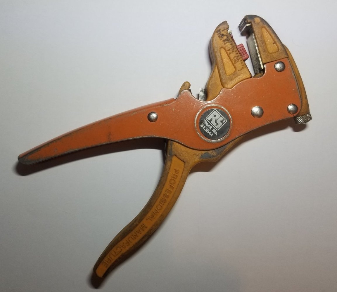

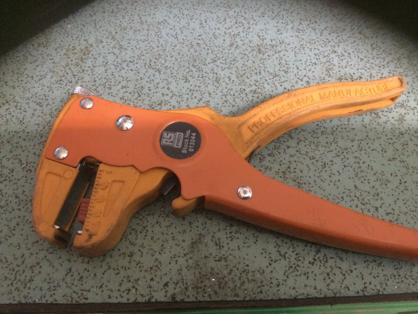

Another vote for the RS strippers, I'm on my third set after wearing the others out, probably stripped 10's of thousands of wires while panel building.
I use these exclusively, I'd resisted after all real men just use shears it's a tool I love.
I had to strip a pvc cable on a truck now with a knife and shears I'd almost certainly damage the inner wires, the sheeth had gone horrible tough perished the way it does, these did the job with no complaint
