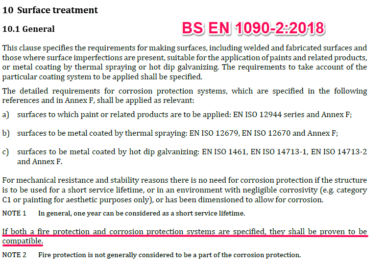

I have heard there are new specifications for fire proofing exposed steel,is there a requirement for this on ground floor,external steel,any confirmation of this? Thanks.
This is something that has been updated in the new NSSS 7th edition, however I’ve not had a chance to go through it yet as very busy and it’s not mandatory until January. You can get a copy from BCSA though.
