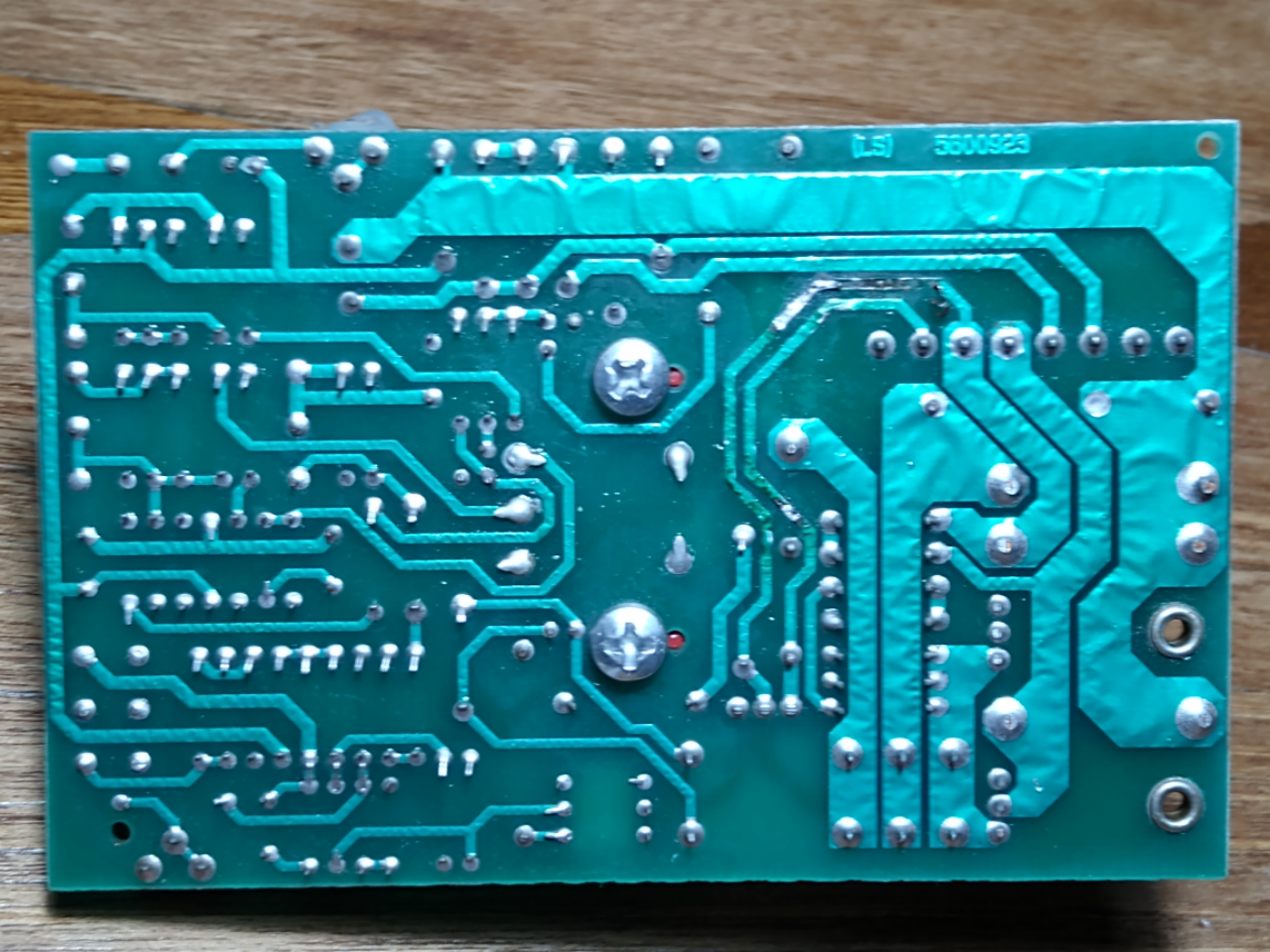

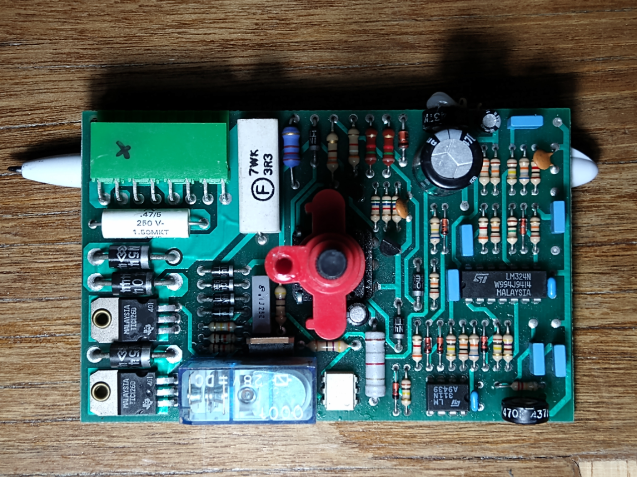

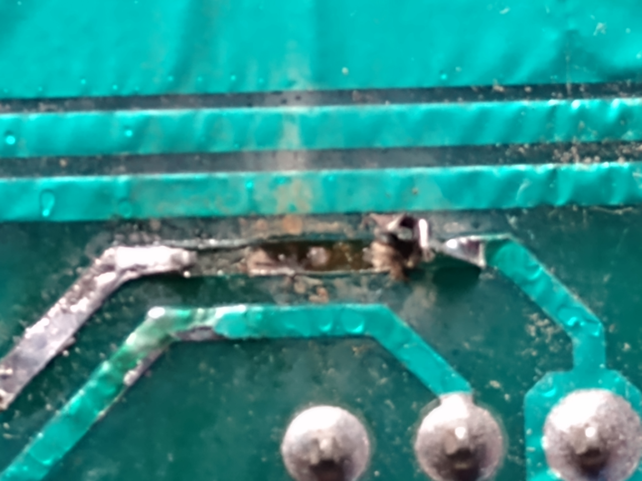

I've detected a possible cause of my problem. I disconnected the power, tied the trigger closed and did a continuity check on the wires from the PCB where they showed. I got a reading on one of the 24v out wires but not the other and looked closely at the back of the pcb just to trace where it went and there was a very small damaged section of copper trace. Now I need to figure out what to do about it.....
