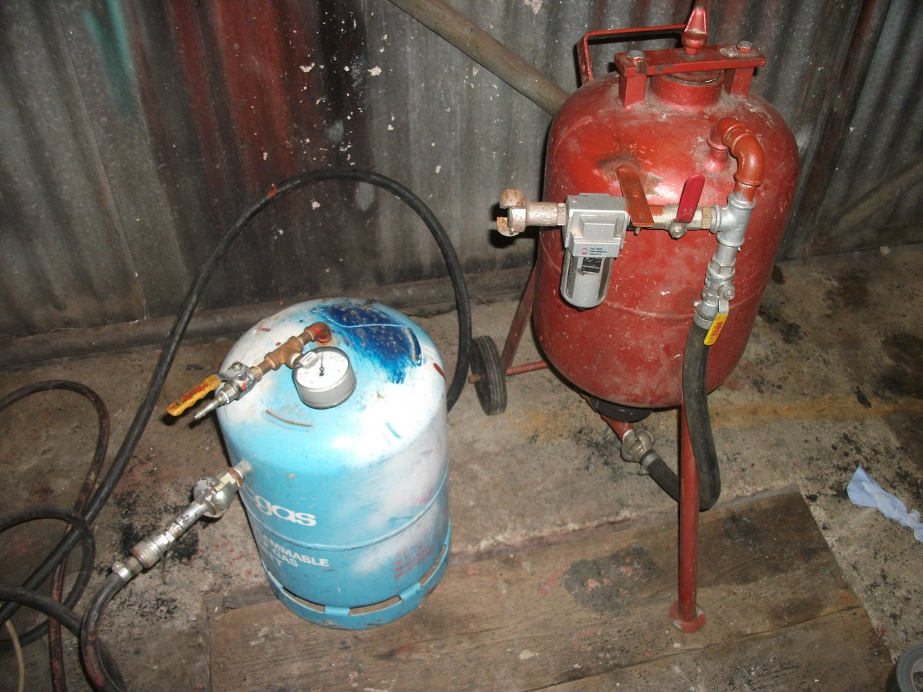

add a TEE fitting just after the main valve, valve on bottom of tee, dumps to ground (add a muffler to keep noise down, and stuff from blowing around)i just shut mine off at the water seperator when done and the air in the pot just peters out along with the supply of media to the jet
no needadd a TEE fitting just after the main valve, valve on bottom of tee, dumps to ground (add a muffler to keep noise down, and stuff from blowing around)
So how much abrasive keeps coming out when it bleeds down ?no need
verry little just turn it off a few seconds before your finished and it expiresSo how much abrasive keeps coming out when it bleeds down ?
Ohhhh kinda hard for me to do that.verry little just turn it off a few seconds before your finished and it expires
built both of mine over 40 years ago and another couple besides that i sold there copied of a hodge clemco mini pot apart from the filler neck and topOhhhh kinda hard for me to do that.
IIRC the commercial set-up uses a pinch hose on the remote control system.if you realy want to stop it doing it you have to shut the regulating valve off to stop the sand then shut down the air supply .when starting up again turn on air supply and re regulate the sand .its a fanny on but doable
not on the 90cfm 6.omm jet ones they dont on the larger set ups they do its a choke valve with a rubber core and a choke wheel to adjust the flow or as u say on the remote https://www.ebay.co.uk/itm/302716645810?_ul=UK&mkevt=1&mkcid=1&mkrid=710-53481-19255-0&campid=5338353466&toolid=20006&customid=s%3AGS%3Bgc%3ACjwKCAjw0N6hBhAUEiwAXab-TSRk8sH2PbvuYL6_gP-AWeylQICv0DBXYXYR0T1J7NuXwzi3bBW4CBoCkm4QAvD_BwE%3Bpt%3A1%3Bchoc%3A2&customid=s:GS;gc:CjwKCAjw0N6hBhAUEiwAXab-TSRk8sH2PbvuYL6_gP-AWeylQICv0DBXYXYR0T1J7NuXwzi3bBW4CBoCkm4QAvD_BwE;pt:1;choc:1&gclid=CjwKCAjw0N6hBhAUEiwAXab-TSRk8sH2PbvuYL6_gP-AWeylQICv0DBXYXYR0T1J7NuXwzi3bBW4CBoCkm4QAvD_BwE i have one i dont use as its 2 large bought it by mistakeIIRC the commercial set-up uses a pinch hose on the remote control system.
