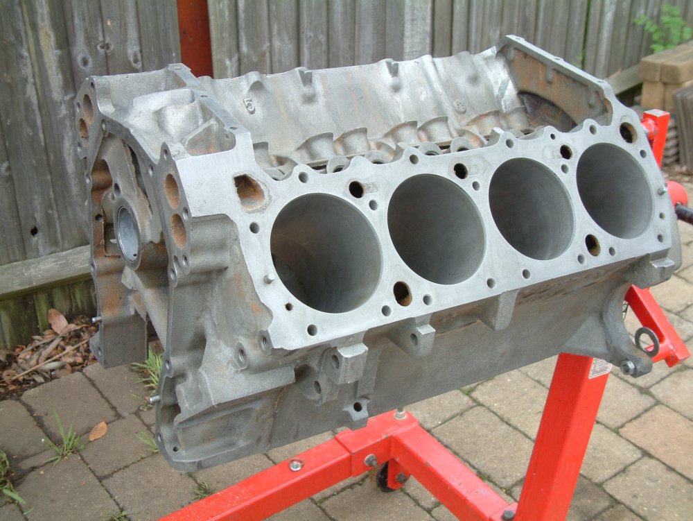

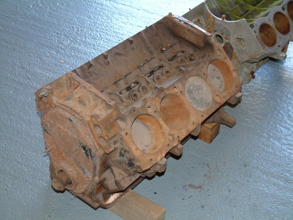

I reckon if those pulleys in post #41 and the coupler had been donw with a wet sandblast they would have come up a lot better especially the pulley.
) its 15mm so thats about right.If you're doing that a fair bit? you would be wise to go down the wet sandblasting route must cost a bomb in Citric acid and having to lift and haul it in and out a few times,couldn't be having that me.
No way will I use sand or media on an engine block as there are too many places for it to sit ready to ruin nice shiny bearing surfaces.
Take it you have used this ?
