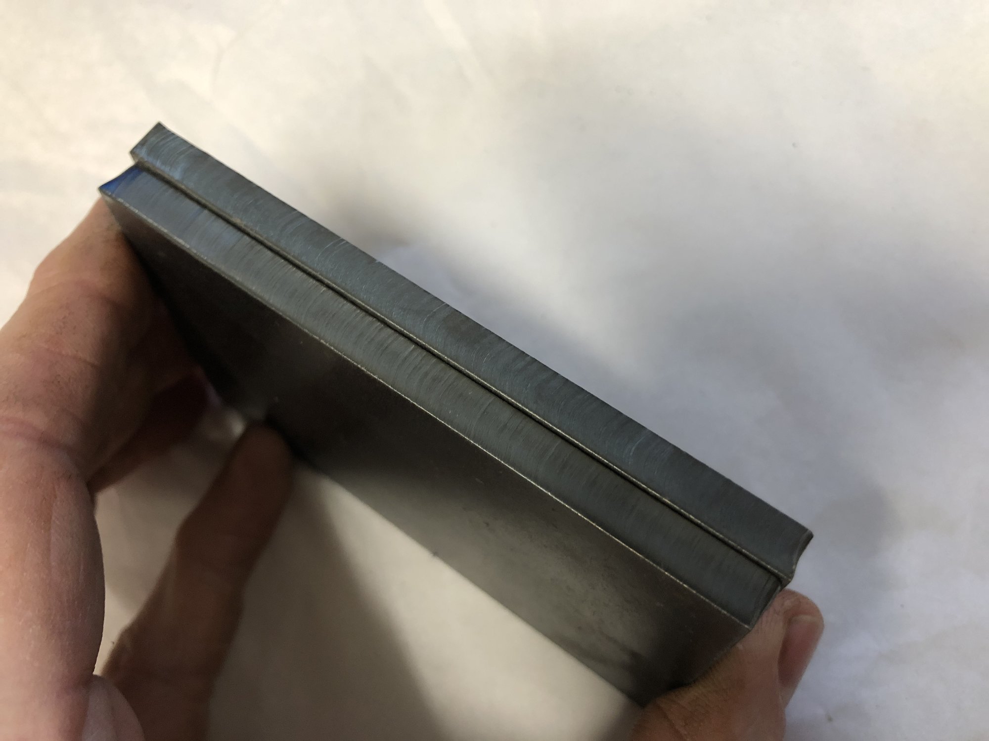

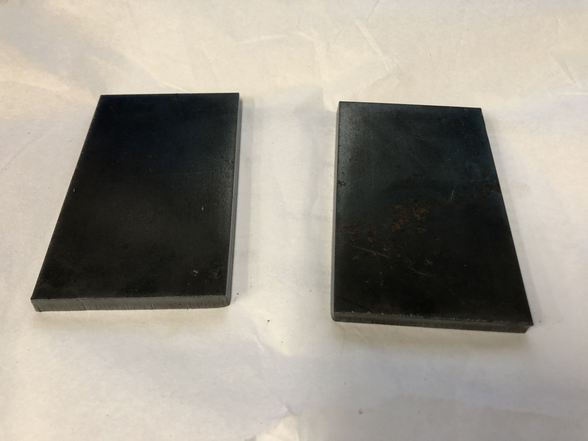

I like how you went for a nice easy cut for the first attempt.
I find with the plasma if it cuts right for the first minute it will cut right for half hour.In for a penny in for a pound lol.

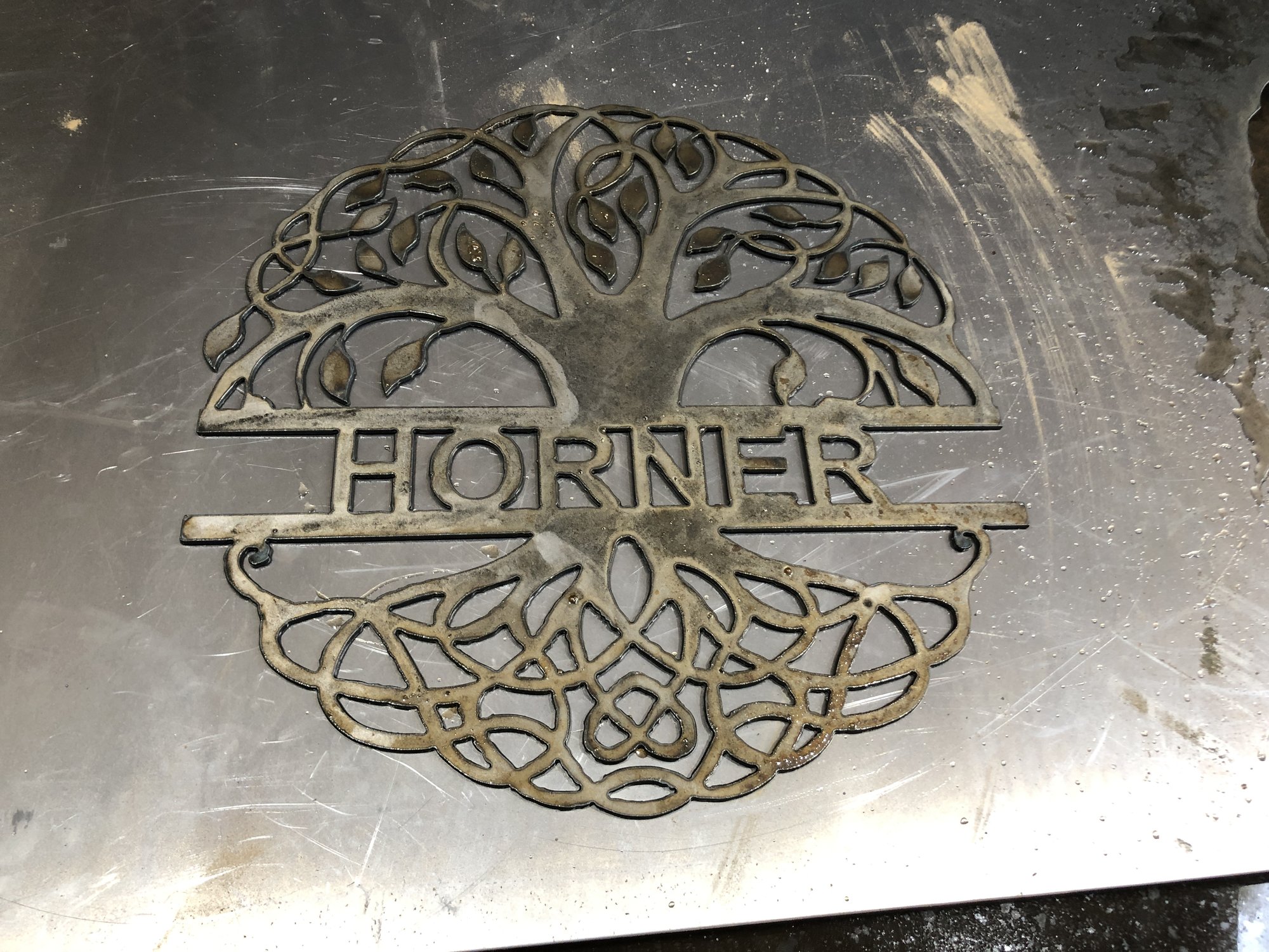

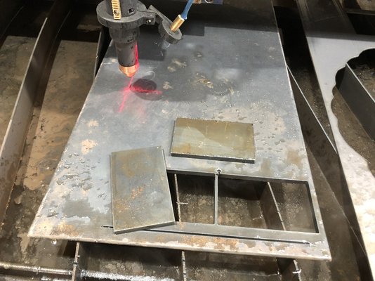

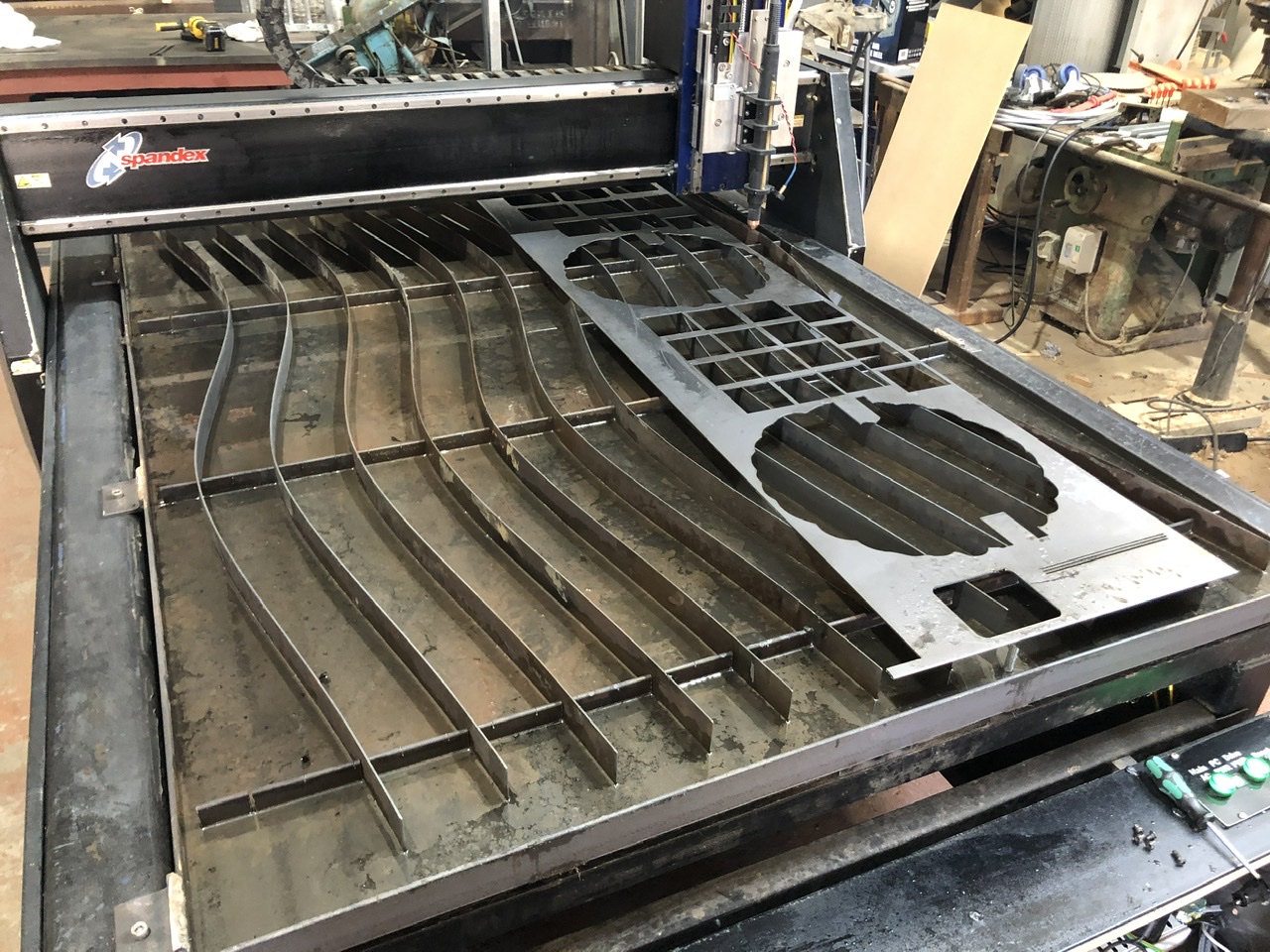

That’s exactly how my bed is. Best design in my mind.Lots of small test coupons cut today, getting a feel for the speeds and voltage settings. I also cut the slats for the bed.
