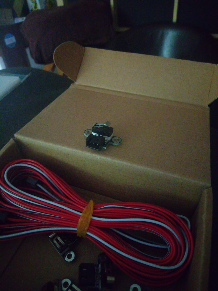

I could only get NO to work with my board. What board are you using?
Grbl Arduino based I believe.I could only get NO to work with my board. What board are you using?

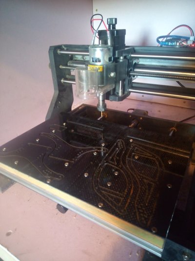

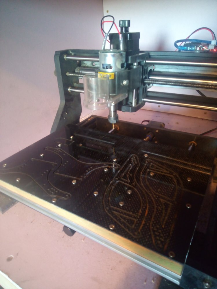

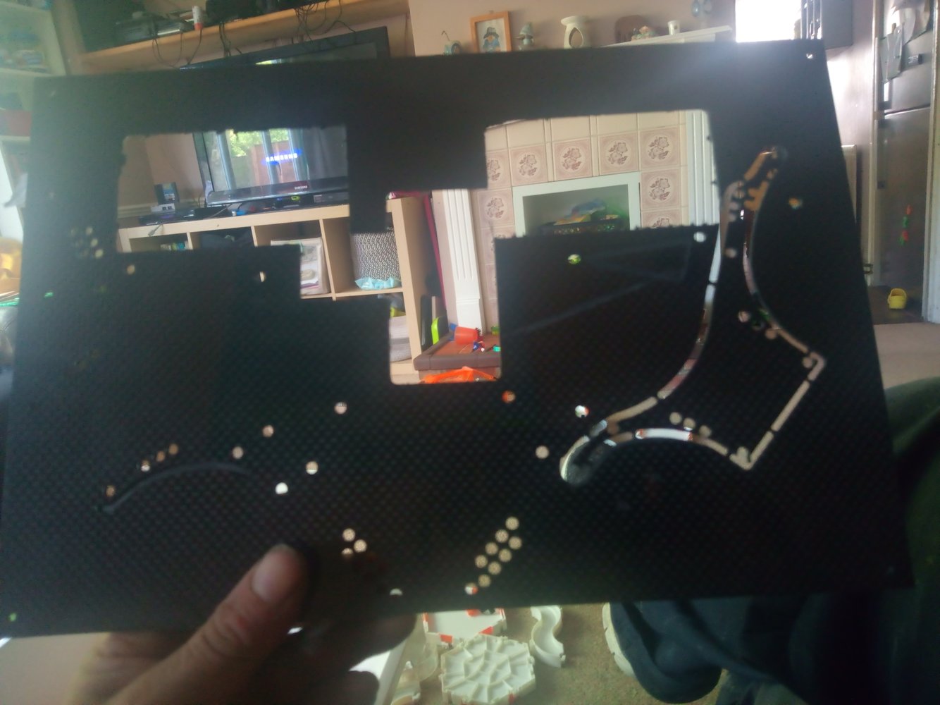

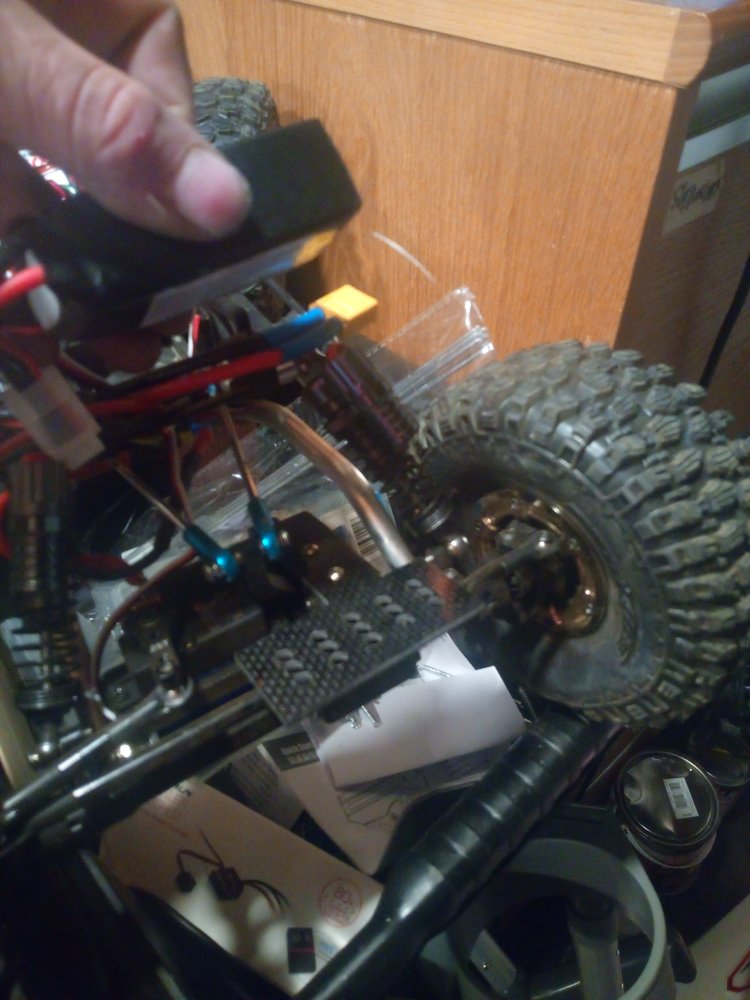

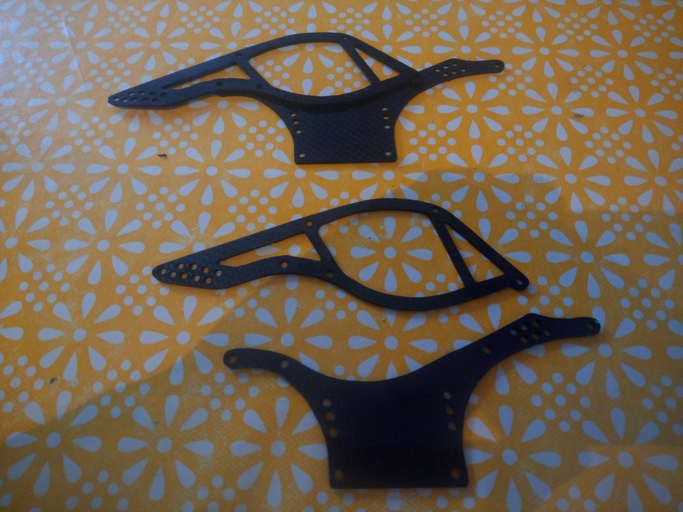

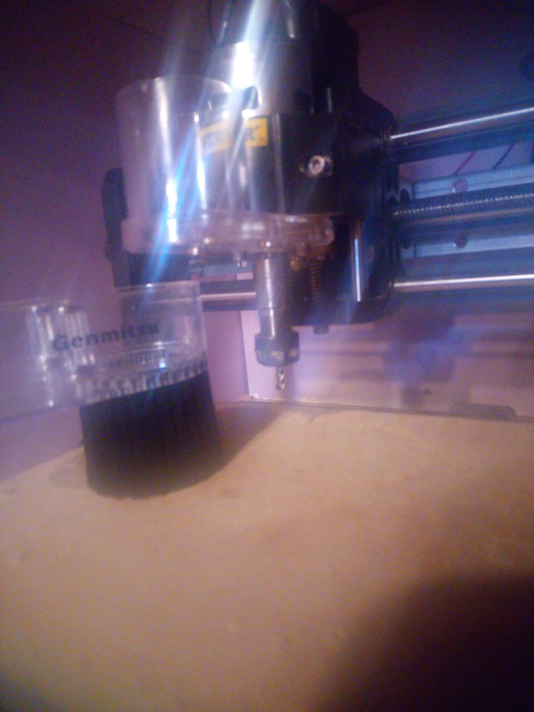

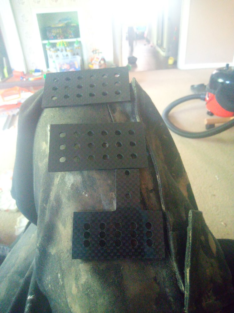

Its looking good apart from that though!!Trials and tribulations.
Pocket holes went well.
Workholding not so much.
4 holes around the outside and screwed down with double sided tape holding the middle.
Must have let go as the tabs were cut through on a middle piece.
Vibrated a bit loose and broke the bit.
Set up to have another go and forgot to swap to outside the line.
Spray glue. More CF and some new bits arriving tomorrow for another try

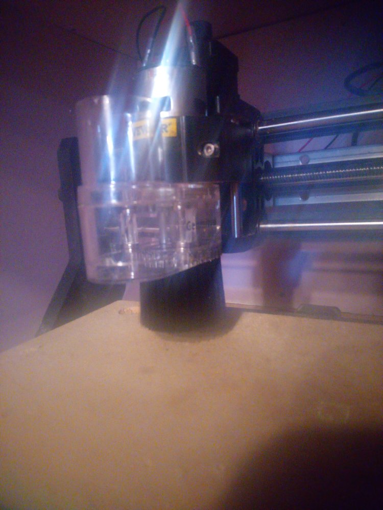

Bushing in the z axis vibrated themselves out today. Gonna have to try and sort them out.Its looking good apart from that though!!
That's my plan. Needed a reference to start from. For the £120 I paid it's giving me it's money worth both in functionality and experience.It's interesting what can be done with these machines, but they're never going to be a great machine, as they are built to a price.
Main thing I'd recommend them for, is learning the basics, and to guide people to what they actually want from a CNC router.
When you start upgrading them, you start entering the realm of chasing small gains, which are never going to result in a great machine, until you've replaced pretty much all the components.
You're far better to just built something from scratch, using good components, as you'll usually end up with a far better machine that requires far less tinkering to keep running well.
