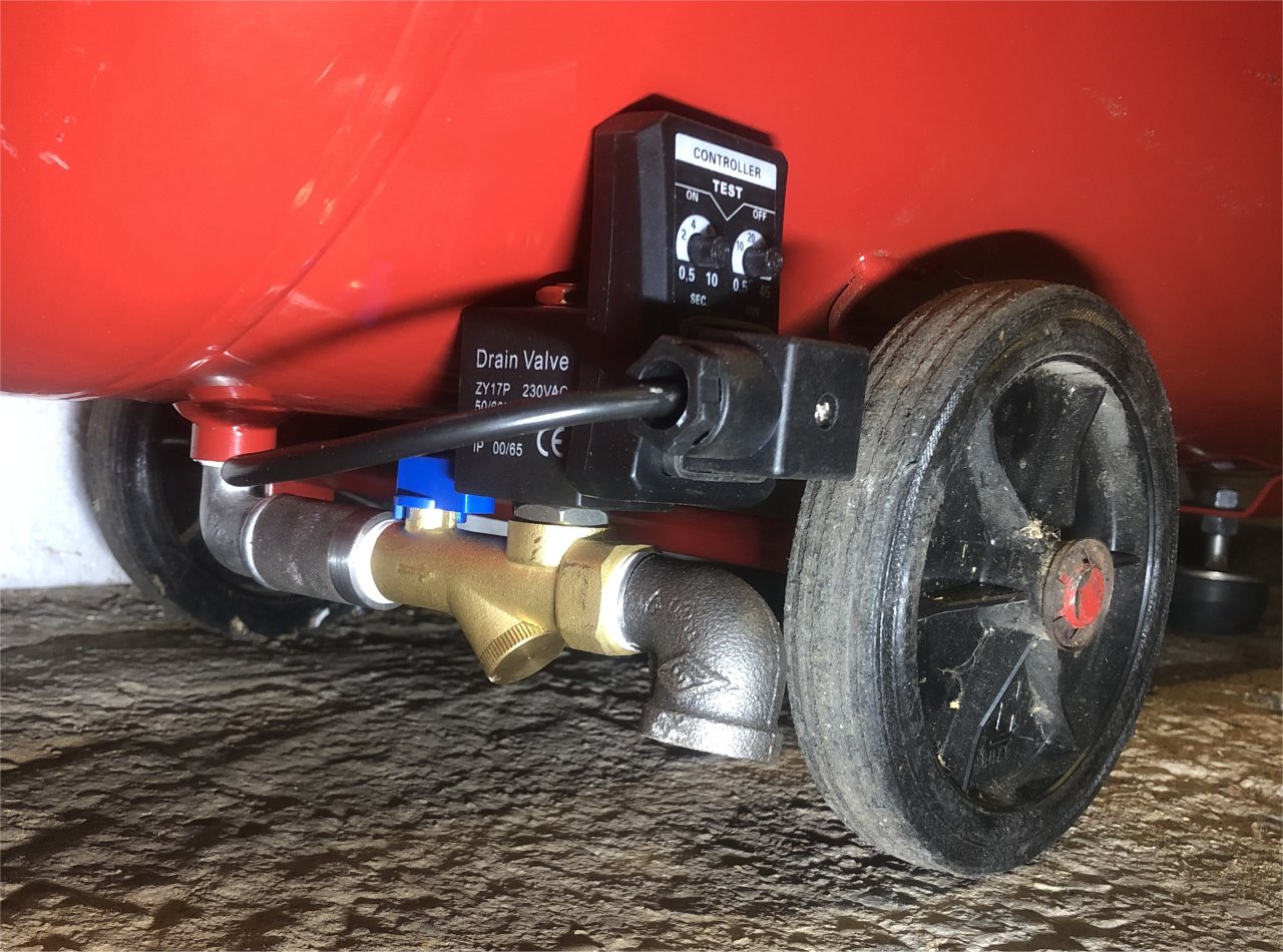

Bloody good idea. I've never seen that done, yet it makes perfect sense. Any remaining condensate in the pipe is negligible compared to a tank that's been neglected and got lots in it.Use a length of flexible tube between the elbow and the drain valve and mount the drain valve up and out of the way. Often the best place on a mobile compressor is on the side of the table-thing the pump and motor are mounted on.
With 100-150 PSI behind any condensate, the drain valve doesn't need to be at the low point. I generally like to put it somewhere it'll get seen and the test button will get pressed. Codgerhood means that ain't on the floor.
With stationary compressors, it's often on the wall. With mobile compressors, it's often on the side of the table-thing. With the mobiles, there's usually a long series of fittings needed to mount the valve to the bottom of the receiver, which makes for a long lever and is very prone to breaking when the compressor is moved.

Consider a valve then a flange union then a short length of pipe makes getting it easier

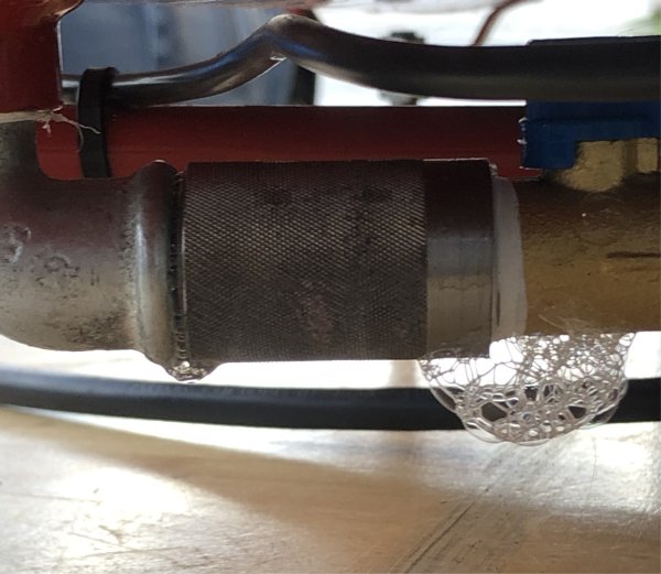

That f-f looks cockeyed /cross threaded.many joints are leaking.
some are tiny bubbles to this big one.
clearly ptfe tape aint doing the job.

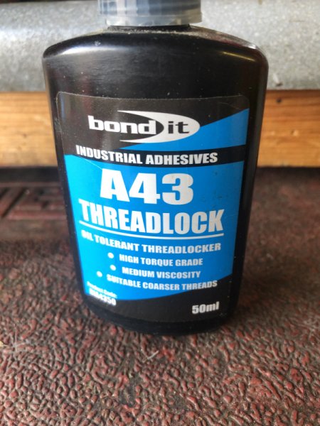

so would thread lock be better?
or is there something else i need to get to make all the joints air tight.
