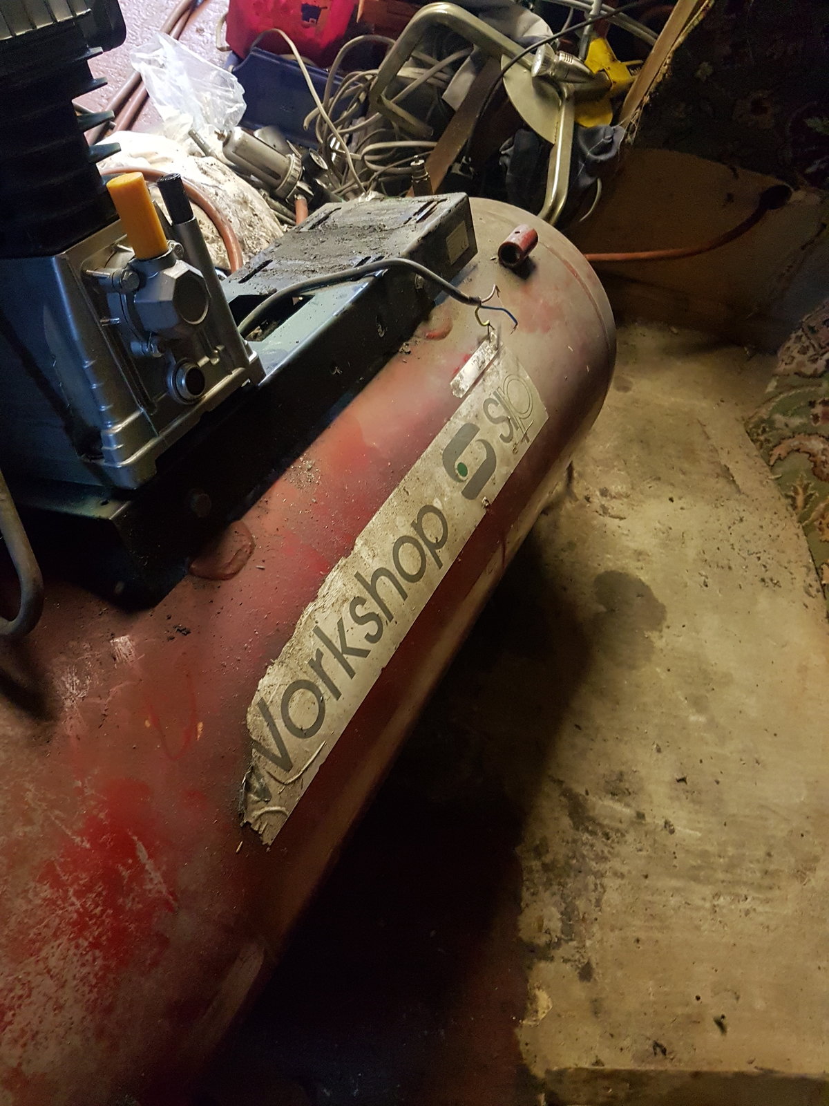

I have a motor on my compressor that will not start under load.
It hums loudly and trips the MCB.

Its been fine and just suddenly started playing up.Had similar issues with the motor on one of mine. Had to pull the release valve above the piston to let the pressure out then the motor would start.
Yes it does start fine without the belt on...Mine wasn't a motor issue. The motor couldn't turn because too much pressure above the piston stopping it turning the crank.

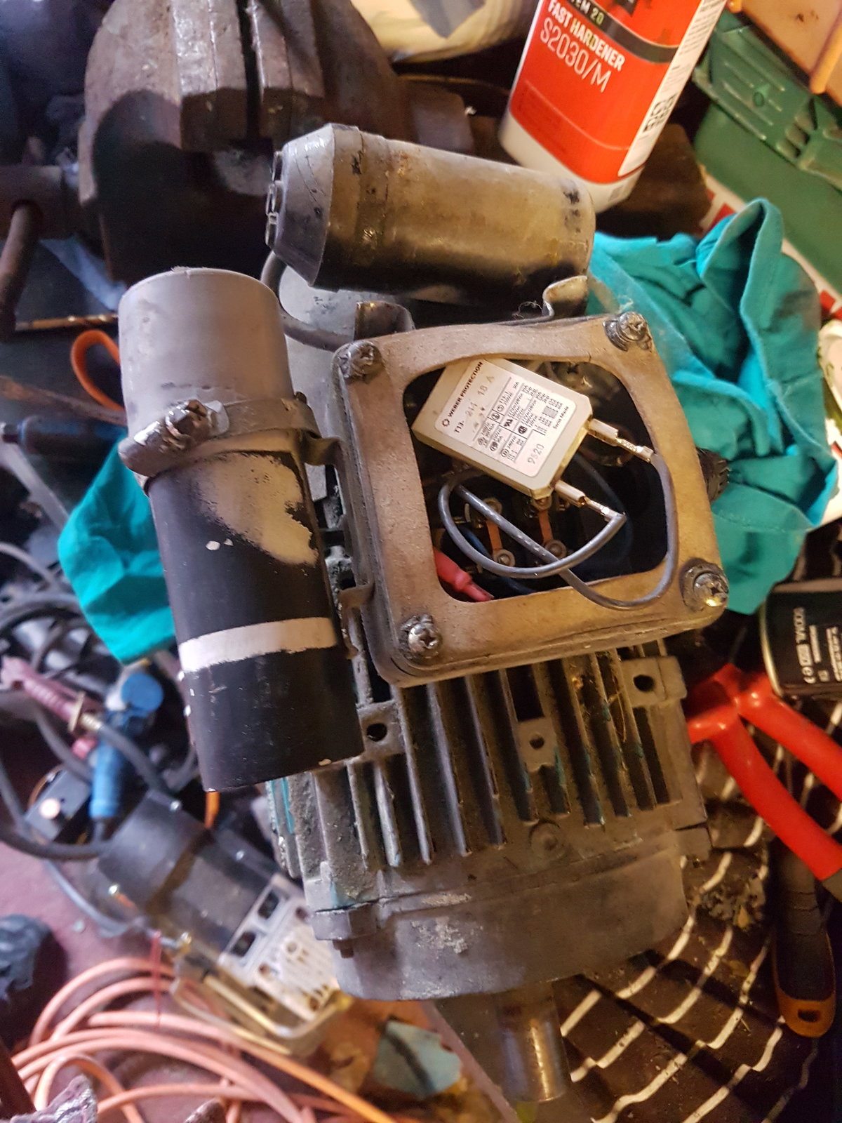

Switch seems clean and free. I am guessing its got a start and run capacitor.. just a guess though.It may have a switch in the motor to switch one of the capacitors out when its up to speed, and the switch may be stuck. Or the capacitance may be lower than the tolerance rating on the capacitor.
So perhaps not a motor issue at all. Worth exploring. Have you got something else you can use to load the motor to test. Or another motor to test on the comp.Yes it does start fine without the belt on...

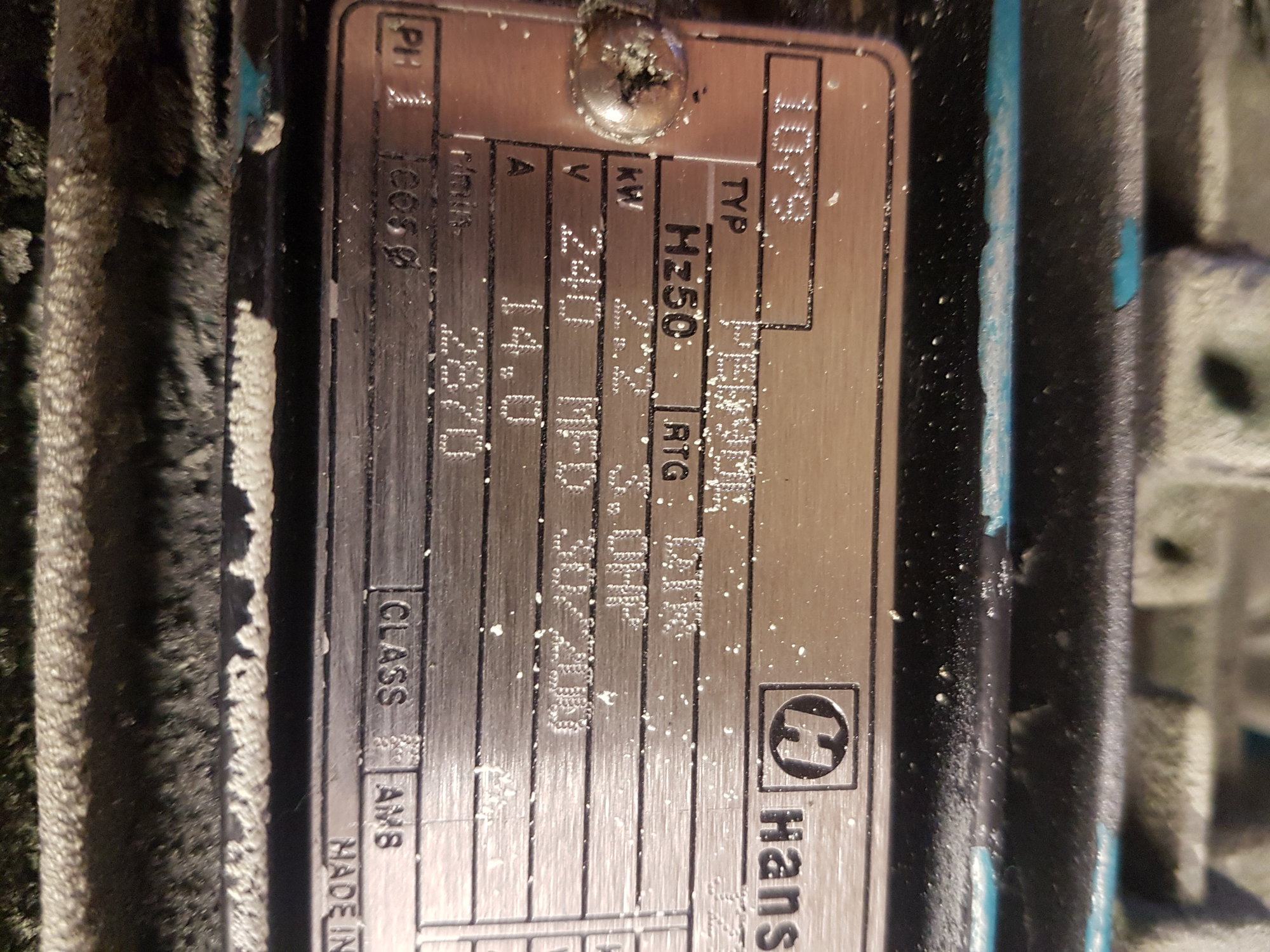

Problem is i cànt see any markìngs on the caps.....i need to search for the model in the morning i know its a SIP thats all till morning.If it has a start cap these usually have a higher capacitance value than the run cap. Depending on speed and motor size the run cap could be 40 - 80 uF and the start above 200 uF.
Well the pump is new But......it has worked fine for 2 days...just started playing up today.So perhaps not a motor issue at all. Worth exploring. Have you got something else you can use to load the motor to test. Or another motor to test on the comp.
Will it start when the tank is empty and the outlet opened?
Still wont start....just hums and trips.Did you try this?
