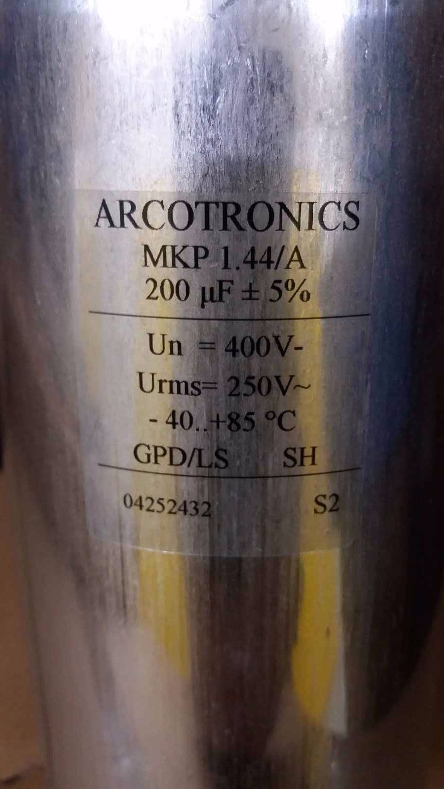

Does the pump turn around freely by hand?Still wont start....just hums and trips.
There seems to be no difference to starting the pump with the tank full or empty.
Yes as much as they go plop plop plop to create air.Does the pump turn around freely by hand?
I was just leaving...lolIf there is a motor rewind place close to you, go and see them. When I’ve wanted the odd capacitor, they’ve had a box of second hand ones recovered from scrap motors. Also they can probably test the ones you’ve got to see if they’re duff.
Well i left and got it fixed...they always say go with your gut feeling. It was indeed a start capacitor. 20 quid later he had one out of his box (as kindly suggested on here as an option) as he had no.new ones.I was just leaving...lol![]()
