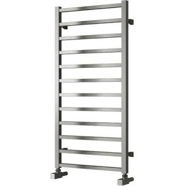

Silly question but.....has anyone thought of using a small radiator for the condensation trap line instead of piping?
Ones like those upright bathroom stainless steel type.....mind you copper pipe will be cheaper. :-)
Car rads are usually only rated to what, 2bar? house rad sounds a good idea, though even if you use plastic pipe a copper coil could be put inline to aid cooling and condensing.
i have a couple of myson wall convector radiators with fan blowers on them. there 15mm and will take the pressure i just cant be bothered to conect one up though
 lazy old sod.
 lazy old sod.
Stainless steel wouldn't be a good choice for a cooler as it doesn't radiate heat very well?
If the stainless steel rad doesn't radiate heat very well then why do they use these rads in bathrooms? I do feel I should get the housing to change mine as it doesn't seem to heat the bathroom up very well and believe it or not its a very small room,something like 6ftx6ft? and in winter its still coldish for getting a shower.
Any evidence for backing stainless rad up as a poor radiator to install in the bathroom so I can sling it on their desk for confirmation to change it.View attachment 58976

its more of a towel warmer in the bathroom and take the cold air off the room
