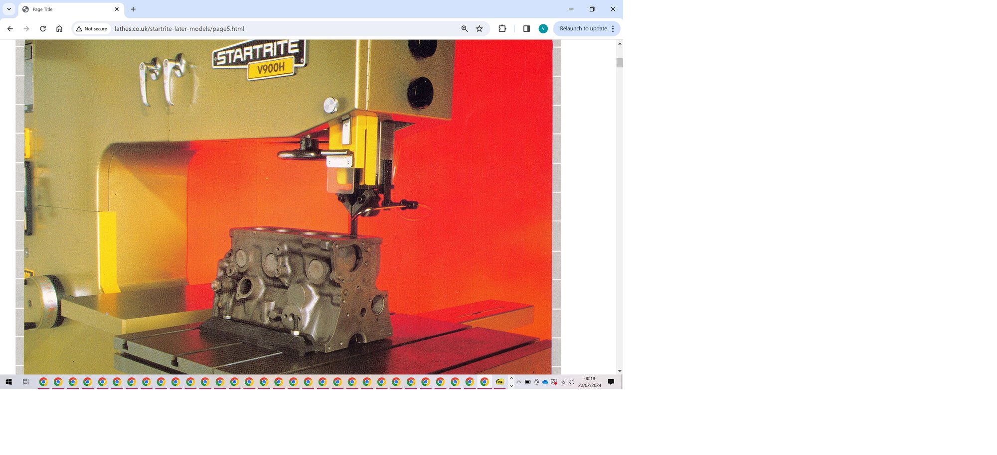

I have 2 huge metal cutting bandsaws you are more than welcome to use!A weird one

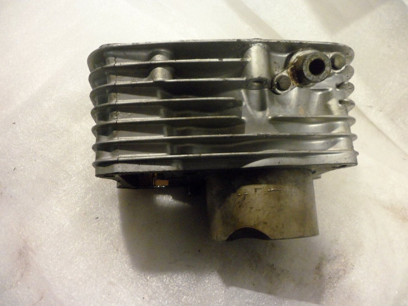

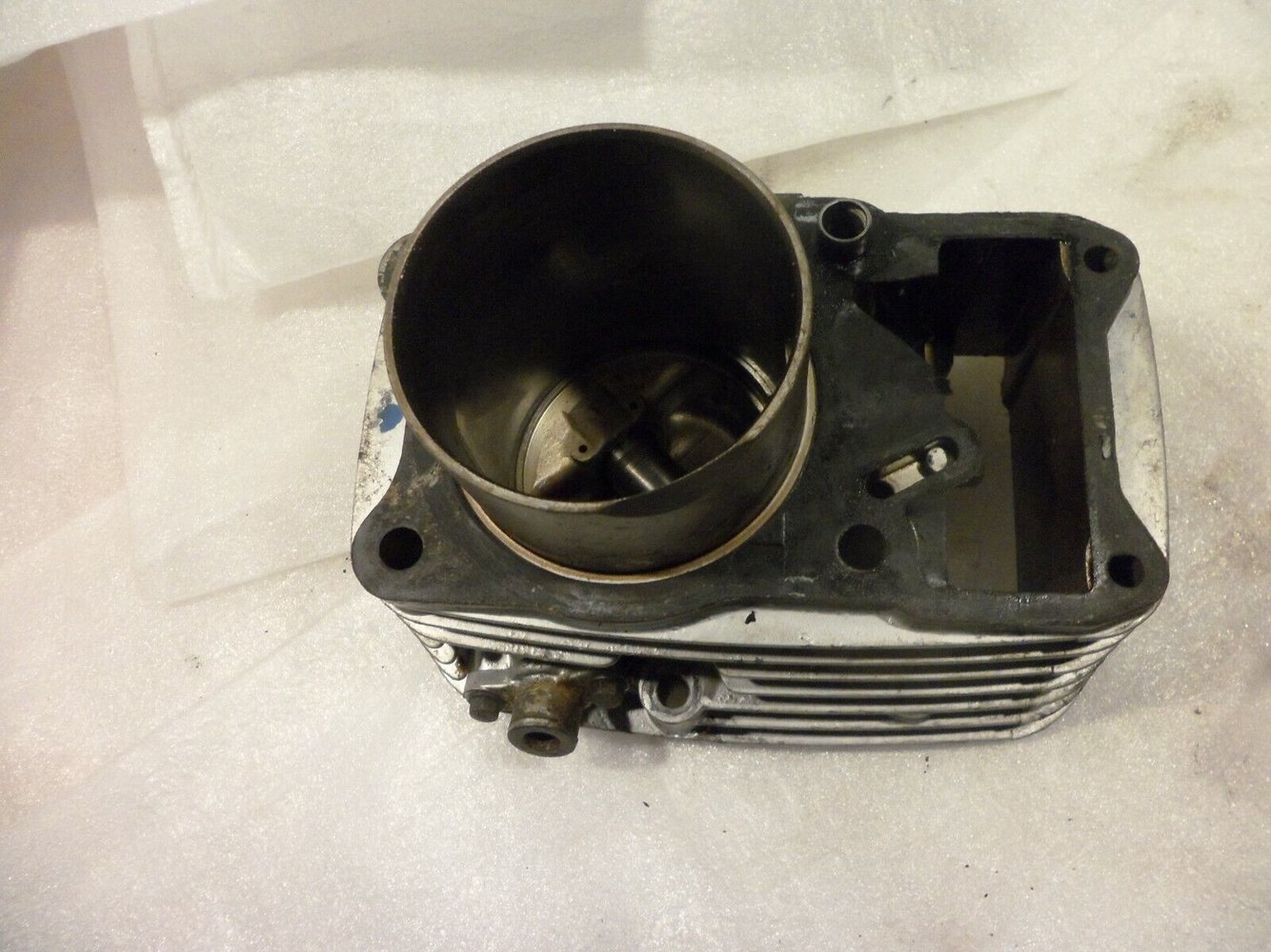

I have a job coming that involves butchering a bike. No details until I know I have got the job.
it might involve cutting the barrels in half. Its a V twin so they are accessible (dont panic it's only a 916).
Plan A involves having said barrel secured and taking the 9" angry grinder to it. pics below. I may have to lop the camchain tunnel of to make space.
Looks like they have steel liners. Might be a laugh?
Chop the bottoms off the liners first
I dont have a bandsaw but reckon that might do it mounted vertically with a small table and jig to guide the barrel along

Makes my Sealey 6x4 bandsaw look like a toothpick!
Looks like it might just manage.
