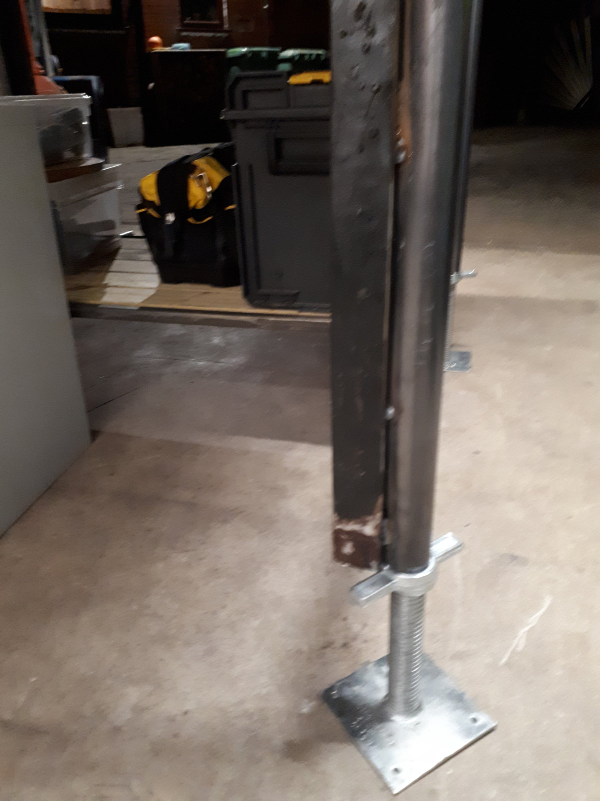

Today's objective was to upgrade the table so that it can be adjustable for level and be moved easier through the use of casters and scaffold jacks. Ordered a length of 48.3mm x 3mm CHS which was cut down to ~26 inch; just an inch longer than the full length of the threaded portion of the scaffold jacks. I wanted to totally cover the threads rather than just use little sections of the CHS to help avoid weld splatter and other debri damaging the threads or otherwise making them harder to adjust.
I was contemplating cutting the frame down some, so I can could install the CHS on each existing leg, in the inside corner of the angle which the legs are made out of. Having thought about it and considered a few ways to best achieve what I was aiming for, me and my Dad who was helping me opted to just affix the CHS to the outside of the existing legs, simplifying the upgrading process.

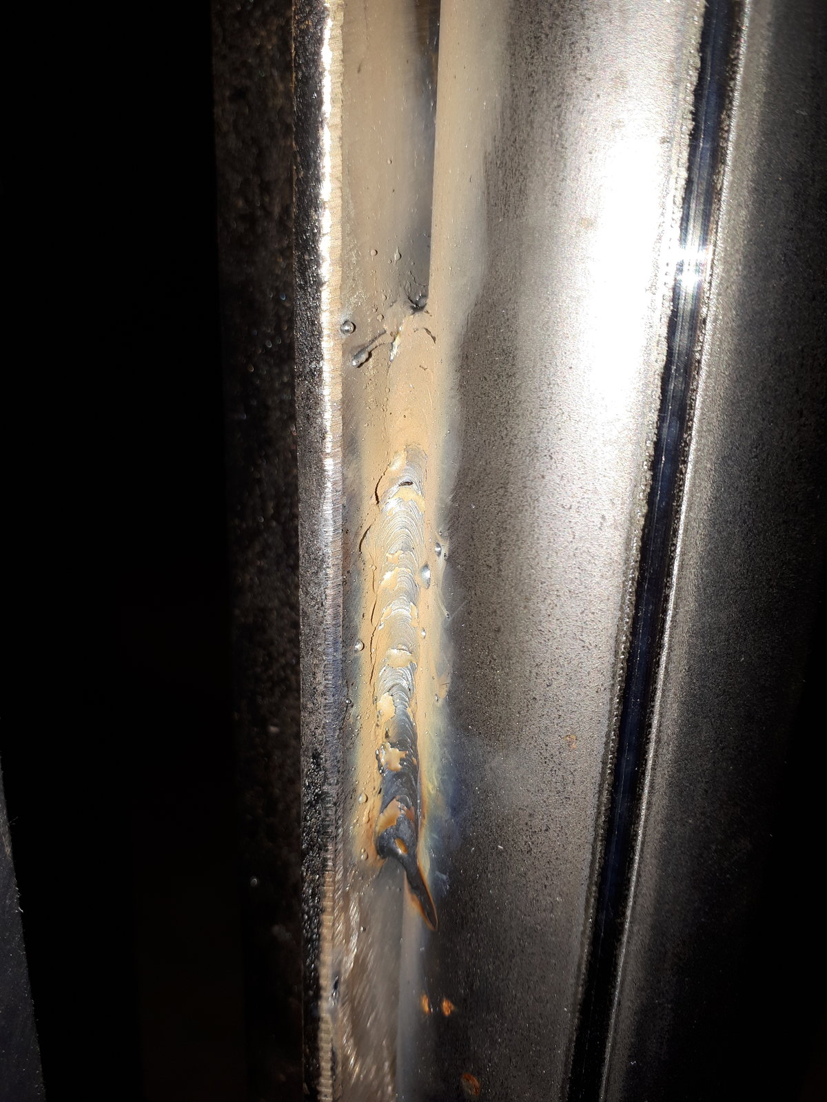

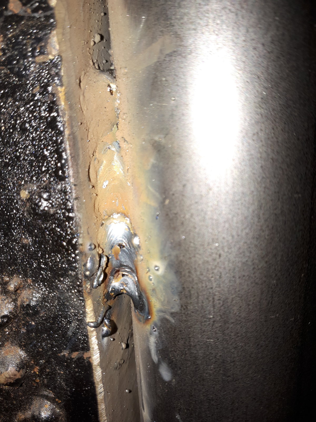

The first leg was quickly tacked, but all of the "welds" looked awful, you couldn't really describe them as welds, it was more luck that some blobs managed to stick and hold it in place. It felt like I needed what power I had, perhaps even slightly more, despite the CHS only having a thickness of 3mm. Playing around with it, the spool ran out, and I'm not sure if it was me getting into the flow more or perhaps the end of the previous spool wasn't too great, but a change of spool for what no brand wire I had left and I was making much better progress.
All of the little runs of welds I made to attach the CHS to the existing steel angle legs were done in the vertical up or vertical down position; I tended to prefer vertical down, but ended up doing a bit of both depending on how best I could get into position. The contact area for the joint was actually quite deep in, so my stick out was longer than usual; I'd begin striking an arc favouring which ever side I felt had the stronger connection to the return. Weaving between left and right, watching for the front of the puddle I'd form a keyhole type shape and tried to keep adding material to it whilst following the front of the puddle down or upwards along the joint.
View attachment 207914 View attachment 207916

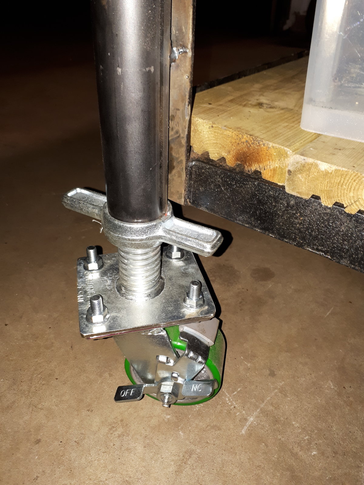

I only bought two casters at this stage, as I wanted to benefit from saving money if I didn't need them and wanted to see how stable and maneuverable the table would be with only two. These two casters were bolted to the base plates on two of the scaffold jacks and the bases were later cut down to make it easier to access the break and so fit up would be easier - and people will to hurt themselves on the protruding base plates.
Once all for sections of CHS were attached, the table was tipped up on one side, then the other, while the legs were shortened - this was a necessary step so that the jacks with the casters on could move freely without hitting the existing legs. It took two attempts to get this right, as the first time the scaffold jacks were not seating very well on a bit of protruding frame, which we ended up removing.
I was disappointed the reasonably level table, after all of this effort was now a mile out in every direction; but I'm glad that there is some adjustability now, and we dialed it in somewhere close before calling it a day. The table is still really difficult to move with only the two casters and adjusting it to get the table as level as possible is much harder than I expected, but I'll live with it for a few weeks before deciding to throw more money at it. If nothing else the table seems to have stiffened up a lot.
It may end up with four casters on, as originally envisioned. I'm also thinking of coming up with some solution so the scaffold jacks can be held attached to the table for when the table is lifted to make adjusting easier without having the legs fall out.
Next priority will be to add a bit more weld to one of the CHS legs, the other three should remain firm as they are.
View attachment 207913View attachment 207915

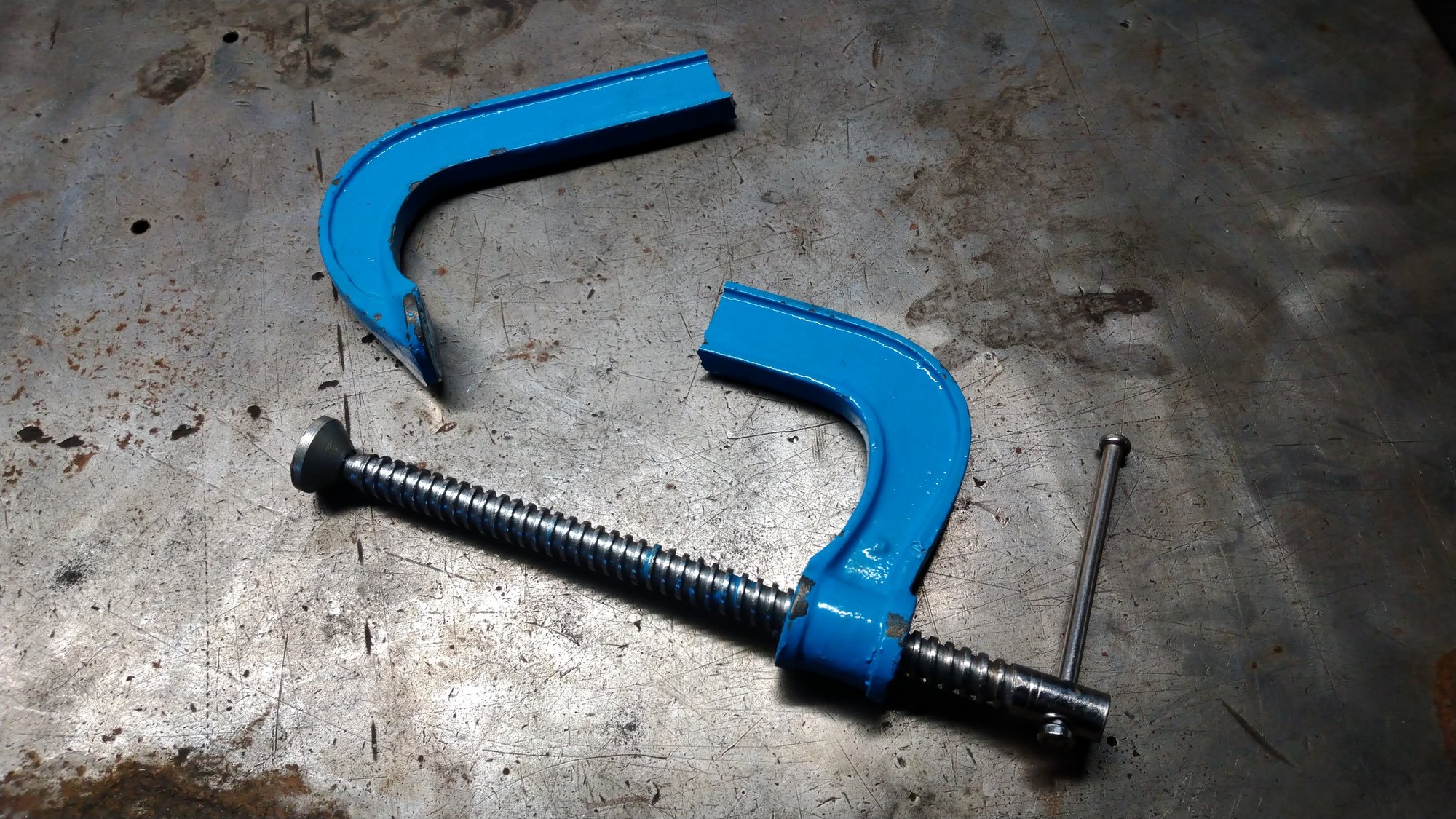

until one of my c clamps gave up and blew apart.
Will avoid Ebay for my clamps in future. Guessing it was cast aluminum, my other one appears to be steel.
