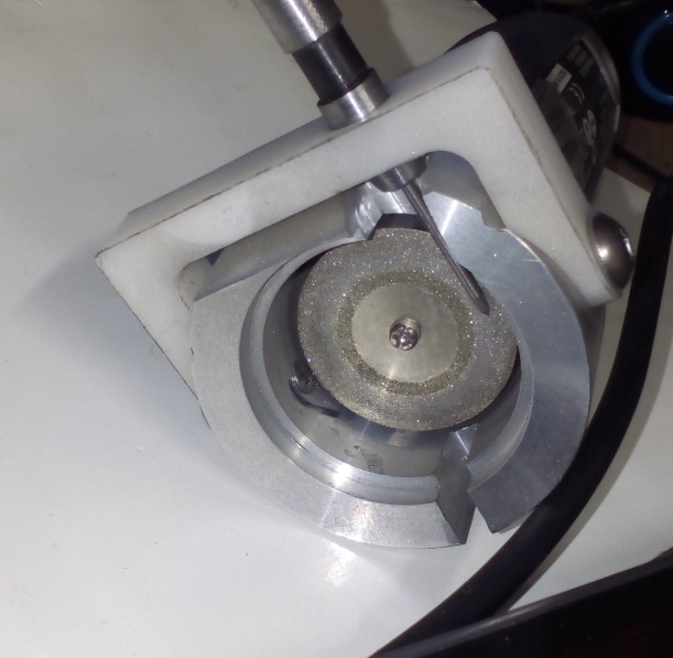

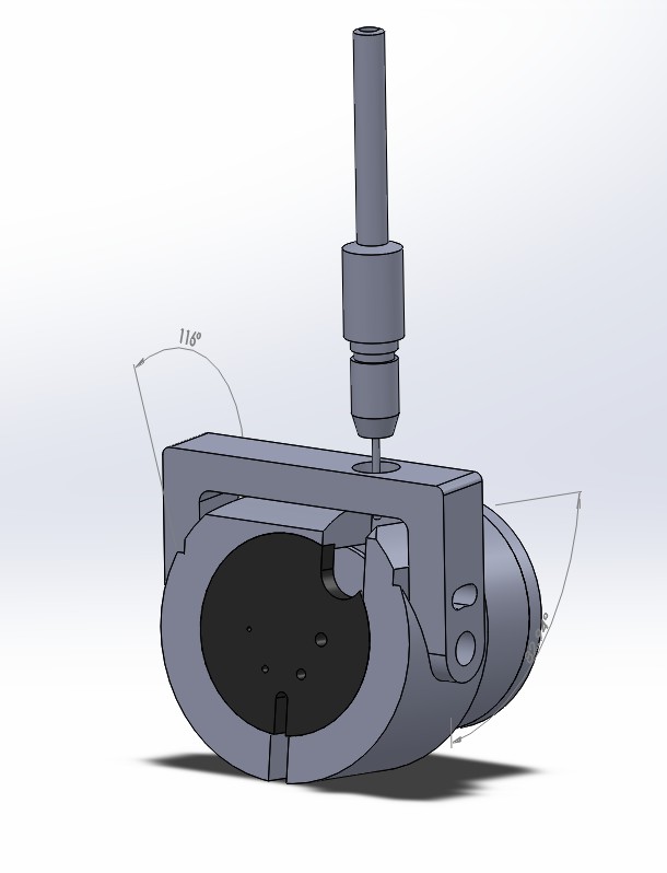

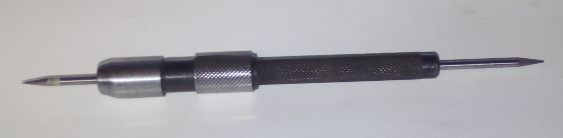

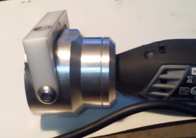

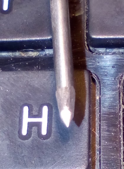

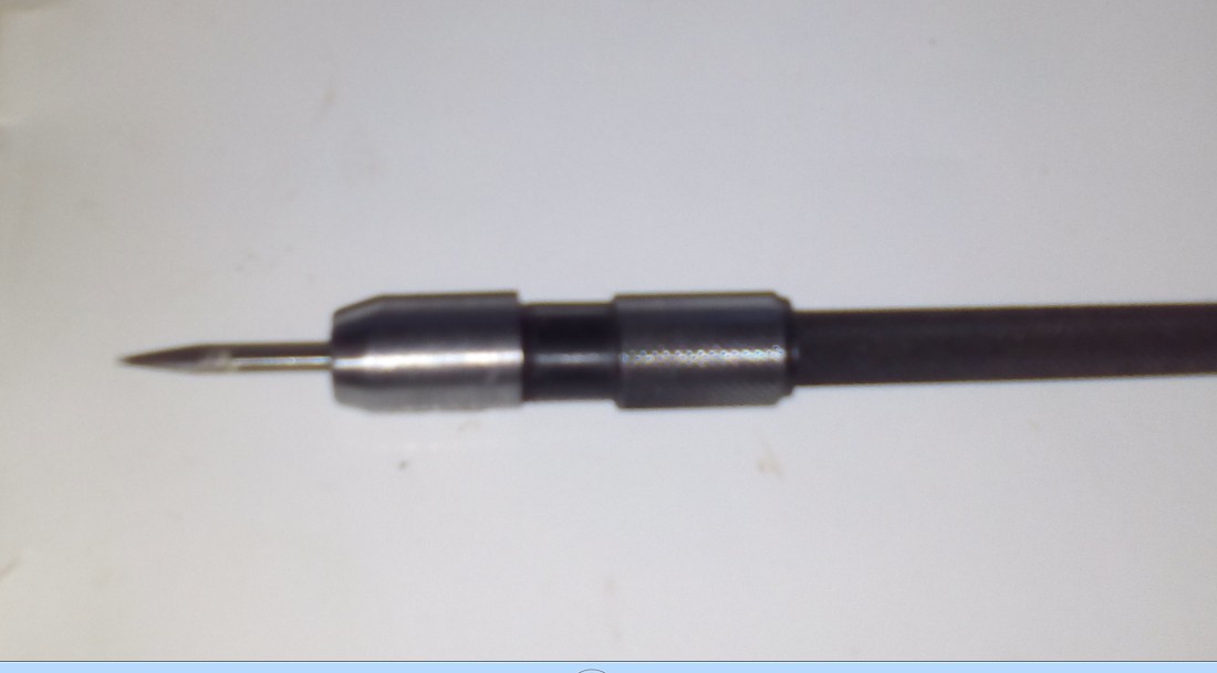

No need to bore it out, it already isAre you going to drill out the shaft of the pin vice to take longer tungstens
What about drilling a hole to a certain depth somewhere on the tool to act as a setting gauge.
Insert tungsten till it bottoms out, slide on pin vice and tighten, remove tungsten and pin vice and transfer it to the grinding hole.
